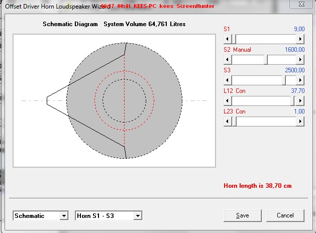

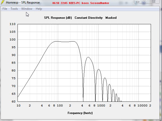

Hi Patric
I have a idea to make a synergy horn who can go together with a tapped horn who is ready to build now.
I have 4 visaton wsp26 s bass 10 inch, and it work very well IF I am right.
Do you now a good learncourse about this horns? I am amp man, but want also learn some about horns.
I have seen that finding a back closed mid loudspeaker is not easy, I have then get a open one and make a little enclosure behind the mid as replacement for the closed one,
the viston mid who was closed has high qts because of the small enclosure formed.
I did see that for bas there are two holes per speaker but one hole is open to the back is this needed for use the back energy of the woofer?.
thanks
kees
