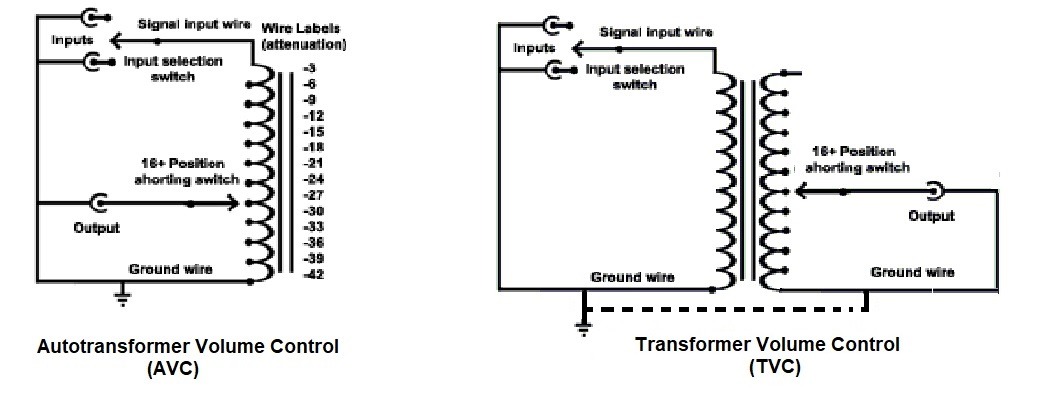

In theory, AVCs (and TVCs) work as signal attenuators as well as impedance transformers btn source and load.
They multiply the load impedance that reflects back on the source.

What do AVC and TVC stand for? I'm pretty remedial in my acronym knowledge.And you may be right.

...used as volume (the V) controls. Got it.autoformer vs transformer
is well consolidate 10years at last ...that the AVC , the Slage ones , is the best pot we can use...From an audibility standpoint either approach can work well.
