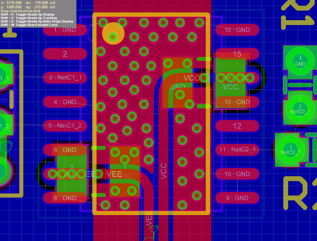

Thorsten,
What can you suggest on opamp decoupling on I/V conversion?
I have AD844s in WSOIC16 package, and it is problematic on decoupling - i can't throw the usual scheme of 1.5n NP0 under the chip + 4.7-10uF electrolytic under the board, as i did here
http://s3t.it/data/uploads/xo3v4ts.png
Attached is my option of bypassing - caps are on the opposite side of the board, and sit right under supply pads of opamp, connected with 4 vias/each.
The rail voltage first passes thru bypass cap's pad, and then, thru 4 vias goes directly to the opamp.
Maybe i can squeeze some TL431s in SMT package, i need to check the power consumption of AD844 first...

[...]So I'd have the TL431 with around 150 milliOhm Z-Out bypassed by 2,200uF with 66 milliOhm ESR (@ ~ 100KHz), which is bypassed with 470uF with 15 milliohm ESR (@ ~ 300KHz) which is then bypassed by 20uF Ceramic with around 5 milliohm ESR (@ ~ 1MHz) and the 1uF 0603 ceramic with around 30 milliohm (@ ~ 15MHz)...
This level of decoupling/bypassing may seem mad, but it makes sure I have a very low impedance from DC into the 50MHz range. [...]
You have to be very careful using such an array of multiple caps for decoupling.
Everyone interested in this topic should look up the great work of MrJam here.
You can clearly see that there are combinations which will resonate due to their intrinsic inductivity or the indictivity of the traces connecting them.
JosephK also made some great measurements explaining the issues of paralleling caps.
Hence I was quite specific on what I actually used and showed how it is arranged... The cap's with the lowest impedance and highest resonance are closest to the IC. Working our way outwards each subsequent capacitor has higher ESR, meaning it acts primarily as snubber and minimises resonances.
I agree, you cannot just throw capacitors together willy-nilly.
