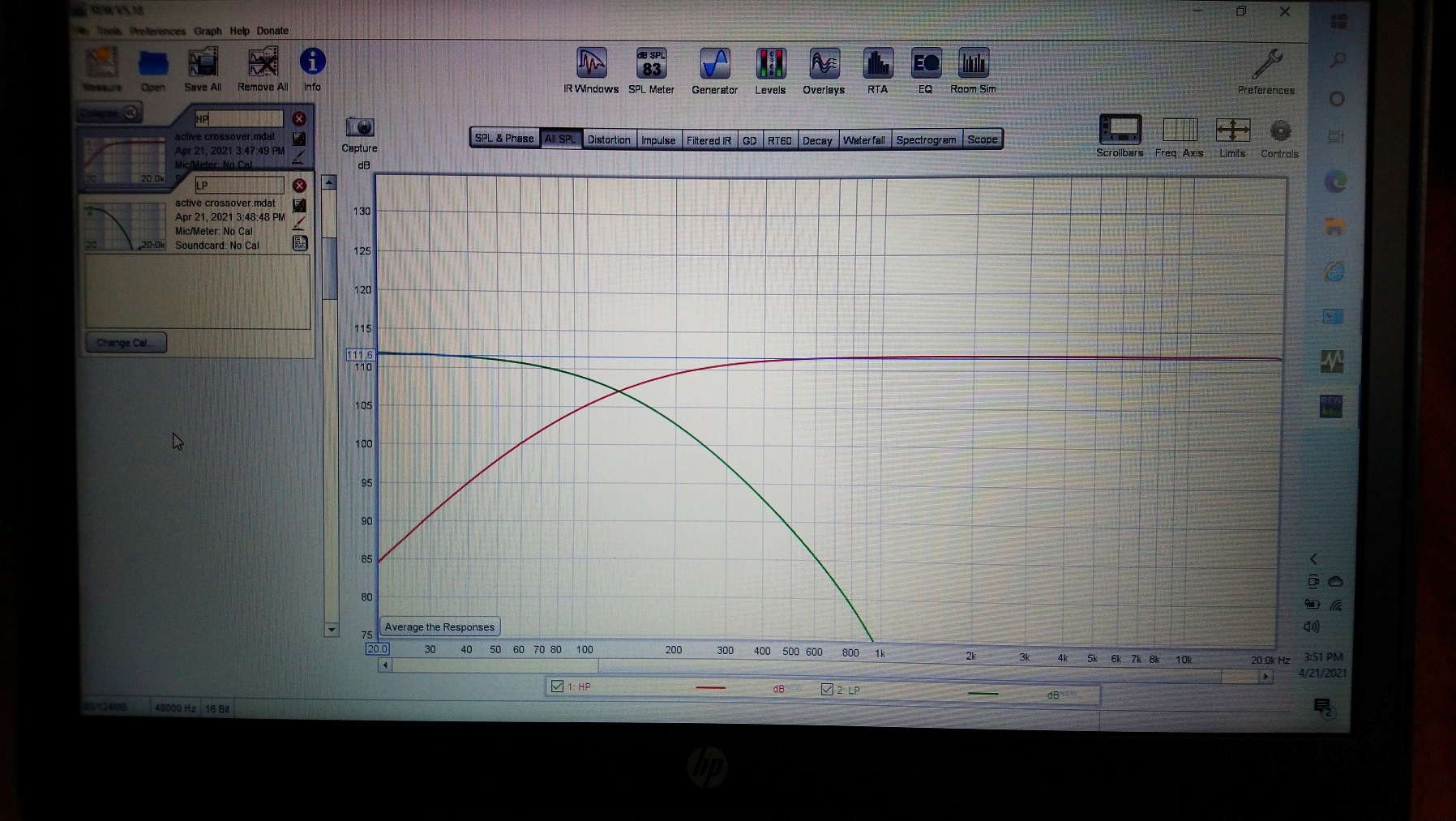

If you refer to post #62 of that thread: what is passive about it? The lower section is a second-order Sallen and Key active low-pass filter and the upper section essentially doesn't filter.
If it does not filter for you, do not use it.
Ignore my post then.
I guess my fr response requested by X is nothing.
Yes, lower path is active.
You can't please everyone, certainly not you.

Unless I'm misinterpretating something, the upper path has 0.1 second time constants, so it's a 1.59 Hz subsonic filter. For the record, I have nothing against Sallen and Key filters.

Actual response...its 150Hz exactly. Not sure about your equation, but mine is in the schematics. 1Mohm is just to discharge output cap to prevent thump, followed by 10kHz or similar volume pot in power amp.
First high path is 6dB/oct, second close to it.
