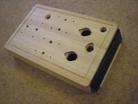

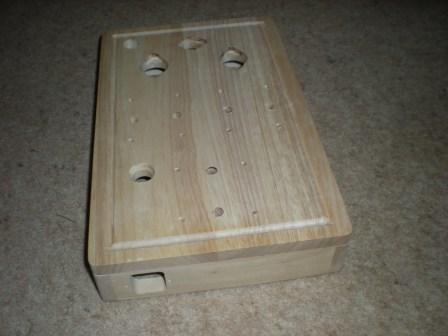

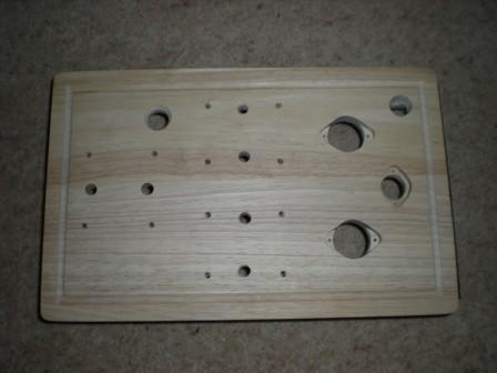

Just thought I would show a shot of the chassis with the front plate not fixed yet!🙂
Still a lot of work to do!
Just for interest notice no holes around the tubes.
There is a 3mm gap around the ceramic tube bases when mounted.
Regards
M. Gregg

Looks very nice. 🙂Just for interest notice no holes around the tubes.
How do you plan on getting the heat from cathode resistors and whatnot out from under the chassis? I would expect there will be toasting hot down there with an all wood chassis, unless you have something sneaky up your sleeve.
- Frank.

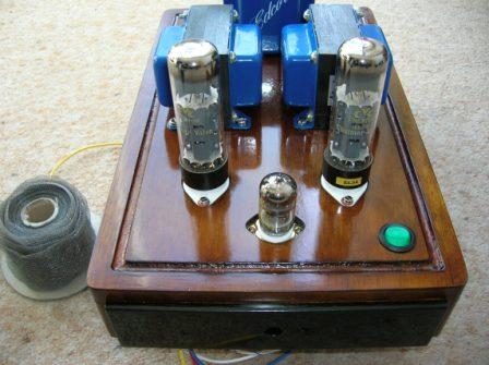

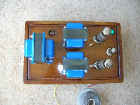

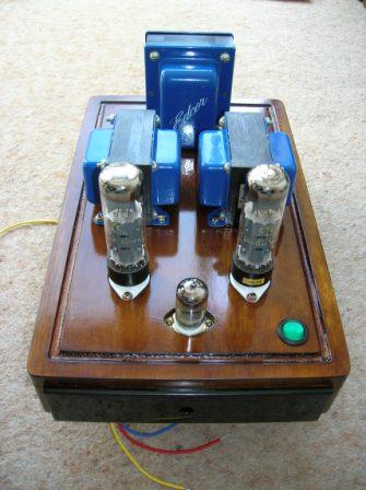

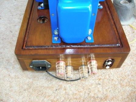

Just some more progress,
A bit slow due to hectic schedule at work!
Tube sockets are mounted on silicone washers.
The finish was a moment of madness French Polish.
Still a lot to do!
The chassis is screened with EMI tape and foil.
due to the input being single L&R phono these are Rhodium.
(Looked for unobtainium could not find any).
Base is aluminium checker plate!
All Tx's are mounted on silicone pads.
Speaker terminals are gold plated red copper.
