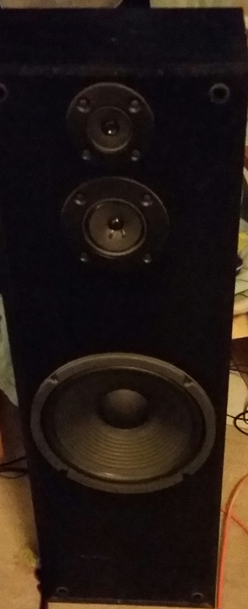

I grabbed a cheap and cheerful set of old sealed Sony 3 ways as a housewarming gift for a friend (along with an old marantz receiver they'll offer a huge improvement over the inbuilt tv sound) but after a brief listening session curiosity got the better of me so I opened them up for a closer inspection and well, they're poor to say the least.

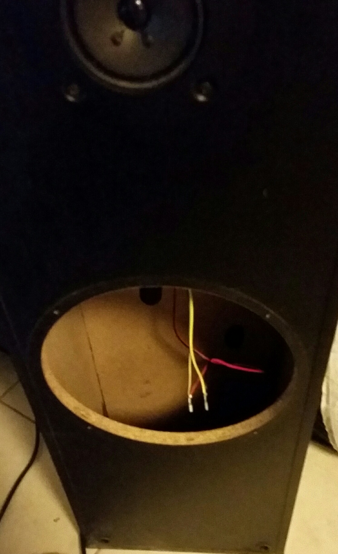

Zero foam/fill, tiny magnets, minimal bracing, closed back midrange and tweeter cones etc etc The woofer appears to run fullrange and the other drivers simply have a cap on them.
I have a few ideas that I can implement with nothing other than some labour so I'd love to hear any suggestions for improving these?

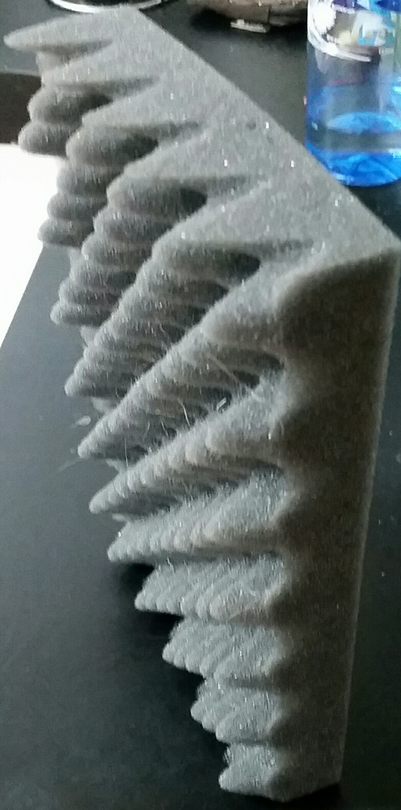

I have an unlimited supply of the foam and am considering placing a lot of it behind the 10" woofer?
For additional bracing I have some broom handles that would fit the bill nicely?
Getting more complicated I have some small tang bands that fit into the midrange hole but that might open up a massive can of crossover woes?
What about making the enclosure aperiodic with a well stuffed hole?

The foam helps as does a good bit of fibreglass stuffing
Some glue and corner blocking, bracing etc, slightly better caps on the tweeters but after that they will still be Cheap & Cheerful speakers, although there is nothing wrong with that.

Foam is a very good start glued or stapled to the walls
Oooh, interesting ideas, thanks for the feedback mate. You have any pics or other inspiration? They are indeed cheap and cheerful, for $25 they're very good value, they make quite a reasonable sound compared to much more expensive smaller junk.
It's good to know about the foam, what's a suitable glue for that? I have PVA and I think some adhesive spray but I know some foams love to melt with the wrong adhesive (I'm looking at you polystyrene) Given I have heaps of it would you think putting an additional layer would offer much?

You shouldn't really get more than 1k, maybe 2kHz at the most from a 10" driver. There is probably a hole just above this region, and it probably has a peak in it from the woofer cone breakup.
I might fit the little 3" tang band I have in and see what happens? But for that to work well I'd need a pretty pricey inductor?
Edit and trying to bodge some chamfering (No routers here) to the chipboard enclosure to let the TB breath.

So I think we're looking at stuffing with foam, cone doping (forgot about that one thank you phivates), upgrading the caps (local suggestions? would jaycar have these?) and bracing the cabs.
I might also replace the wiring as I have some higher gauge stuff around. Again as I have lots of this foam I might shape some around the front of the tweeter and midrange too, el cheapo diffraction be gone?

What you have is two tweeters, so unless you swap in a true mid and crossover you'll have to live with the 10" mid-woofer. Like pro sound! Cheap and cheerful!!
I would look at broomstick bracing the woofer mounting holes to the back of the box, so that skimpy front baffle is relieved of the vibration somewhat. The upper two anyway.

So the broom stick bracing, you mean 4 pieces to cover each screw hole? That's interesting.
For cheap, you can glue the 1" edge of a 1x2 (longest you can fit in the box) onto the side and back panels, vertically (the long way) just off center. The front to back braces near the woofer are a good idea. Any film cap (even mylar) will be better than electrolytics.
Lining or stuffing the box will help a lot, but keep it from touching the woofer or blocking the basket cutouts.
These boxes may be quite sensitive, see if you can find the specs. Rather than putting in a "midrange" it would be easier to just add a fullrange to the box and cross it in at 500Hz or so.
