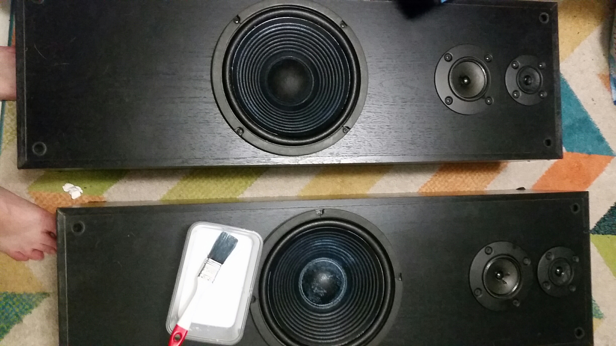

The speakers aren't for me but a friend and his family. They'll be getting used for general tv/music/movies/gaming. My friend already has a good dedicated set up for more serious listening so this is just for casual use. They already sound better than the tv alone obviously but a few mods to up the ante without dipping too deep in my pockets will be cool.
Yes I have my doubts about purely using foam, I might grab a couple of cheap pillows to use behind the woofers.

50/50 (ish) pva/water applied! I touched on the foam surrounds quite a bit (there was wine involved) hope this won't be detrimental?

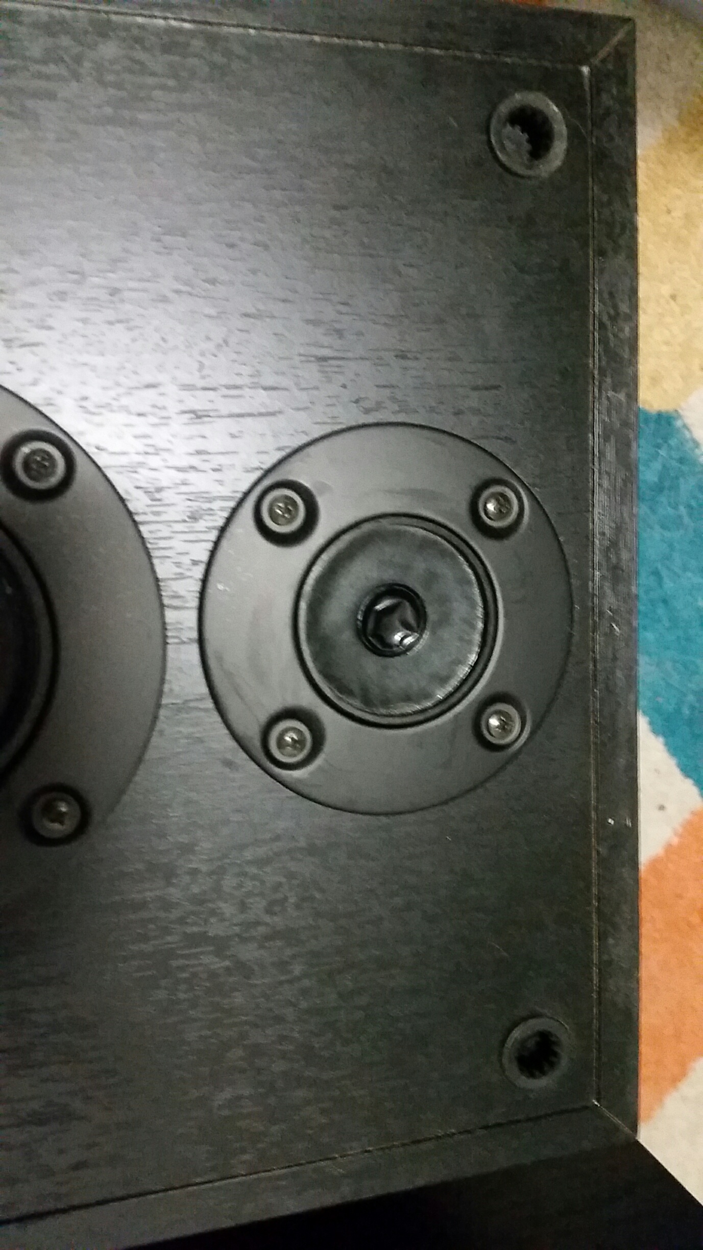

One tweeter looks a little worse for wear, not just the dust cap but the cone itself. We'll see how they go, I didn't notice any tonal difference between left and right when playing.
Also found some of the speaker specs, seems it's rated at 88db, the tang band I have is 86db. I wonder if the woofer will drop down a little now that it's been treated?

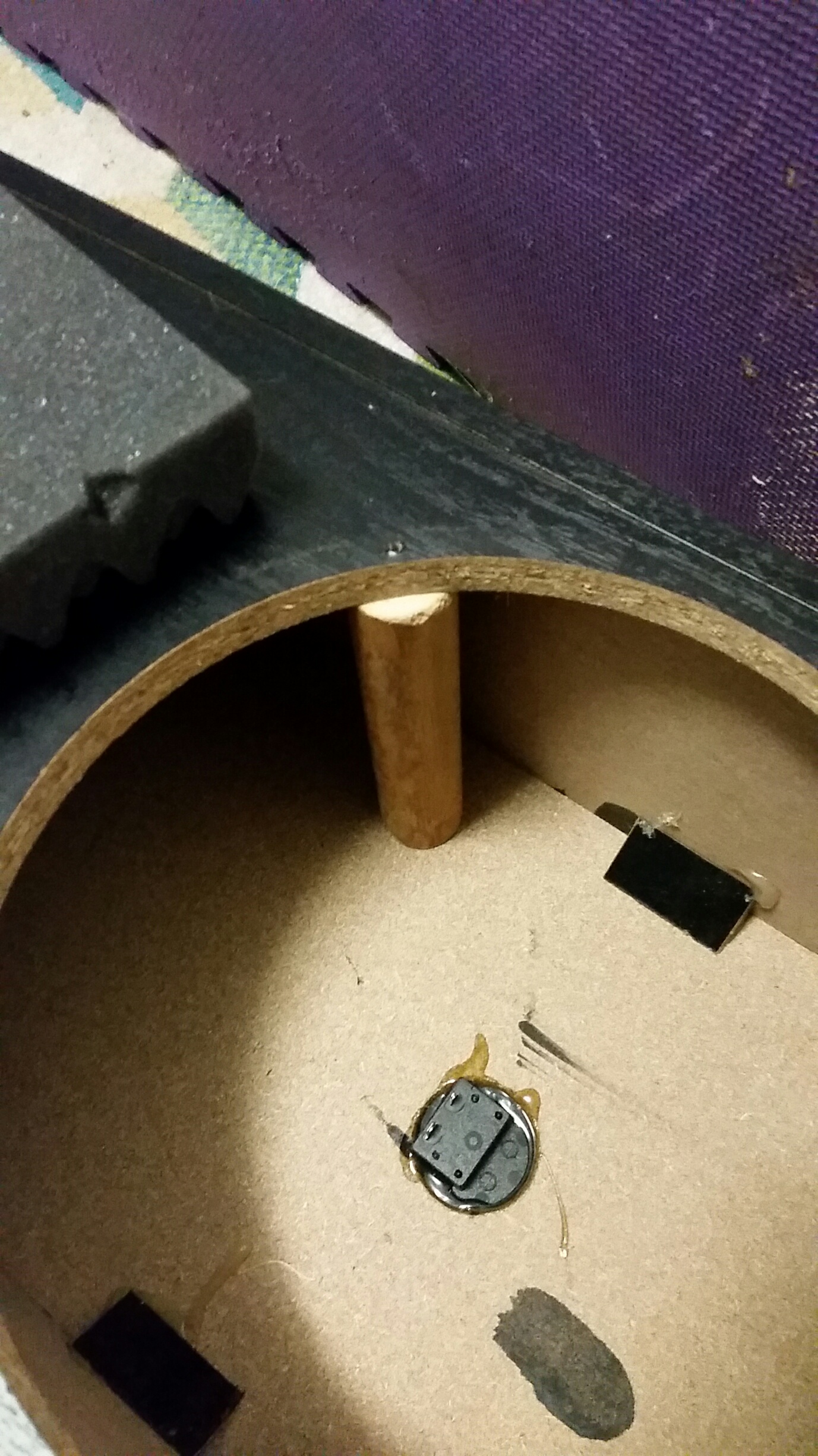

Unfortune box geometry. Can you couple the woofer magnet to the back panel? Foam that recoils is not useful. Use fiberglass. Tap the panels to listen for resonance and glue cross braces over any sides that drum, especially directly behind the woofer. A choke on the woofer kills nasty high frequency cone resonances. Pads (resistors) on the mid and high bring them down where the woofer lives. Mids should have a choke too. There are free analyzers for your PC that are useful for such balancing. Even a cheap electrit mic is probably good enough. Imperfect accuracy is better than a shooting in the dark. Don't worry about not having an anechoic chamber because that's not where you listen to music. Ideally, you would measure the woofer T/S parameters and build a new box accordingly.

I think some bracing next and the woofer will be my main focus. I might look at one piece of broom handle from the magnet to the back of the cab, be a lot quicker than setting up for each screw hole.

Well I've listened to one of the speakers after the pva treatment and it certainly seems less sibilant and perhaps a little clearer too, it's still coloured obviously but it's better than it was. A worthwhile mod.
The bracing is next and I was only able to cut and sand a few of these before swmbo told me it was too late for power tools but they'll be a nice snug fit. I'll go with the method mentioned earlier and put one under each woofer screw.
Would you guys try screwing it into the back wall too or is the glue enough?
