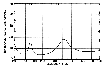

Indigent Audio, I have seen no documentation that states what the actual impedance of either driver in those Image 2B speakers was and believe me, I have looked hard for it. It's only the loudspeaker itself that has a 'Nominal" impedance rating of 6 ohms. It also has a minimum impedance rating of 4 ohms. The nominal impedance rating does not mean the drivers in the speaker are both rated at 6 ohms impedance. It only means that for the majority of the useful frequency range, the speaker has an impedance of 6 or more ohms. It's a rather meaningless statistic and it doesn't mean that the drivers themselves are rated at 6 ohms.
When you look at the overall impedance of a speaker at any given frequency, that impedance includes not only the impedance of the drivers, it also includes the impedance of the crossover too. Below is the impedance curve for the Image 2B speaker
You can see that at 40 - 50 Hz and from 150 - 200 Hz, the impedance is about 4 - 5 ohms. That impedance includes the impedance of the woofer and the portion of the crossover that feeds the woofer. The curve implies the impedance of the woofer is probably 4-ohms. It doesn't suggest 6 ohms at all for the woofer.
If you look at the impedance in the 5 KHz - 20 KHz range, you can see it's about 7 ohms and by 20 Khz it has slowly increased to 8-ohms. For that part of the crossover, there are likely 2 capacitors, 1 or maybe 2 inductors and likely a 3.3 ohm resistor. That will all add a fair bit of extra inductance to the tweeter circuit so it's quite possible and maybe even likely that the impedance contributed by the tweeter is only 4-ish ohms and the remaining few ohms in that range is due to the various components in the tweeter circuit.

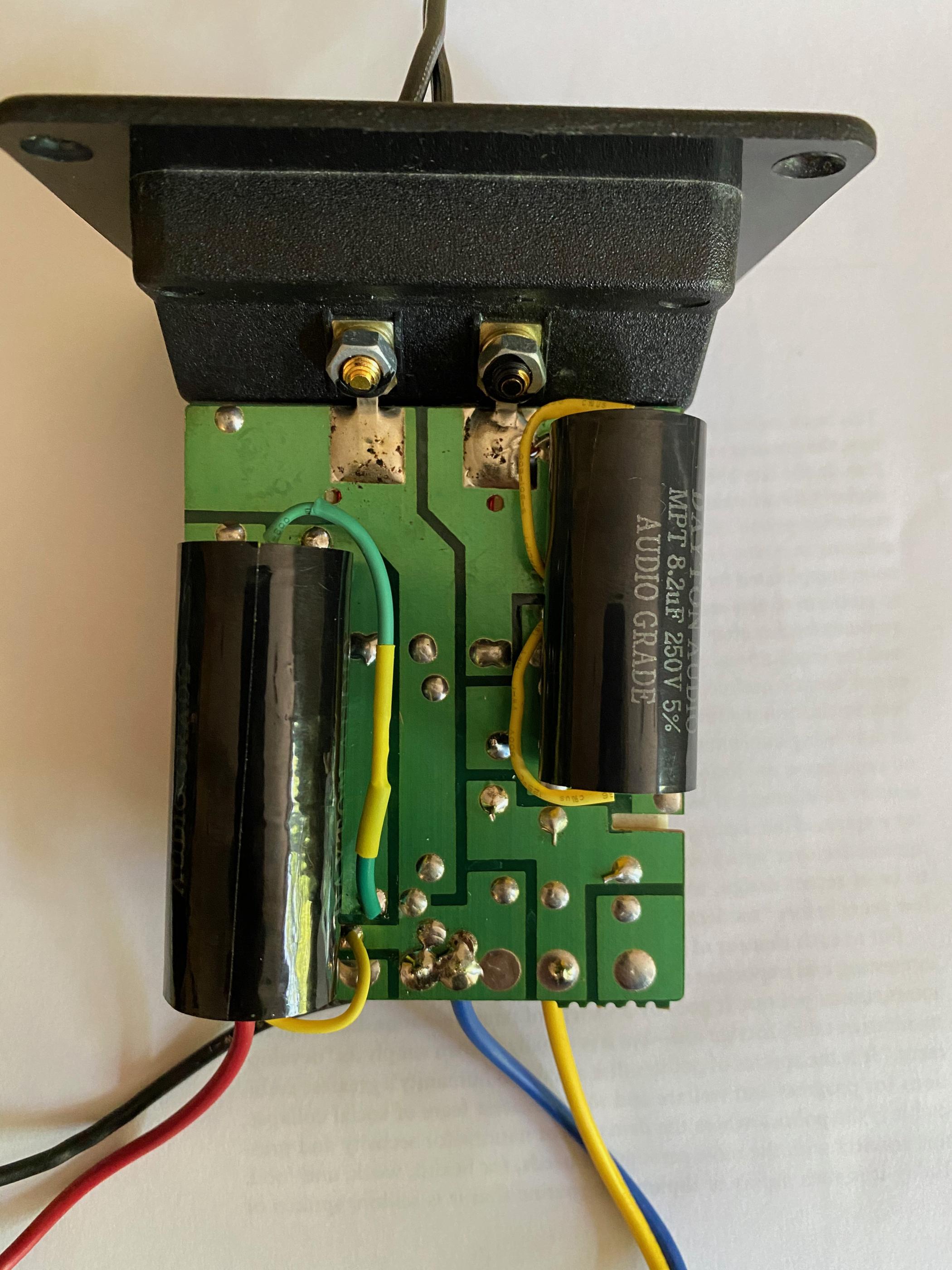

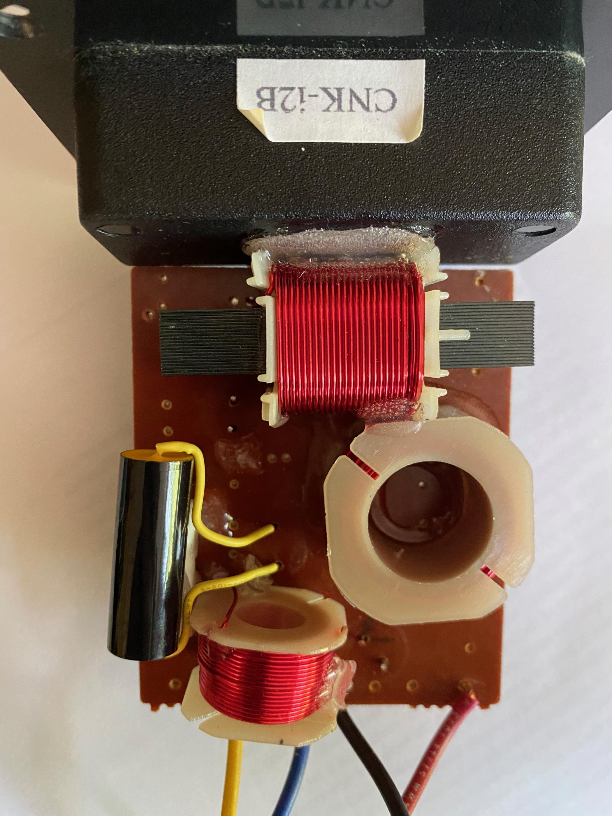

Finally, I've gotten around to installing the new capacitors on my spare crossover! Job and family life have kept me from completing this project for quite a while now...
I haven't boxed it up to do a comparison of speakers with the old/new crossovers though, because I'm debugging. There's a low hiss - a bit like the sound of holding a seashell to your ear - in the woofer and quiet, but obvious hiss in the tweeter too. Neither vary with volume on my amp, and the stock crossover (and the other speaker) are both dead silent. I'm convinced the issue was introduced by the recapping project.
I think it could be bad caps from Parts Express (seems unlikely, but I don't have the equipment to test), issues with the small differences in part values, or maybe I need to shield some of long leads on the 1.5uf cap that's near the crossover's inductors.
I can probably find a way to shield the leads, so I think that's where I'll start. If need be, I could definitely put that cap on the underside of the PCB too.

That's odd that would happen after that modification. That crossover you modified was a different unit than the original one that was in the speaker, correct? If so, did you test it before modifying it? If not, it might be that it had that problem before you made the modifications.
If you look at the pictures I provided you'll see I protected that one capacitor lead on the 1.5 uF cap that goes near that inductor coil with heat shrink which I just left on loose over the lead. It looks like you've shielded both leads on that cap with wire insulation which should be sufficient.
I think the job you did of insulating the leads on all the capacitors is excellent and better than the job I did. Yet I didn't end up with the hiss you did which baffles me unless that crossover had the problem to begin with. I bet that if you made those same mods to one of your crossovers that tests good before modification you will get the desired results.

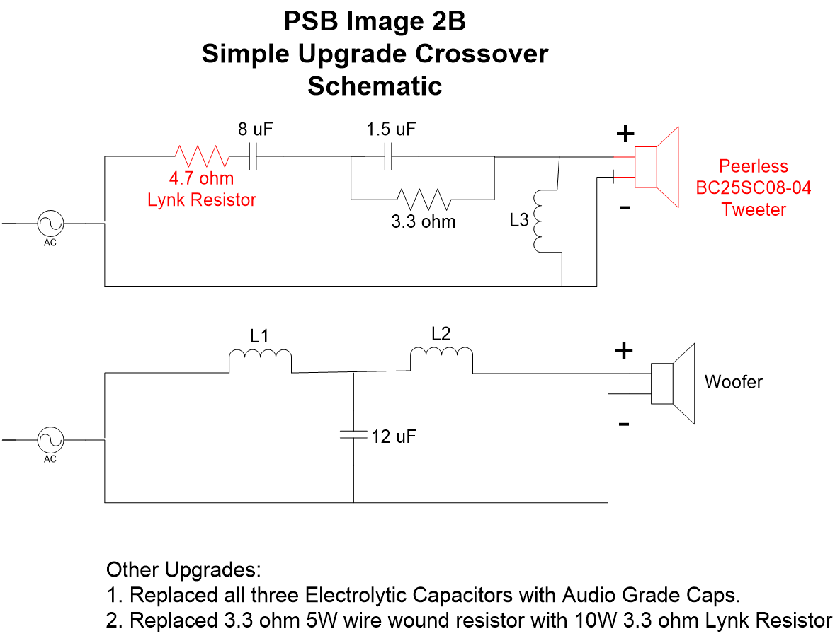

I've made more modifications/upgrades to the PSB Image 2B speakers. I replaced the stock PSB/Vifa tweeter with a Peerless BC25SC08-04 (4 ohm) tweeter. The tweeters made a VERY noticeable improvement over and in top of the VERY noticeable improvement that was made by replacing the electrolytic caps in the PSB Image 2B XO with audio grade caps. I'm very pleased with the difference the tweeter upgrade made and very, VERY pleased with the improvements both upgrades have made together.
I first started with just swapping the stock PSB/Vifa tweeter for the Peerless BC25SC08-04 (4 ohm) tweeter with no other changes being made to the XO. I did the swap on one speaker and left the other one with the old tweeter and then listened to both carefully to hear the differences.
I could hear right off that the Peerless sounded much more clear, crisp and airy. Much more detail in the high end and clearer mids than the stock tweeter. The stock tweeter sounded a bit muffled in comparison, especially in the female vocals. With the Peerless having much higher sensitivity than the original tweeter, it needed to be "pulled back" a little to keep it in balance with the woofer so I needed to add a resistor ahead of and in series with the tweeter circuit.
On a suggestion made by @Lozjek on a different thread where he made some calculations based on the crossover schematic and the stock response curve for the speaker and the response data for the Peerless replacement tweeter, I tried a 4.7 Ohm resistor ahead of the tweeter circuit for the first trial. I could've added some smaller resistors to tone the tweeter down a bit more or put in smaller resistors to kick it up a bit with the extra resistors I ordered but I decided to leave it at 4.7 ohm and be done with it.
I don't have test equipment or a well trained ear but I thought that the tweeter seemed in good balance with the woofer with 4.7 ohms added. It definitely didn't need to be made any brighter by reducing the resistance ahead of the circuit and I couldn't imagine the sound could be improved by subduing the tweeter further with added resistance so I just left well and good enough alone and went with the 4.7. I still have the other resistors I bought so I can always change it later on if I ever get access to some test equipment to give those speakers a proper response test.
Attached is the final schematic for the upgraded PSB Image 2B crossovers. The red components are what were added in the tweeter upgrade. While I was adding the 4.7 Ohm Lynx resistor to the tweeter circuit I also replaced the original 5W 3.3 Ohm wire wound resistor with a 10W 3.3 ohm Lynx resistor.
Aside from deadening the cabinets (which I intend to do still) the only other simple upgrade that's possible would be to upgrade the Inductors to better ones, especially I1 which is a laminated iron core inductor. Unfortunately, the Inductances of the three inductors are not marked or known and I lack the knowledge and equipment necessary to measure the inductance of the inductors.
A warm heartfelt thanks goes out to @Lozjek and others who contributed to the other thread and helped me figure out which of the two upgrade tweeter options I should go with. I'm very pleased with the improvements I was able to make to those speakers on a low budget. :cheers:

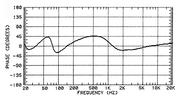

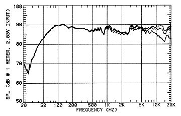

PSB Image 2B specifications:
Nominal impedance: 6Ω, minimum 4Ω at 140-200 Hz
Sensitivity: 89dB (2.83V/1m, also W/m ?) (SoundStage! measurement graph indicates 87.5dB averaged 300Hz - 3kHz, 2.83V/1m
