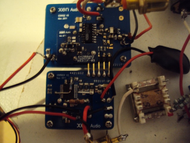

I got Euvl´s ES9022 board and had some listen. The sound is very wide band with very good extension in the bass and good extension in the treble. Tonal balance is neutral, this is no smoothed over candy sound and no fake "magic". Image focus is outstanding, so is depth perspective so micro detailing must be very good. What really surprised me is the bass performance especially considering that i used simple 9V blocks to supply it and there are no huge capacitors or regulators on this tiny boards. It goes as deep as i heard it, has slam and power and is precisely structured and rhythmic. After i had digested the first shock i was able to find small remaining problems, namely a little more artifice and less liquidity and naturalness then my 30.000,-€ Forsell rig. This are minor problems and may be solved by buffering the output. The Forsell also has one of my time domain buffers at the output. The Forsell alone without my buffer has a rather soft treble and compared to that the Euvl board is a huge bargain. I call that progress.
Thank you Joachim for the feedback.
We also agree that some form of LP filter like a discrete JFET Sallen Key filter at the output may improve the smoothness slightly.
But these are all very personal.
Glad you like our work.
FYI, Joachim had a ES9022-48MHz module with frequency divider to feed 12MHz to the WM8804 module with the same XO.
The two modules had 4x LT1761 regulators on board, close to the ICs. Identical to the one on the right in Post #219.
Patrick

A new batch of modules ready to go to their new owners.
On the left a standard asynchronous ES9022-50MHz with I2S input.
On the right a WM8804 SPDIF Receiver module, followed by a ES9022-48MHz, with the 1:4 frequency divider which feeds 12MHz to the WM8804 from the same XO as the DAC.
We got tired of etching PCBs, so we have some made for the ES9022.
The next batch of WM8804 will also get factory made PCBs.
Patrick

I would certainly not use an output transformer. It is expensive and clumsy so why make this very small to begin with ?
I have made good experiences with inductive filtering though. The inductor is in series with the signal and i found that more effective then putting a cap to ground that is parallel to the signal. I think it has to do with HF not letting go into the amplification chain. I am certainly not a fan of non oversampled DACs with a lot of aliasing noise.
That inductor is very small. I will make a photo with EUVLs board as size comparison.
