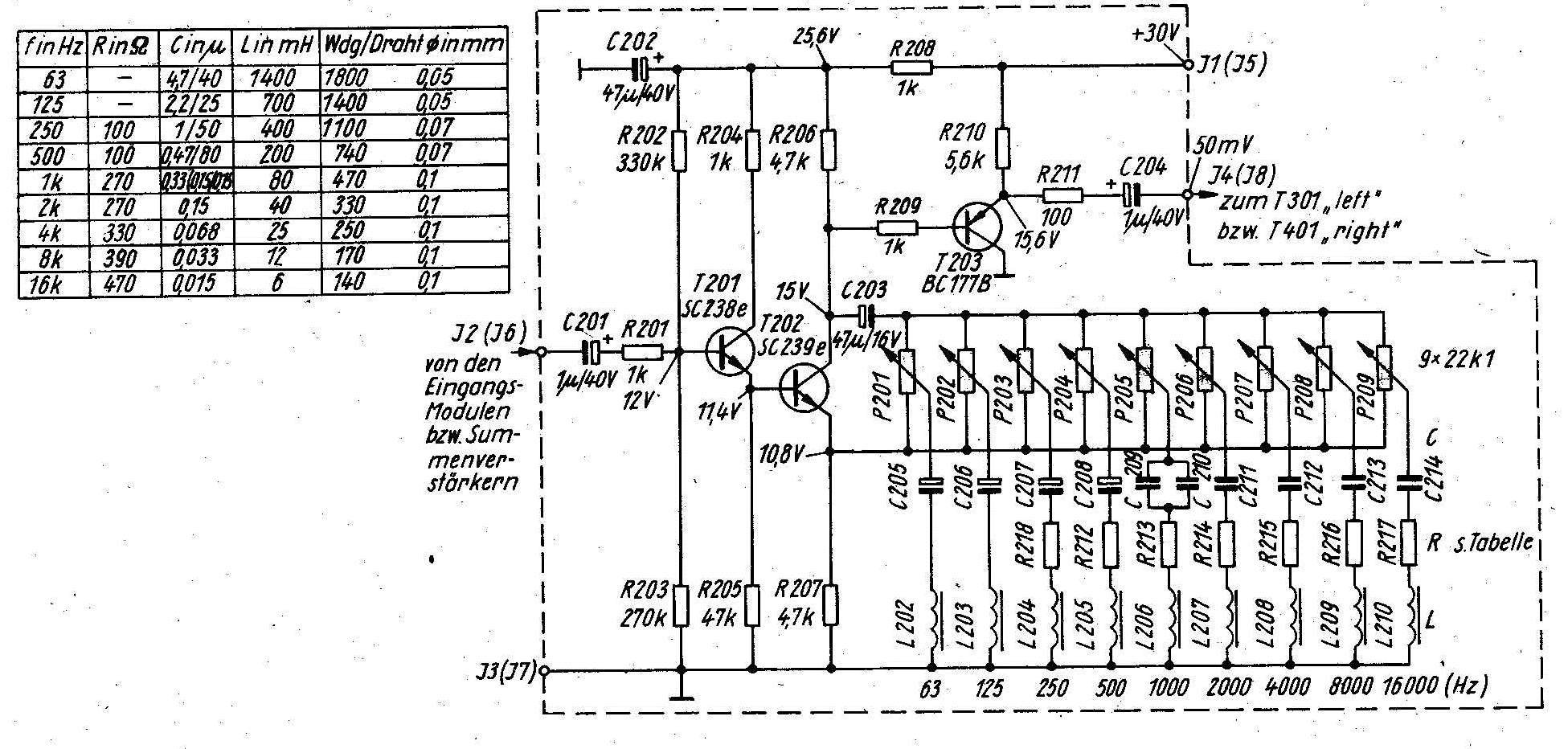

I am also considering the merits of an analogue EQ (vs DSP) and one idea I came across which interested me is based on a very simple topology but requires inductors (which may be hard to source if you can't make them). See attached - there's a thread somewhere which claims this is a well regarded approach and is known as the 'East German EQ', and takes this concept a bit further, suggesting the use of an op-amp based gyrator to replace the large inductors. this approach is OT for this thread though.
Check out JVC SEA-22. Schematics looks similar, simple, but no inductors.
