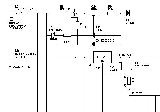

the SuperReg is a PD regulator. This means the regulating loop has not only a proportional but also a differentiating component. This differntiating is achieved by C6. C6 shorts R1 for high frequencies.
R1 and R2 (which is a pot) are the sensing voltage devider, R1 is connected to the HV rail. So for slow HV voltage changes the error amplifier sees the fraction of the HV voltage change determined by the sensing voltage devider R1/R2. For fast HV voltage changes the error amplifier sees 100% of the HV voltage change. My recommendation (from theory of course) would be to look very carefully at the size of C6, experiment with it, keep it as small as even possible. Measure performance and listen to it, too. It may be most pleasing under certain circumstances if C6 is missing at all. Oh, and if you use it, it is vital you use caps with outstanding sonics. Not something crappy, no Wima MKP10 or the like.
So,
as you have probably read between the lines, i am not using the SuperReg. At the moment i am listening to a Manfred Huber preamp and Manfred uses his own shunt regulator design; from own exprerience i can tell it sounds just gorgeous. But my decision not to use Allen desing comes from a conceptional decision, not from a sonical one. The preamp design i intend to build has one shunt reg per stage, makes 6 shunt regs for a 3 stage preamp. Allen's SuperReg needs a very clean external power supply for the error opamp. Does it need one supply for 6 regs or does it need 6 supplies?
My idea is to use 6 regs to eliminate interstage Xtalk and TME, opamps no matter how fancy their CMRR is on the paper, they Xtalk. Yeah, i know, i'm paranoid 🙂, Allen would probably not think 6 supplies are needed.
Manfred's shunt reg design does not need external power for the error amp, it does not even use an opamp, so my insane preamp project becomes a bit less cluttered.
The reg uses a long-tailed pair of BJTs driving a SE BJT driver which drives the shunt device, a FET. This reg also as a PD reg. Equivalent for C6 of Allen's design is C3.
Of course and in alignment what i said above, i am going to get C3 as small as possible. Manfred used 2µ2 and -- as it worked fine on the bench, did not bother further with getting C3 size down.
One thing massively appealing to me is that Manfred's reg has a very small cap (C4) across the output; 2µ2 minimum size allows the use of a coupling-cap-grade foil cap whereas Allens design has an electrolytic of 22µ across the output and he told me that depending on application the needed size can grow up to 100µF and never below 10µF.
And i am a real fan of small caps for power supplies, both AFA physical size and as value is concerned.
So my personal choice is Manfred's design p2p-wired on the terminals of a 5µF or 10µF MKV B25834. Which are sitting on my shelf already.

Simplest one is in the TL431 data sheet. Shunt this with a low esr largish cap, and you can get a 10 uV noise supply with 50 mA and more depending on the p transistor you choose. Pay attention to using a lowish current thru'the TL431.
Emile Sprenger's Shunt reg is there for all to use apparently.
He has a manual, parts list schematic...the works on a website.
http://www.euronet.nl/~aespreng/Shuntregv11d/
I believe it is state of the art as far as shuntregs go...

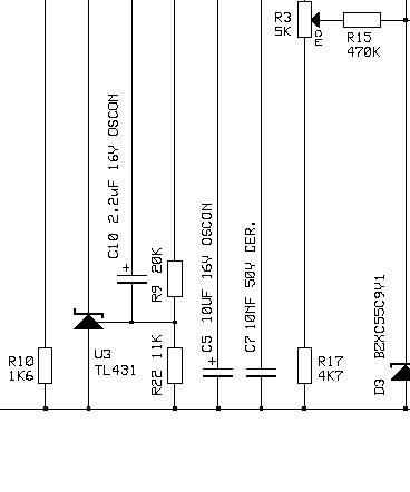

I wonder at the use of LT1085 regulator for the supply for error amp. Why not a shunt regulator it as well with 400 or 500 volts, even a resistor bias shunt element would give very good rejection for the error amp. The current preloading is on the low side and the use of the voltage setting resistors as the current load instead of a separate load resistor causes a real compromise in the PSRR that larger resistors with the same 15 uF cap would give.
Biasing the U3 reference with the adjustment current from LT1085 would be even better and would improve the PSRR and lower the output noise from the LT1085 and lessen parts count.
The current source T2 is regulated and with the TL491 as the error amp. I don't know if this is as good sounding as the IRF810 would be with a more simple source resistor only feedback scheme.
The mosfet T1 current source for the reference error amp U2 needs a gate resistor. A series resistor at the drain of a 1K to 5K resistor would filter RF out from the error amp U2 better.
There is needs to be a RC filter between the voltage reference U3 and the 200 ohm error amp feedback resistor. There is too much noise as the design sits now.
The TL491 is a noisy reference and the noise is not even specified by several manufacturers! (not good, very discouraging) When set for 6.9 volts it is not even as good as the LM329 from one the one vendor I saw who would characterize the noise. The are much better references than either of these now available.
Most of the suggestions on the LT1085 were standard tweaks from the Audio Amateur at least a decade ago and the rational and performance improvements can be verified by reading the applications part of the data sheet. It is a very interesting design with some very clever circuits and uses first rate parts for most of the design. Having a great interest in power supplies for audio I can honestly say that the LT1085 part of the circuit was not state of the art 10 years ago much less now.......
I will save the main error amp stuff for later and there are several suggestions for that as well. It would be interesting to see Andy's (AWL) comments as well.

Re: We're both regulator guys having a nice regulator discussion
Ok, I guess I have to answer this one.
Since yesterday I'm a member of this forum (I had to join in order to reply).
Normally I'm over at the Joelist .. not enough time for 2 lists ..
As for the shuntreg .. it's been a while since I worked on the design .. funny that there;s a discussion on now .. the reg's have been running for over a year now in my preamp .. very, very nice ..
I'm really pleased with the comments made. Some are new, others I realised after the design (maybe something for the next version?)
Let me start by saying that I'm certain improvements can be made .. but .. as the reg is now, it beats anything I've heard so far.
Simple, not so bad regulator .. remember we're not talking about regulating a phono amp (direct signal path), but the error amp of the regulator of a tube amp .. so I chose a simple solution.
No, the 1085 is not a state of the art regulator, but it's so far down from the signal path, I don't think its much of a concern.
The PSRR of the 655 is pretty good as well (65/70dB) .. some room for improvement, nevertheless.
I take it you want to power the opamp from the B+ .. not so good idea due to the large waste (on the regulated side it would never work anyway) IIRC, the error amp draws around 20mA. @ 400-500V that's a lot of power to dissipate. Not the route I would choose. No if you want to improve things, go for a better low V regulator.
I tried higher currents, but could not measure/hear any difference (with a HP spectrum analyzer and >100dB horns), so why raise the current? Even with the substantial Cin of the IRF, the output swing of the opamp is very small, so there's no chance of slewing the output.
Agreed. The voltage ref can certainly be improved (noise). The PSRR is not that bad due to the current source feeding the 431.
Never thougth of that .. smart thinking.
I tried both .. the 431 error amp gave a subjective blacker background (compared to a simple MOSFET/source resistor CCS)
BTW its a TL431 not a TL491
Agreed .. although I haven't had any RF problems with the reg (the separate groundplane for the CCS probably helps).
I thought aboput this one during the design. I chose not to do this due to the introduction of another pole. As the circuit is now, noise is very, very low. With a regulated B+ of 400V there's about 200-300uV of noise ..
All the datasheets I have show 40nV/HZ^-2 .. I've seen better, but it's not as bad as you suggest.
The datasheets list the 329 at 75nV/Hz^-2 .. that's amost 2* the noise of the 431 ..
As I said before, due to the PSRR of the 655, I didn't put too much effort in the lt1085 reg .. I realise that this aspect could be improved ..
However .. will it have any sonic impact?
Yup
As I said before, the LT1085 only being used to power the error amp of the regulator of a tube circuit. Very far removed from the signal ..
Looking forward to hearing more.
