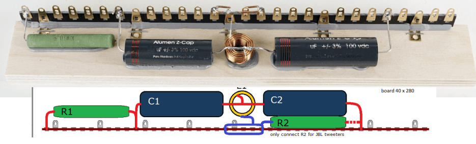

As it turned out, the fellow who assembled the crossovers for me inadvertently followed Gravesen's instructions for the wrong super-tweeter, so the Viawave ribbon tweeter that came with my kit was getting too much attenuation. Once that was corrected, I noticed an immediate improvement.

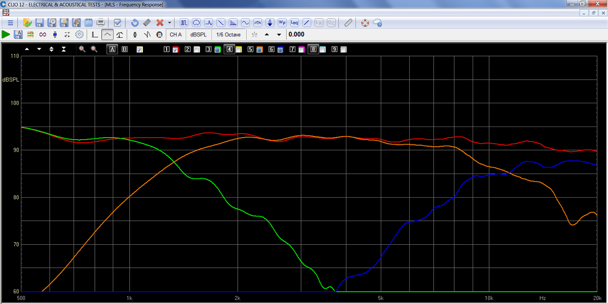

Having said that, from a graph published on his website, it seems that Gravesen designed the TL-1 to be 4-5 dB down at 20 kHz when listening at a typical 3-4 metre distance. I don't quite understand why one would do that, but it is what it is. So, even now, the TL-1 doesn't have quite the vividness in the upper frequencies (most noticeable with cymbals, gongs, bells, etc.) that I enjoy from my other speakers.
Finally, it's also worth mentioning that Gravesen uses the same 18 Sound horn and 1" compression driver in a smaller 3-way system that's also on his website and, in his description of that design, he mentions that the 18 Sound driver/horn outputs to well above 20 kHz, but loses some linearity above 16 kHz (I can't hear beyond 14 kHz due to age). I even asked Gravesen if I could just remove the 9 kHz low-pass on the horn and disconnect/remove the super-tweeter, but he said that with the TL-1 crossover no such quick-n-easy modification was possible—and, understandably, he was not about to start doing a custom design for me!

Tweeter Mod:
If in your shoes I would first see if I can get more listening satisfaction by simply turning up the tweeter a couple db ( I know that my almost 70 year-old ears would welcome this mod ).

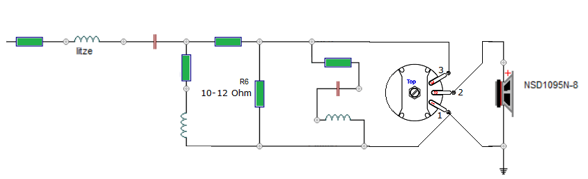

One can do this by paralleling another resistor ( of similar value or greater ) to the existing resistor ( R1, seen at the "amp-side" of the UHF circuit ).
Horn//Driver Mod:
(i) Have you already done Troels recommended mod to get a couple more db to play with ( of adding an variable LPad after substituting a 10-12 ohm resistor for the existing 5.6R resistor found in R6 position ?? )
- This ( & more tweeter level ) may be all you need to do.

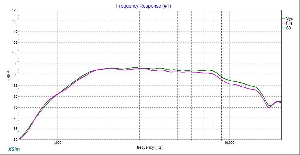

(ii) Levelling out the HF drope,
There's a very gentle downward slope ( Hi-Mids towards HF ) that is now-a-days considered "best-practice" when using constant-directivety horns, but it can be "levelled" at a few places ( here are two examples ).
- A 3.3 uF cap can be paralleled onto R5 for a tiny increase of HF above 8K.
- A 30 ohm resistor can be paralleled onto R3 ( this results in a very moderate increase in db in the overall presence area, say 3-8K )
The two mods combined give an overall increase ( as seen in the following response prediction made by XSim )
- Purple trace is Troels existing Hi-Mid response for the horn//driver combo ( as published ).
- Green trace is that same response with the 2 mods just mentioned.
