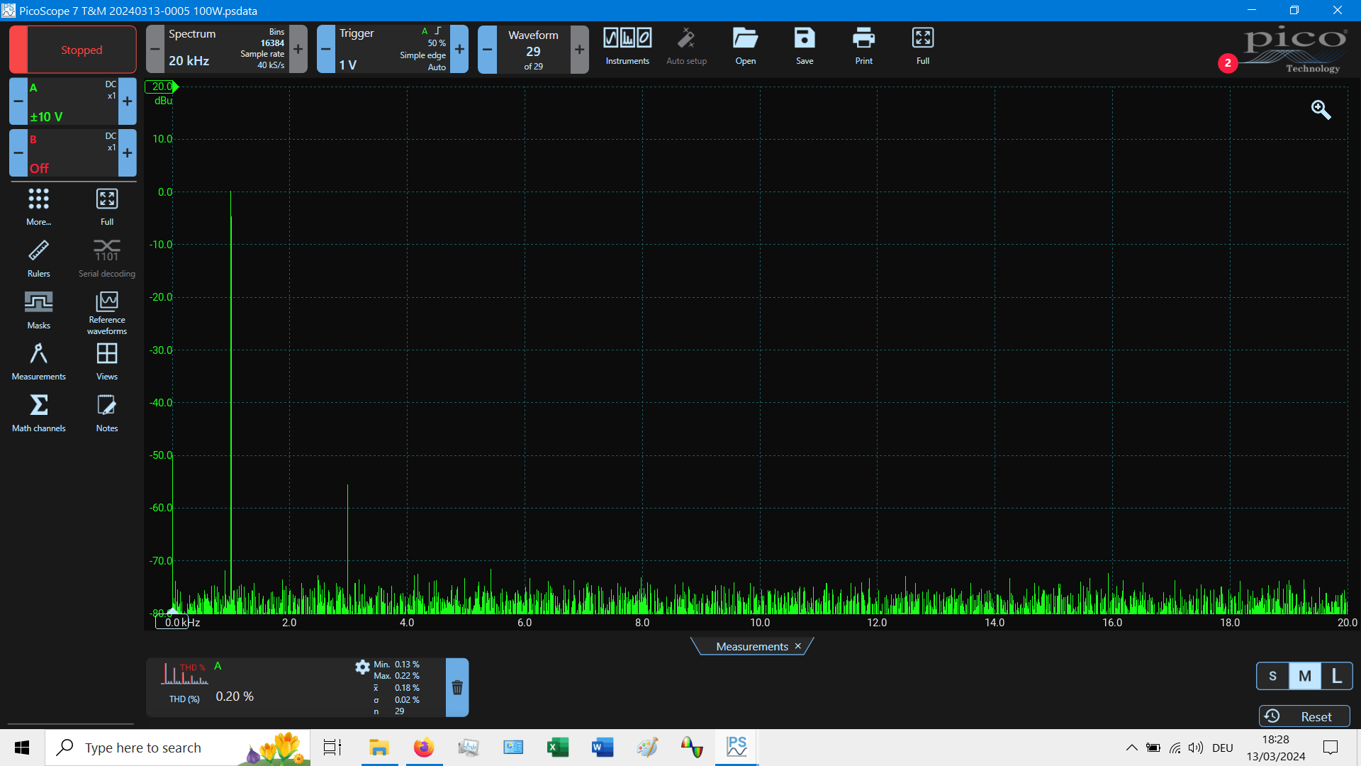

Lets´try these pictures regarding spectrum analysis, upper one a peep at the noise floor but ignoring the LHS side arbitary audio levels.. Note there are no switching 75Khz harmonics f-x on the output at full power. I assumed any signal harmonics created by the HP339A signal source (-100 dB) is so low by comparison with the tube amp, it can be ignored. Tube amp 120W
Next at 100W power level, thd 0.2% as stated on lower left.

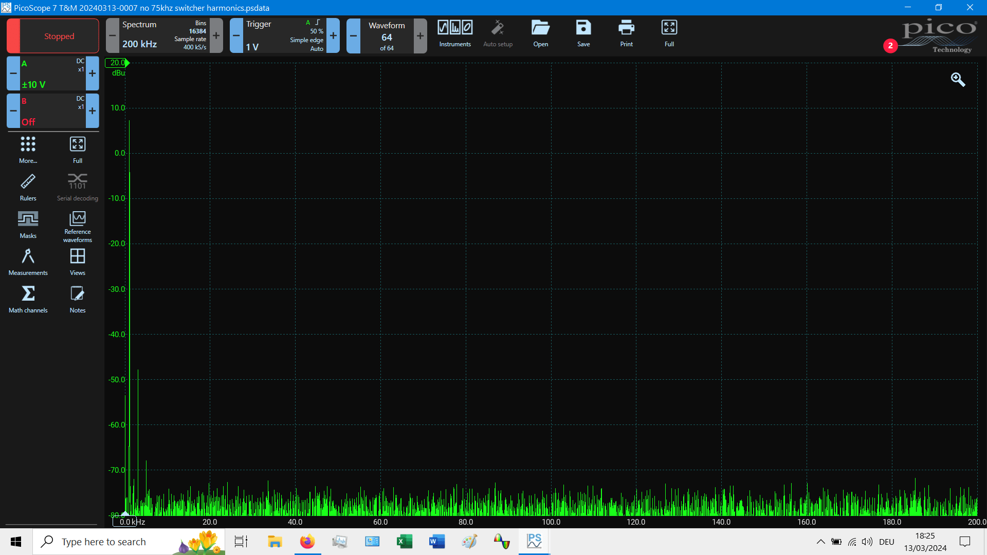

Keep at it, next more on the switcher. This the most dangerous part.

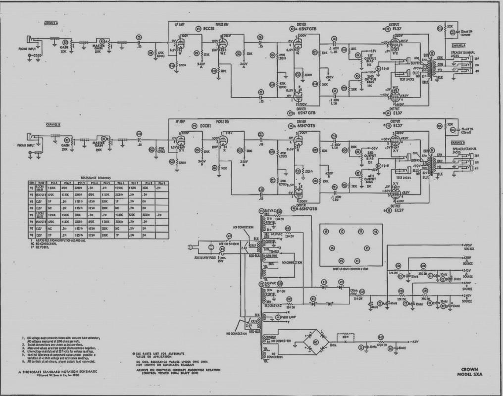

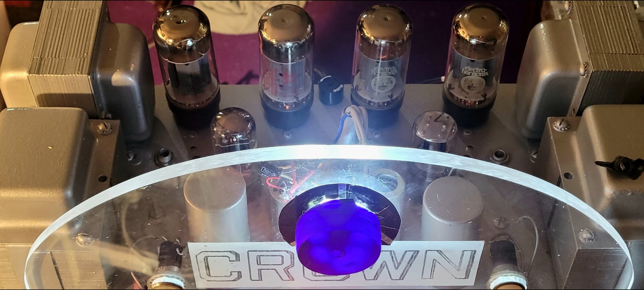

I'm facing a Quandary with a Crown SXA amplifier... they did a lot of cutting of corners to make the thing fit into the small rack mound amp space back in the 50s, but still managed to build a pretty good Tube Amp using EL37s... i've taken the chassis down to the Transformers again. To start over and try and separate the two power supply transformers to create dual mono blocks within the same chassis. The original design saw the 2 power Transformers coupled for the B+. But if i'm going through the trouble of rebuilding it, I would like to have it be discreet and separate topology on both sides. It's not that big of a push, because I believe either the output Transformers will put out 300V AC... but I believe that they want the system to run at 410V DC loaded... and then there's the issues of the preamp tubes and the bias supply. I have no qualms with putting solid state regulator of some sort in there... as long as it was noise free and maybe saved a little bit of space, and of course made it sound nice! Ideally, I'm just trying to find something that will turn that 300V. Ac into usable, dc and ideally be mounted on a single pcb. I have a recording studio here and I also have some speakers that I'm building specifically for this project. Just to have something cool to a/b with my larger speakers. The crown puts out a solid thirty watts per channel... and I imagine that is capable of much higher transients... i've been trying to get an idea of what's out there and what could be built to do this and how complex it would be if I could do it myself or should I just hire somebody to print up a board and populated it myself? Attaching a schematic and a pic of the unit.I don´t like the idea that the HV is dependent on the heater current, it tells me that the regulation is only on the LV output. Swap tubes, i-e heater current and all HV havoc voltage prevails, No! unless after post-regulation is used which would seem a waste.
Regulation seems typical of a switching topology having poor cross-output regulation, and it looks there is no coupled filter inductor used on each switching output. That rules out forward topology. Also, on paper there is no emissions compliance regulation that interference produced could play havoc with nearby radio etc. Switchmodes are designed to run hot to limit core size, power losses roughly 50% ferrite and 50% copper. Running temp on full load 30°C over 25°Cambient isn´t unusual. That implies 55°C to touch, requiring min F or H grade UL listed insulated copper wire.

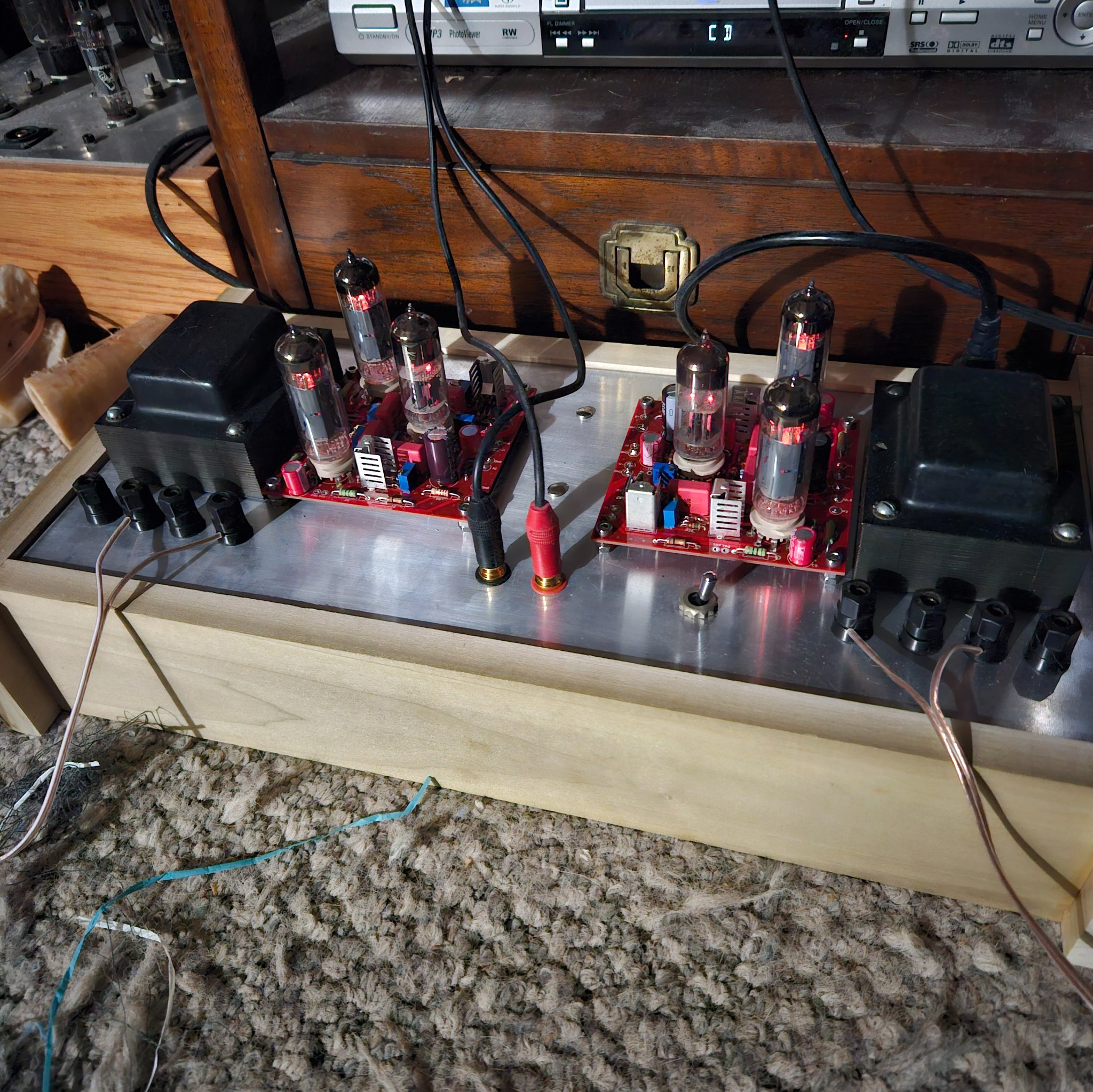

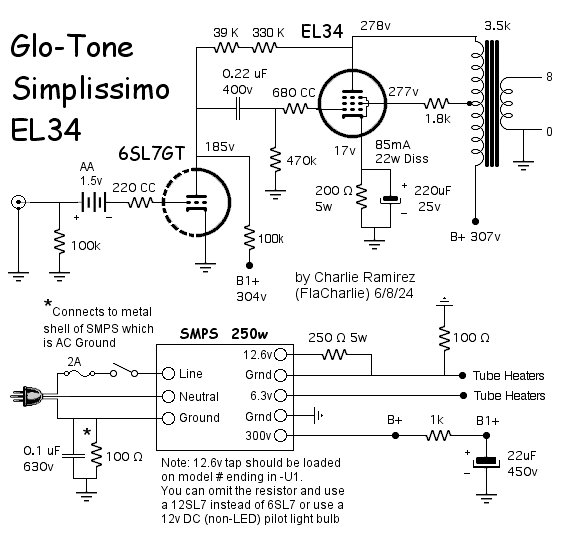

I'm using the same switcher the OP posted for a SEUL EL-34 amp I'm building
The original builder bread boarded this amp and the SMPS doesn't get too hot just mounted on a piece of wood mounted on short stand offs.
I'll be building the amp on a 1/8" thick aluminum plate with thermal grease between the switcher and aluminum chassis.
Here is the schematic below. I had all the tubes, resistors, caps, etc on hand.
The SMPS and OPT's will be here in a few days.
I payed around $40 for the switcher, so I bought a second one and may use it for another project.

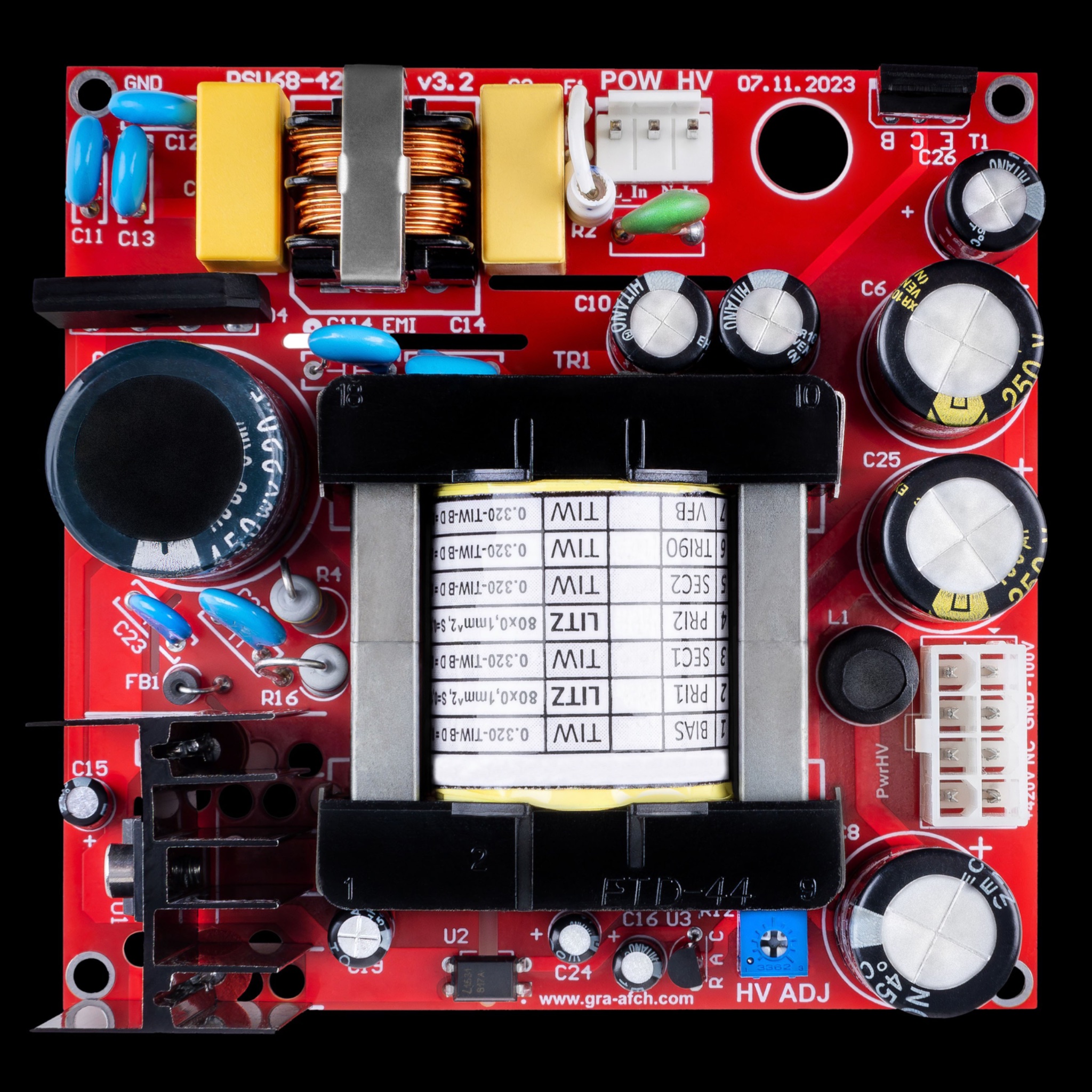

If anyone wants to try it, I spotted this power supply.
PSV68-420/-100 [Dual Voltage] [100-240VAC – +420V/-100V, 68W]
https://gra-afch.com/catalog/power-supplies/power-supply-for-vacuum-tubes-amplifier-psv68-420-100/
