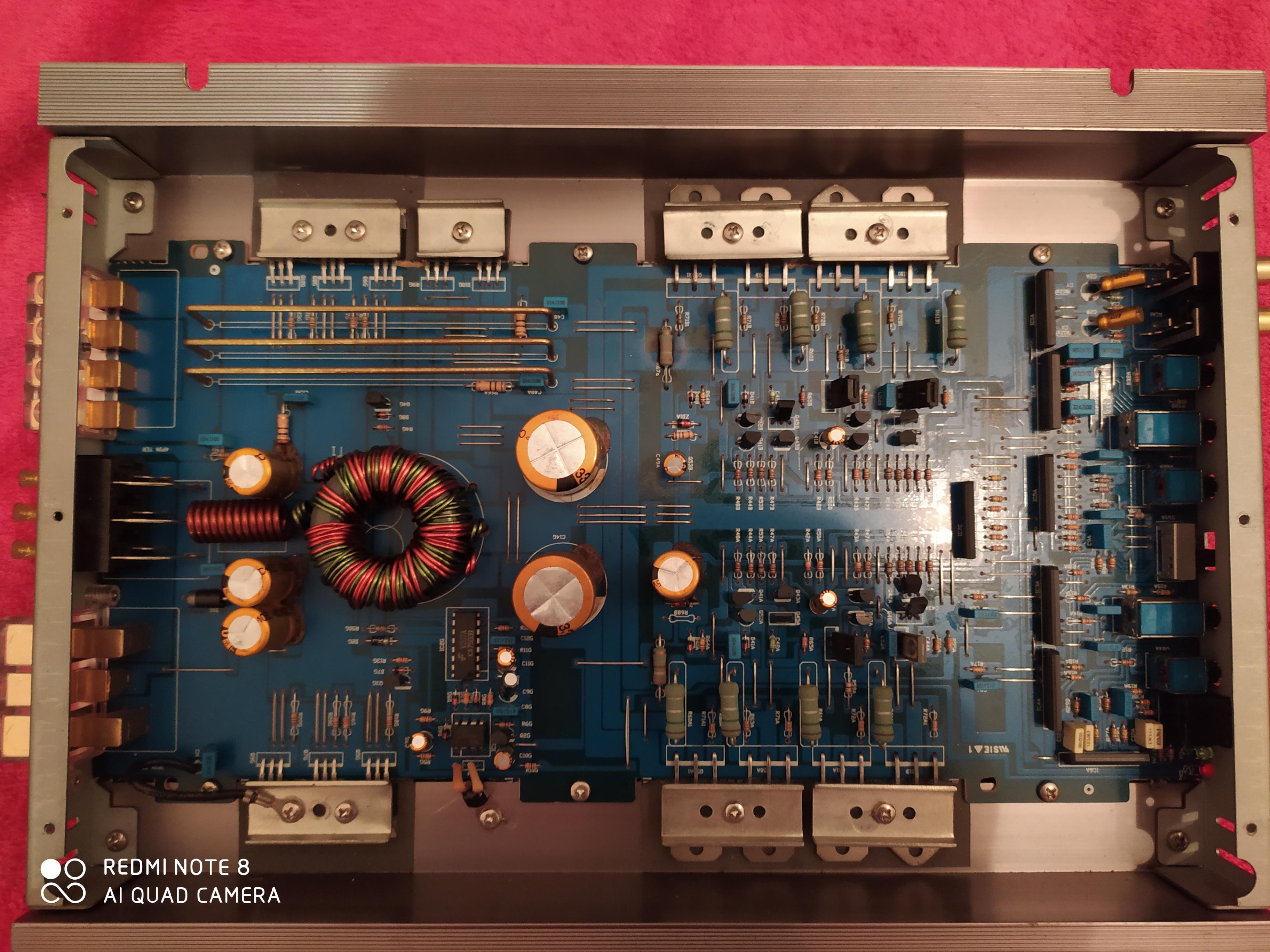

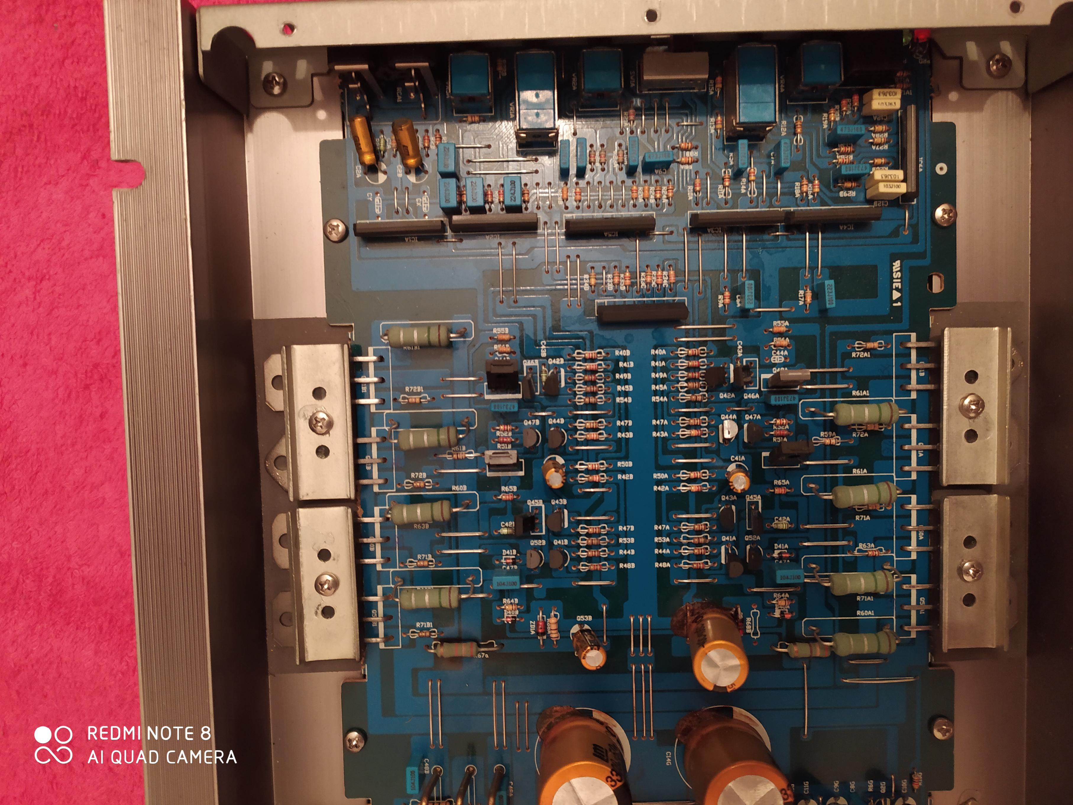

In the meantime i have opened the amp
From your words i understand that is better not to touch anything

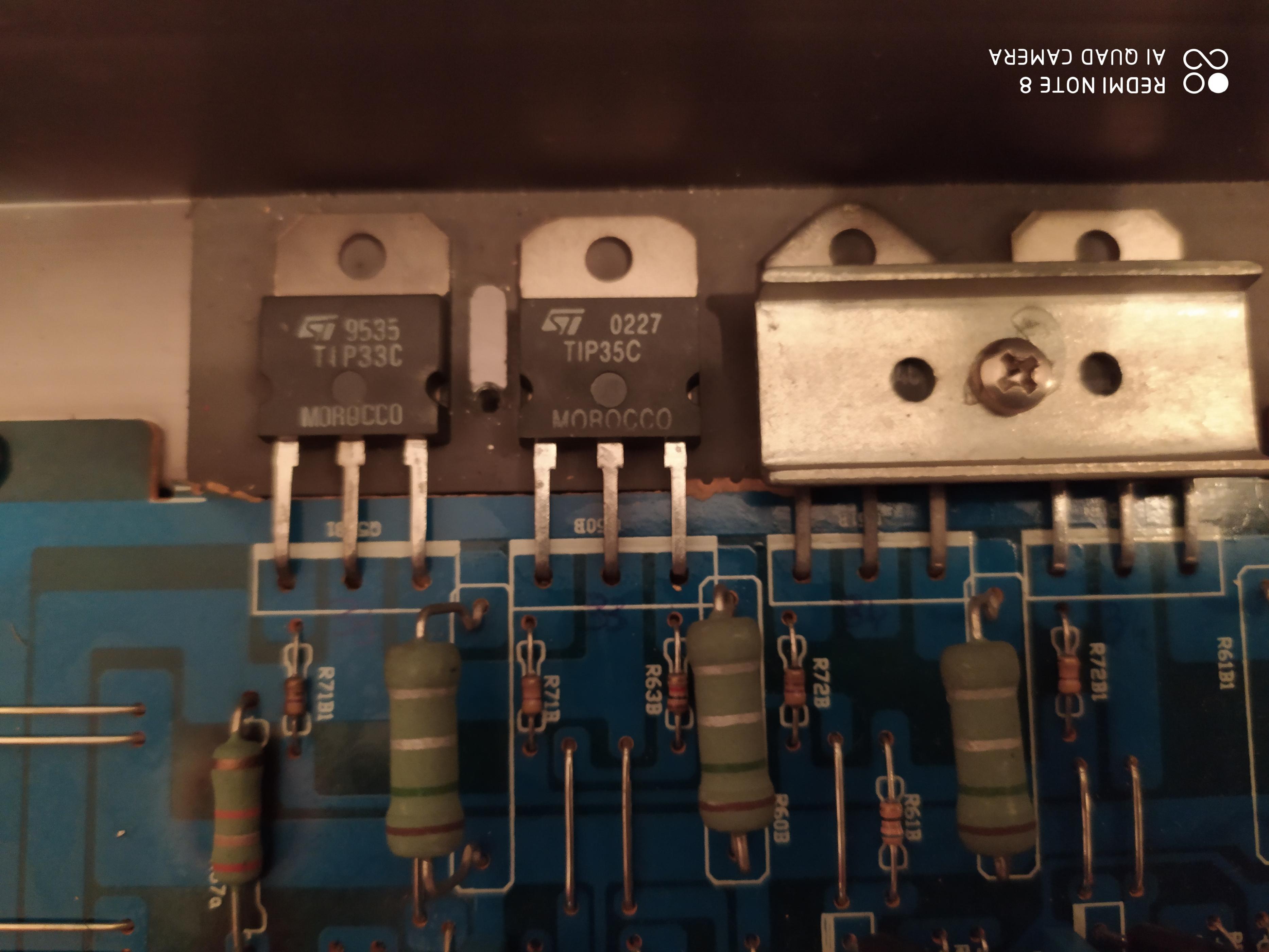

There is just one point that i do not understand Why to parallel two pairs of 80W output bjts per channel instead of using just one pair of 150W bjts per channel ? or even 200W pairs... i know they exist
The output bjts used are obsolete. The two power supply caps are just 3300uF

I think those tip33/35s are 125 w devices, not 80.
The size of the rails caps in smps power supplies are generally smaller ( though low esr and high ripple current) Compared to linear power supply caps as they “refilled” at a much higher frequency, 10s of KHz vs 50/60Hz.
The 33 is an 80w transistor.
The TIP35C is still available.
I would guess that this amp has been repaired and someone mixed the transistors. What are the rest of the transistors? Don't lift them from the silpads.

The secondary power supply has two rail caps. The primary has 3 capacitors.
Post #114 was right about the rail caps. To use mains power, you have to use much larger caps (and remember that you have other circuits that may need modification to work from a mains supply.

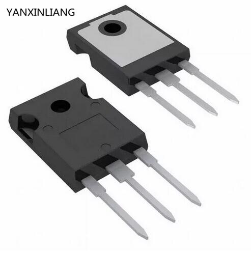

The metal tab on the TO-218 and the TO-247 case are nearly identical. The plastic housing's shape is the biggest difference.
With the absolute minimum number of output transistors, you're limited on power.
How many manufacturers advertise that a minimum number of outputs improves the sound quality?
Measuring noise and distortion on car amps can be difficult. A slight variation in how the wires are connected or laid out can make a huge difference. Filtering (in the software) can help but can still give misleading results. If you don't use the exact same setup from one test to the next, the only thing that you'll be testing is the setup.
