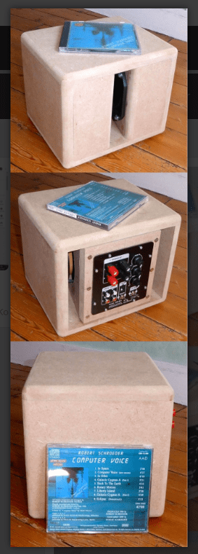

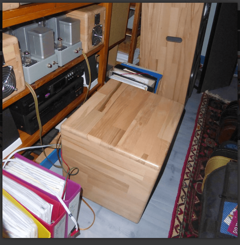

The Ripole formula can be considered aperiodic since it is not tuned... Moreover, it is compact and delivers a floating but non-resonant, omnidirectional but unobtrusive infra-bass of its own. Mine below is 400x400x440mm, fitted with 2x12" Beyma 12BR70, and can reach 15Hz. The Sub module cuts at 40Hz / 12 or 24dB/Oct. , depending on the speaker's natural low cut-off that are paired with.
This subwoofer is notably remarkable when paired with Magneplanar speakers (tests made with MG 2.5 and SMGb).

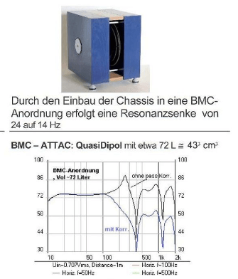

You see below the matching dip and peak that I mention (doc. from Mr Ridthahler / Ripole inventor) located at circa 250 and 400Hz :
Consequently, don't expect too much using a Ripole over 80-100Hz, to avoid these response issues...
And yes, if you need the typical Home-Theater Boom-Boom, it's better to use a Bass-Reflex subwoofer than the Ripole : the pressurization - as you say - will be more efficient...

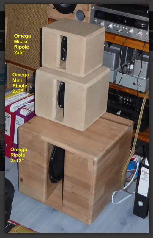

Different Ripole size experimentations at home :

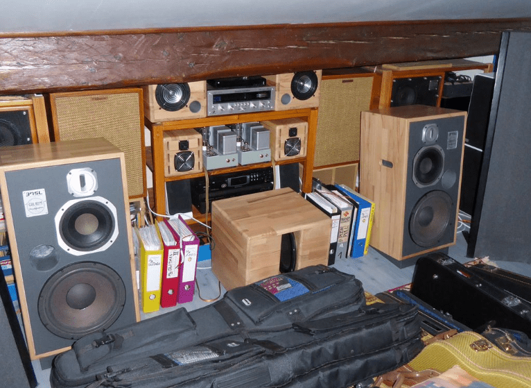

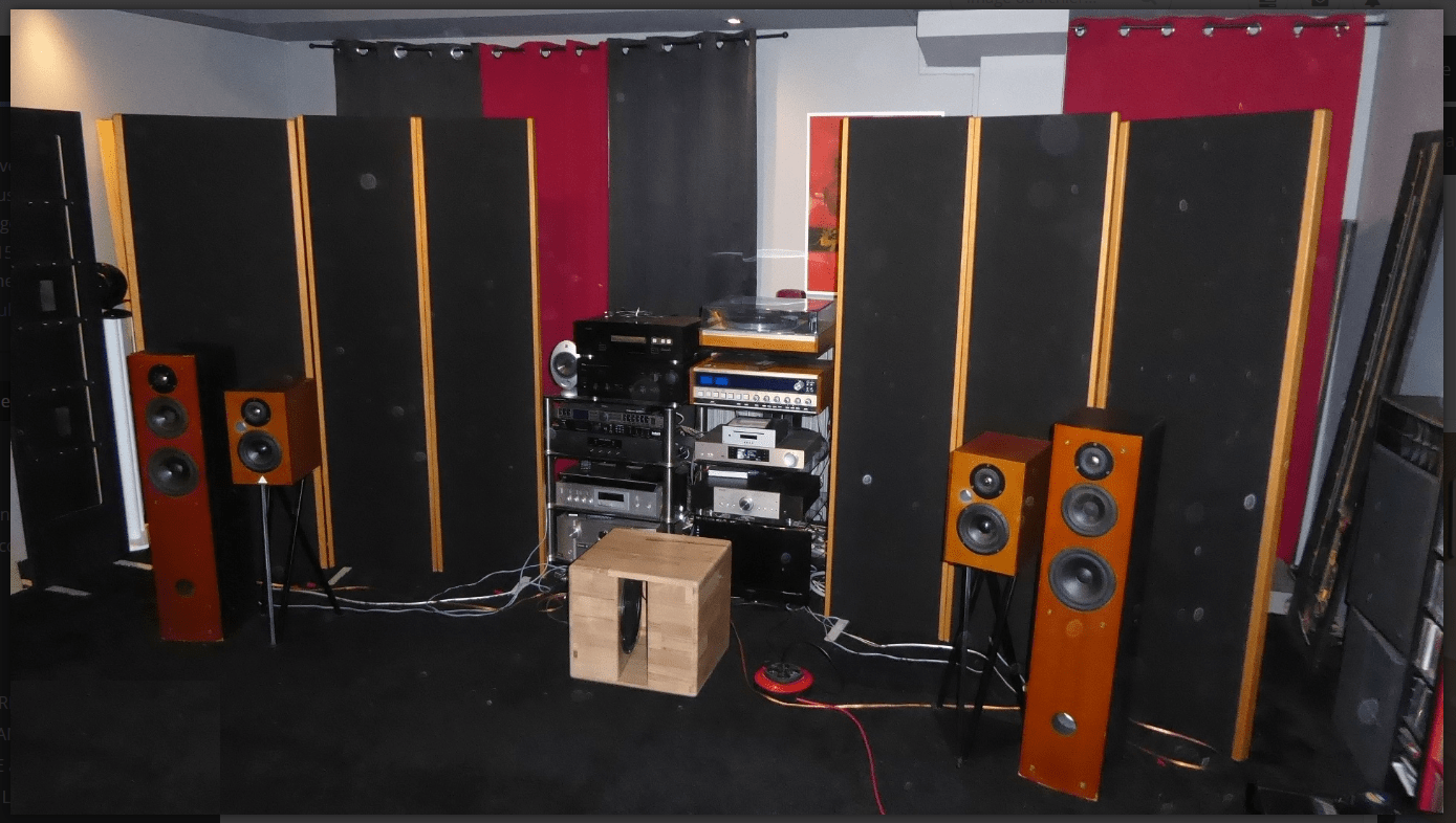

Ripole placement in my tiny Auditorium - placement in accordance with Mr. Ridtahler's indications :

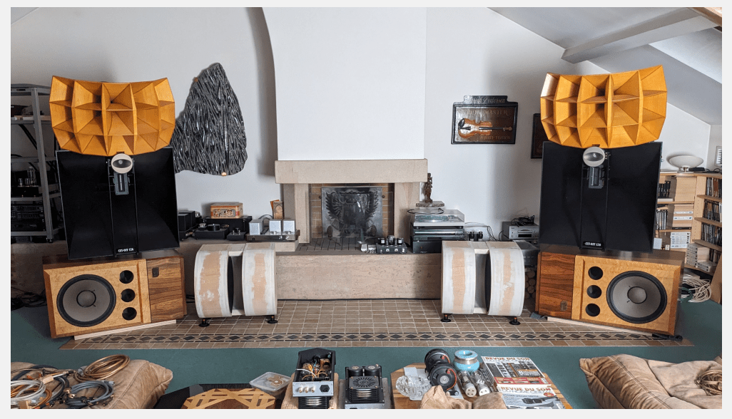

The builds (below, unfinished at that time) of one of my friends, after listening to my 2x12" Omega Ripole : he went for two 2x18" Ripoles, instead of his pair of Velodyne subs...
Tests with another friend, a Magnepan fan and rebuilder, in his auditorium :

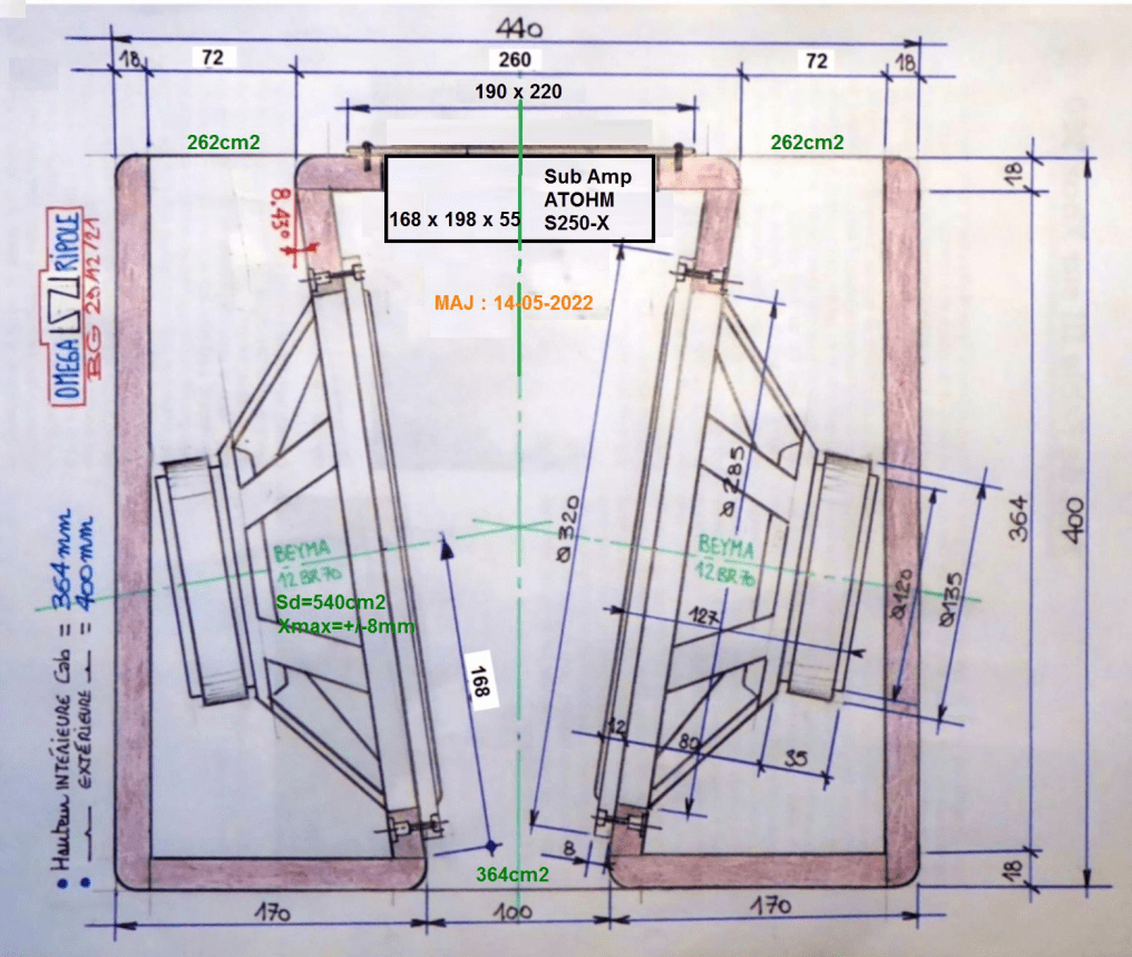

I have visaton Petite orgue its a 10" ripole sweet bass but doesnt presserize my room. I have Beyma 12BR70 4 drives in my OB with TB1808 FullRange I can try the Beyma am sure it will be better than the 10" ripole of Visaton. Can you share the dimentions of your Beyma Ripole please. I see the magnet circle is not cut on the side of the box thats different than my Visaton ripole.The Ripole formula can be considered aperiodic since it is not tuned... Moreover, it is compact and delivers a floating but non-resonant, omnidirectional but unobtrusive infra-bass of its own. Mine below is 400x400x440mm, fitted with 2x12" Beyma 12BR70, and can reach 15Hz. The Sub module cuts at 40Hz / 12 or 24dB/Oct. , depending on the speaker's natural low cut-off that are paired with.
T
Also in your studio Pic you have a 3 way speaker do you find the bass of the beyma 12br70 ripole better than the 3 way in pressurizing theroom.
I am not sure that these are the exact build dimensions, but OK : you have the picture...
In fact, my 3-ways 375L studio monitor don't really need the help of my Omega Ripole sub. I use it mainly with my Magnepan SMGb for infra-bass extension. This is the only type of sub that I tested with success to marry and blend with magneplanar speakers...
