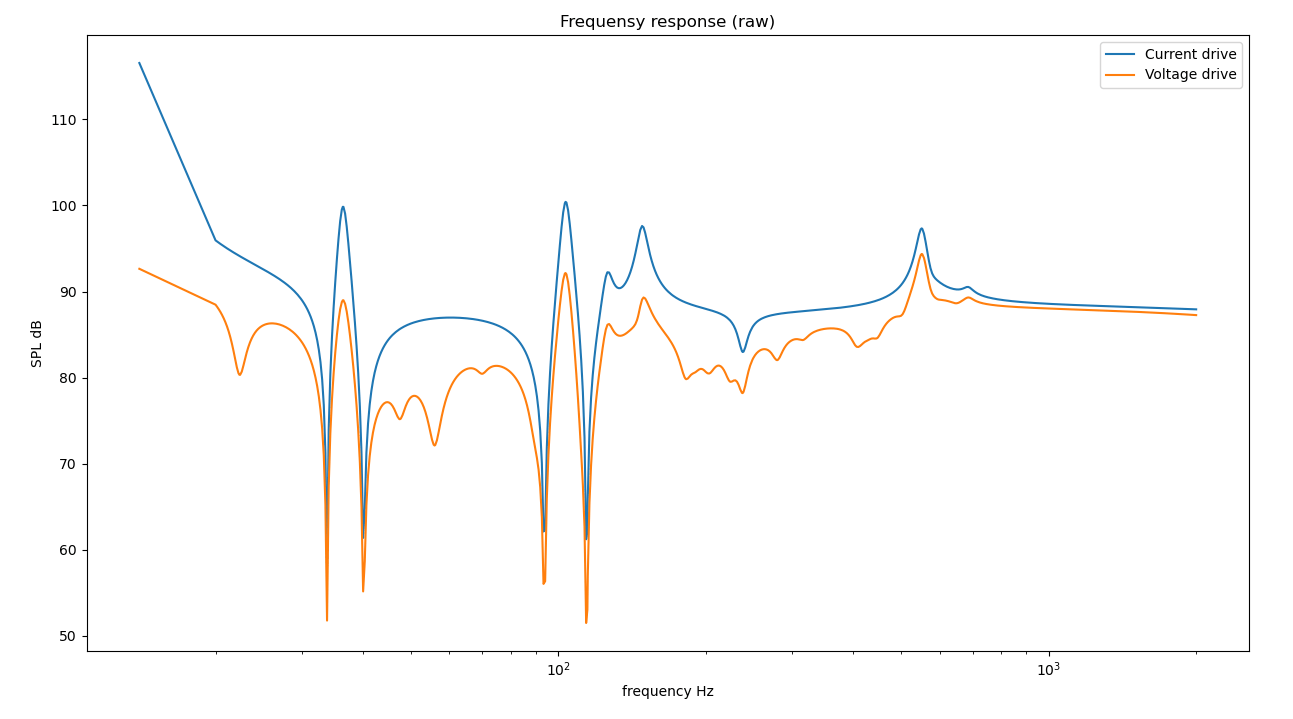

I change for the data you used in #275. Possible remaining difference are on the damping coeff (0.05), force (I set to 2.83V in 4Ohms and Bl=4NA so 2.83N in current driving mode).
The LF cut off in my simulation is not visible neither (I have it in the previous post with a smaller plate - 400x600mm and higher E=10MPa)

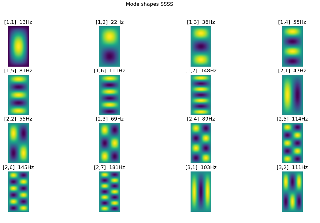

In the conditions I used (simply supported, exciter not included in the mode calculation), the 1st mode is very low (13Hz) so below my range of frequency which starts at 20Hz. This not really surprising has the Young modulus is low (EPS?) and in consequence the bending stiffness also (1.23Nm).
For testing, I would suggest to come to a stiffer material to have a 1st mode let say 50 to 80Hz?
Last image is our 2 FR in lin frequency scale. Can't say less than : some differences! At least we have some approaches that start working. Need more debugging!

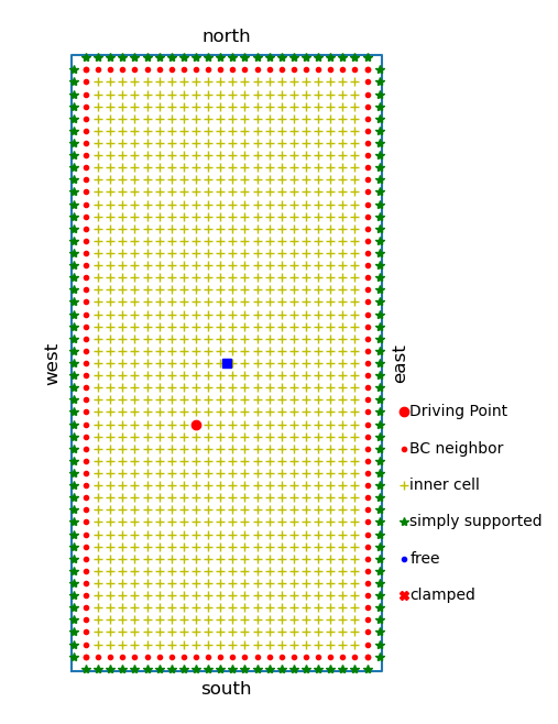

Simulation :
The plate is Lx = 0.5 m by Ly = 1.0 m
The mesh is Nx = 26 cells by Ny = 51 cells
with a grid dx = 20 mm by dy = 20 mm
Bending stiffness B = 1.23 Nm, Areal density µ = 0.39 kg/m²
Driving Point at 0.4 0.4
Exciter : Re = 4.0 Ohm, Le = 0.1 mH, Bl = 4.0 N/A
Point Of Observation at 3.0 m

Hi Christian
I get eigenfrequencies very close to yours.
The big differences seem to be that
Unfortunately it seems that in Elmer, the damping is not fully implemented. I have checked Rayleigh damping alpha (mass proportional, giving high damping at low frequency) and it works as expected. I wanted to use a high value for Rayleigh damping beta, to see if I could get results close to yours, but unfortunately beta seems to be unimplemented.
Modal superposition has advantages, including faster calculation, and fine control over damping (you can select a different damping constant for each mode, if you want). I may move to that too. Are you using a formula similar to the Thompson paper we were discussing for Rayleigh integral (last 2 formulae in post 170?) What range of modes are you summing over at any particular frequency (formula says to sum ALL contributions, but I think we can assume just a few nearby modes will contribute significantly at any given frequency)? Can you show some of your calculated mode shapes at frequencies between the eigenmodes? We can compare to results from the 'brute force' direct harmonic method of Elmer.

Yes, I am wondering if they are not a bit too high...(it won't be the 1st time I introduce an error of a factor or whatever in a formula... ;-) ). Check needed
- You have higher values overall
Damping was set to 0.05 (need to start somewhere...) but constant with frequency. I saw the effect you detected after posting. The reason is not in the damping. Also to be checked (maybe not enough modes involved in the higher portion of the frequency range, only 50 modes used in this simulation)
- You have a very high value of damping, smoothing the modal peaks, and increasing with frequency.

In this script, I used the word "mode shape" in the meaning of eigenvector (phi in the formulas) giving the shape of the displacement at the natural frequencies. For each frequency, the script compute what I call speed shape which the speed of the points of the plate at the considered frequency, for the exciting point used. So it is the result in speed of the modes superposition under the effect of the damping. When modes are closed, because of the damping or because of the exciter position, we don't get the nice mode shape then. But this available. For now, I plot them for some natural frequencies. Which frequencies would you like in between?Can you show some of your calculated mode shapes at frequencies between the eigenmodes? We can compare to results from the 'brute force' direct harmonic method of Elmer.
