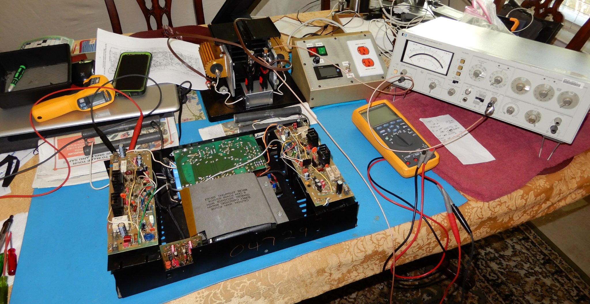

Why not just buy a used one and service/upgrade it? I've done just that to our three units. New output transistors, film caps, electrolytics, trimmers, bypass caps, and other odds and ends. Certainly less expensive than designing and building a clone, which would be difficult based on the lack of availability of many of the smaller transistor types.
This photo is while setting the impedance warning light, in preparation for conducting distortion/function testing.
