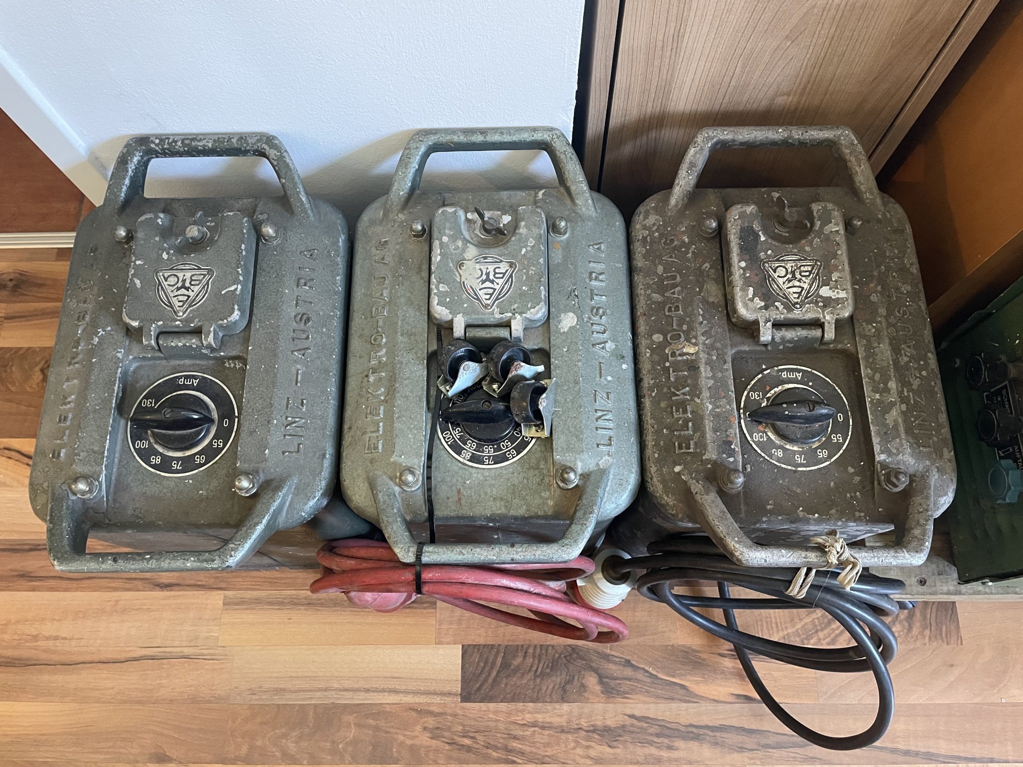

So I was successful in getting another two identical machines, although for a little higher price than the first. Don’t think anyone is buying such antiquated welding machines.
There would be used for as power supply for my Aleph 5 clone mono block.

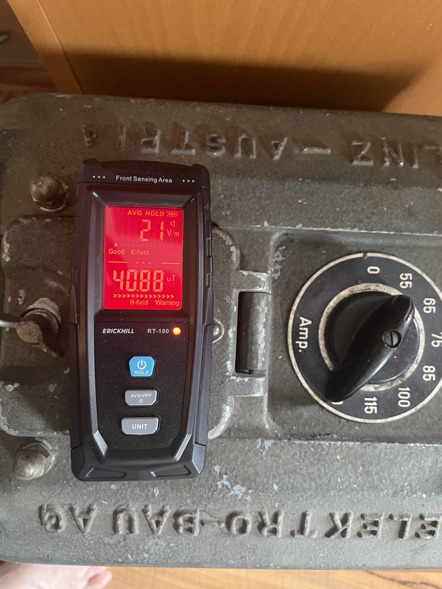

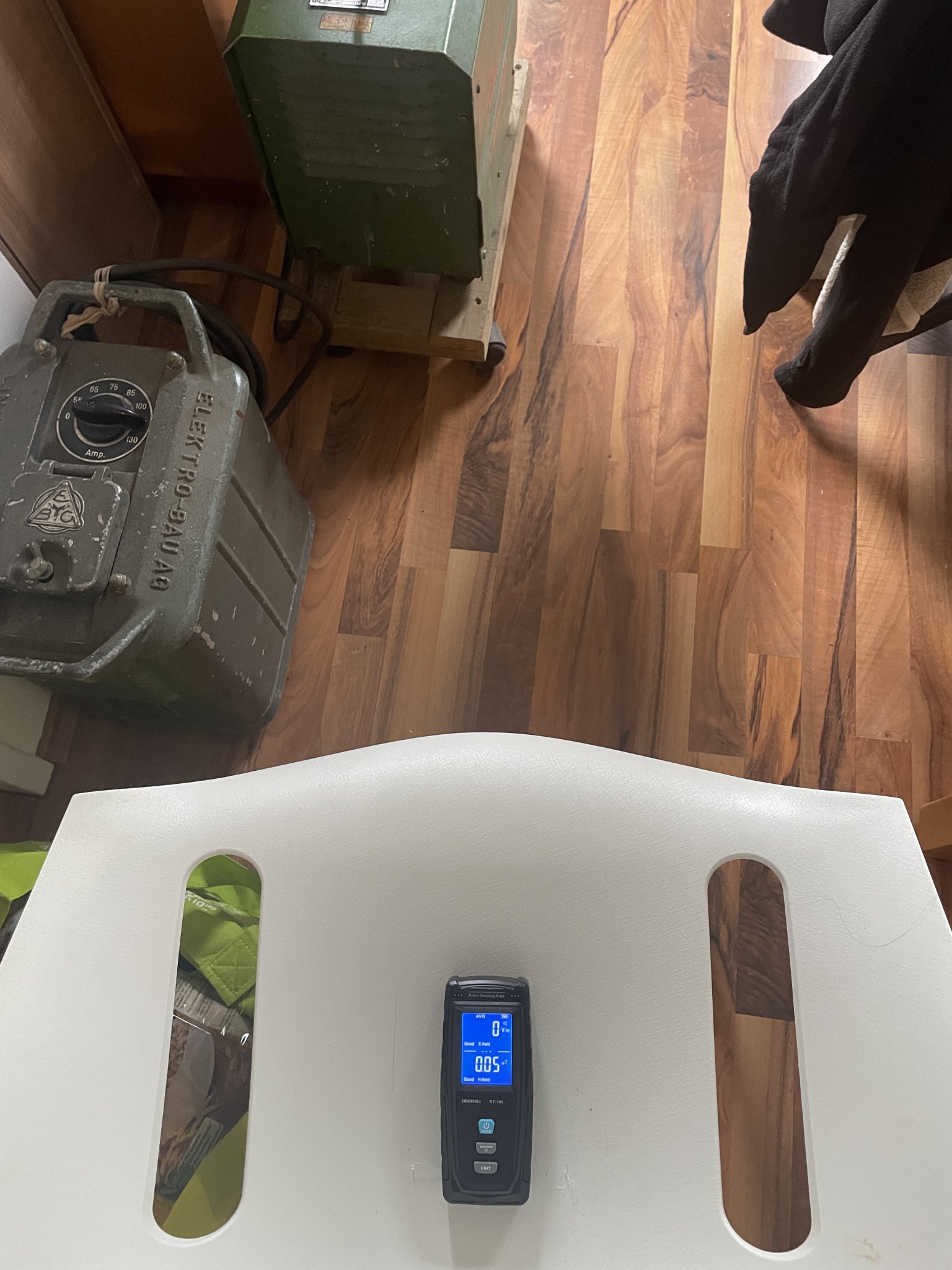

To have a piece of mind that extended exposure to EMF emission, I tested it with a EMF meter, at 1 metre distance, it is 0.05uT, and 40uT when the test meter is placed right next to it, the meter was beeping like crazy, but I read somewhere that the safety limit for emf is 100uT, and for workplace is 500uT, whatever that means, perhaps an expert can chime in.

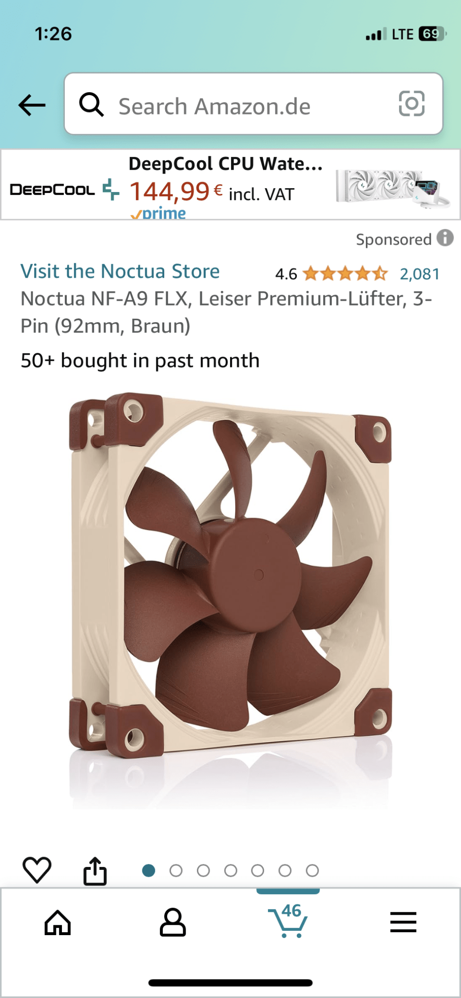

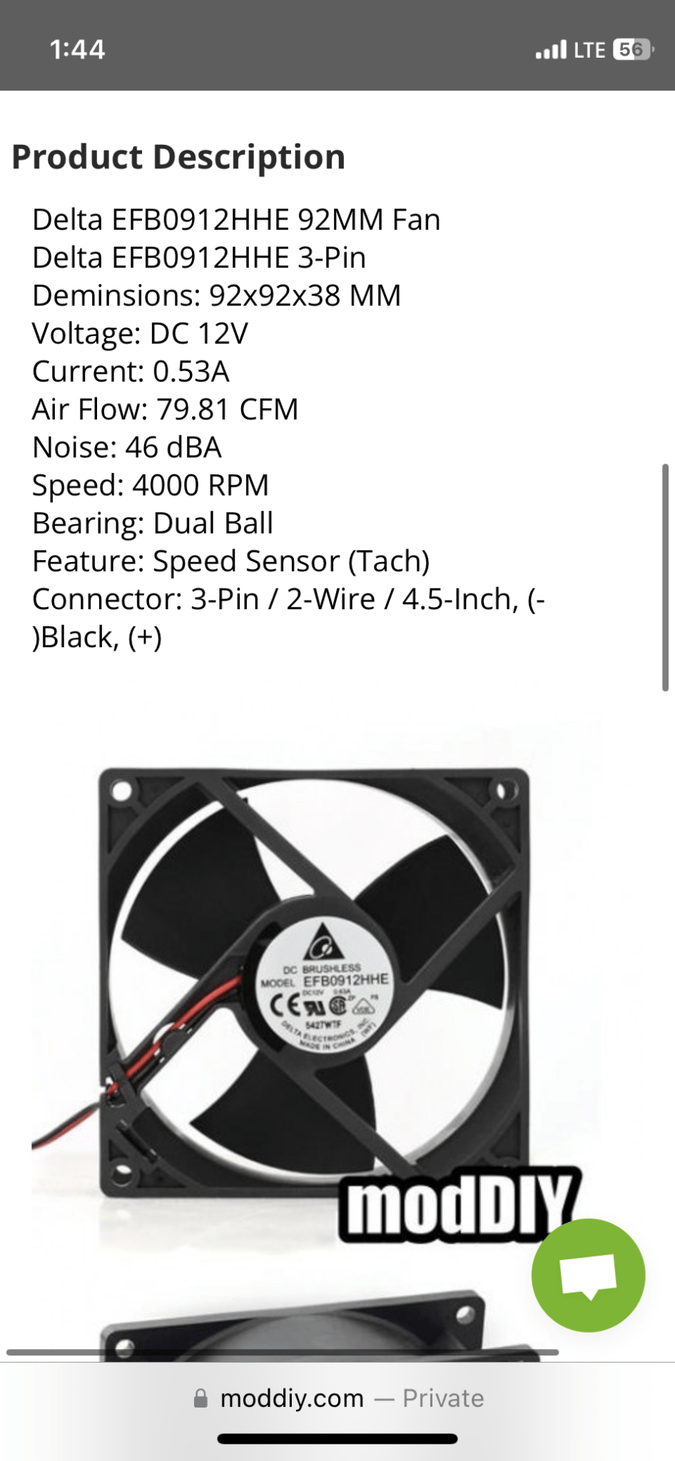

I am deliberating between using external huge heat sinks (400X400X50) with natural convection cooling which will make the mono block rather huge, but with fairly empty internals; and forced cooling with heat sinks fitted inside the casings.
The 4 units of 90mm delta fans came with the original Macpower are loud (46dBA each)! So 4 of these would give me 46+9=54dBA (is that correct way to calculate?)
I wonder if anyone have tried the supposedly whispering Noctua NF-A9 FLX fan (17dBA, And 4 of them will be 26dBA?).
how are they like? The volume of air that they move is only about half the amount of air when compared to the Delta fans.

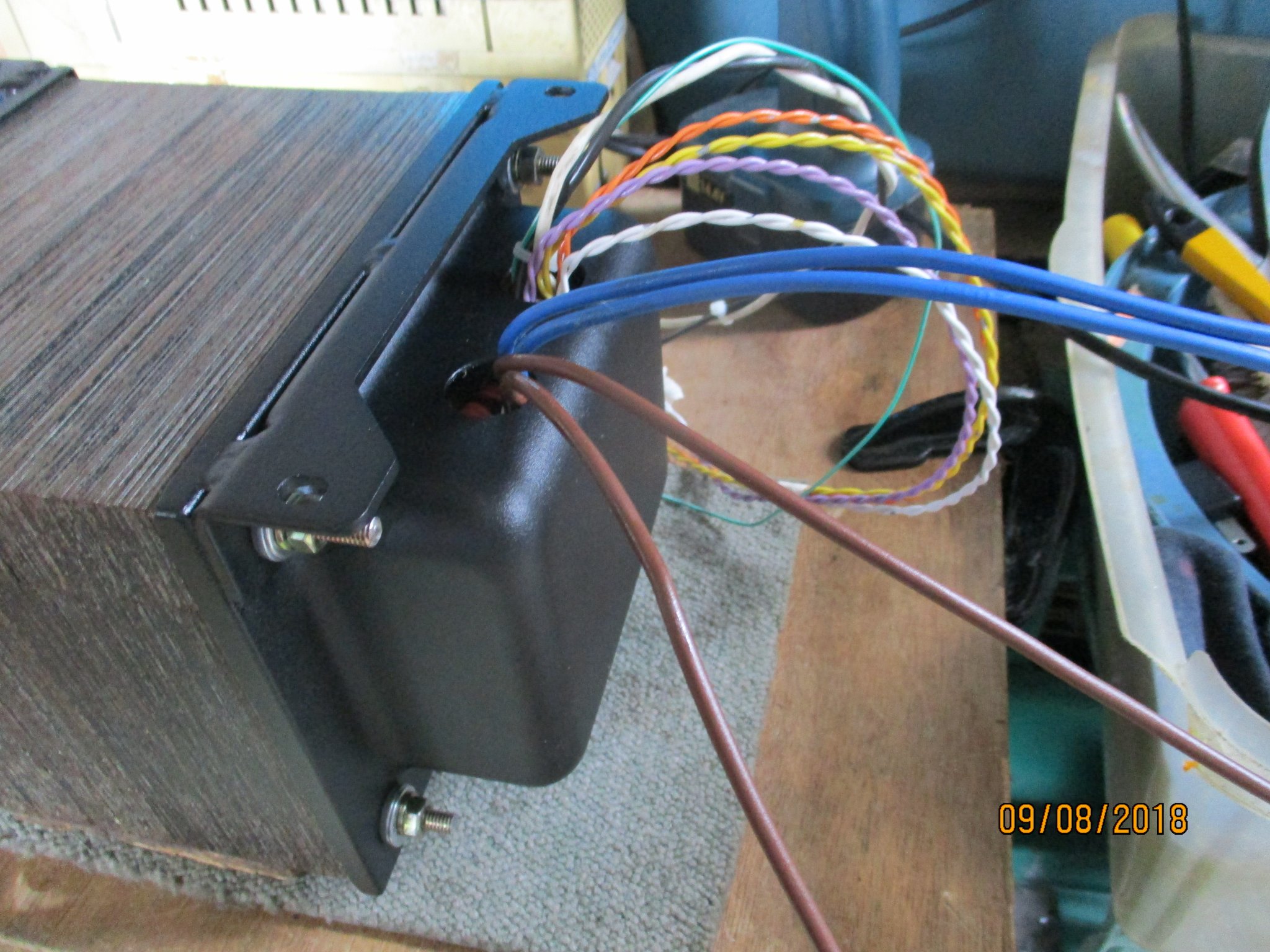

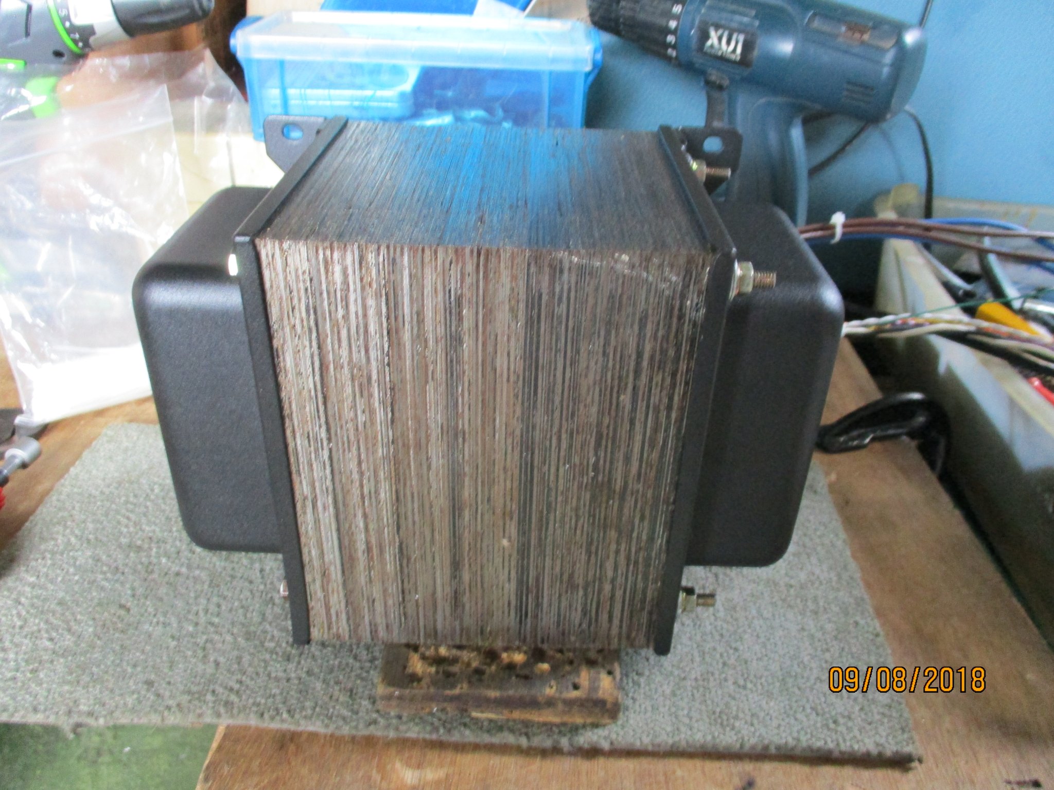

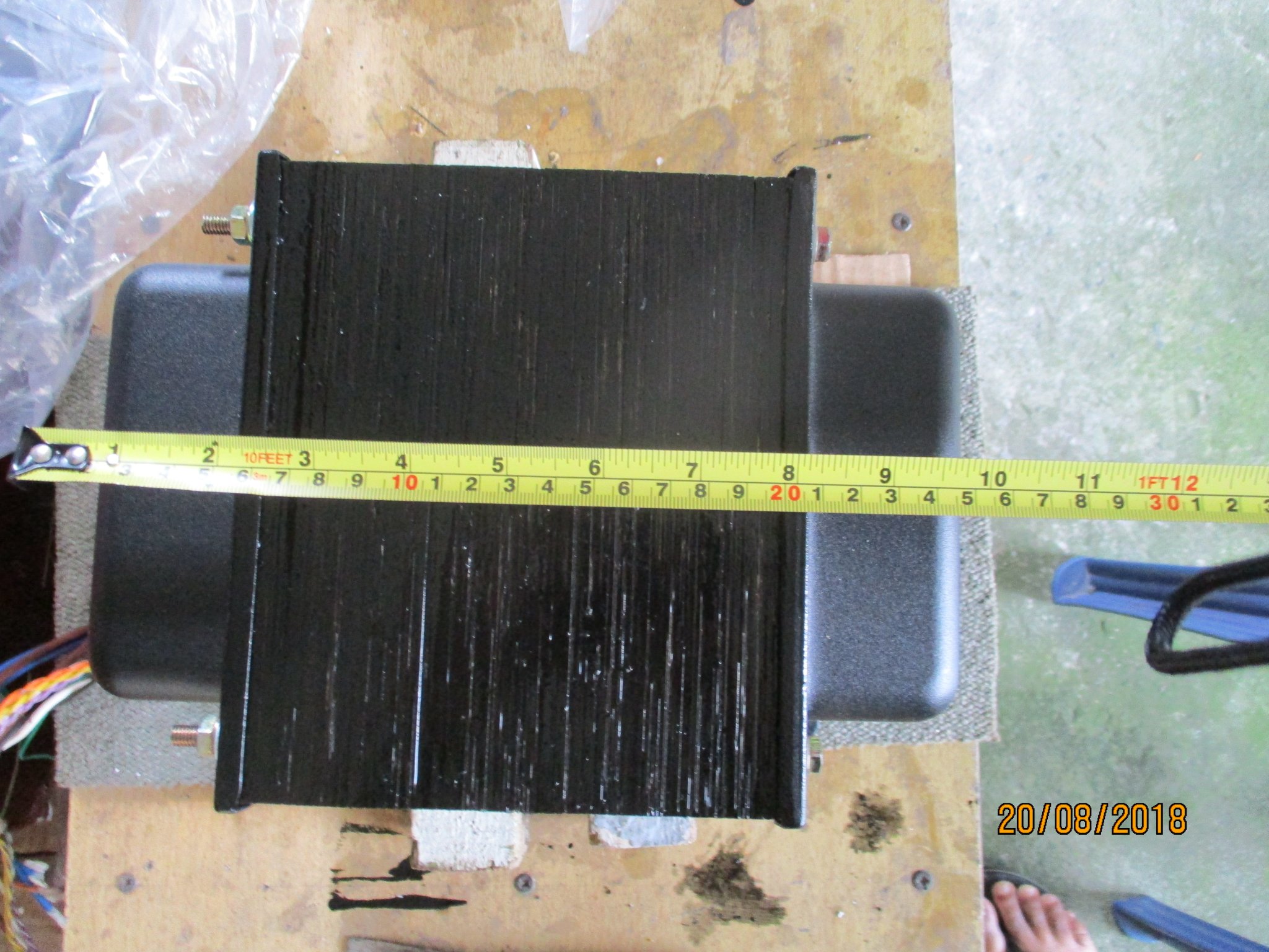

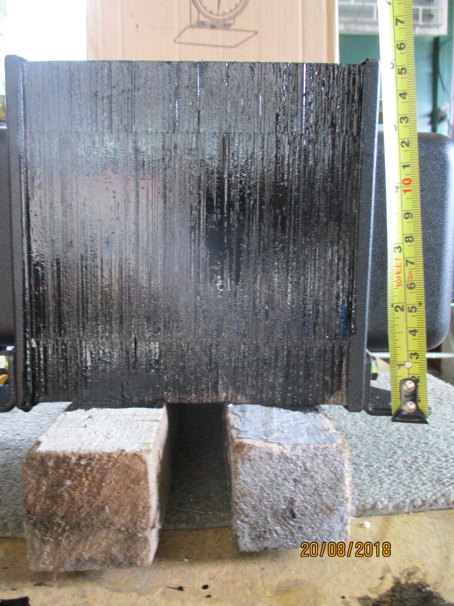

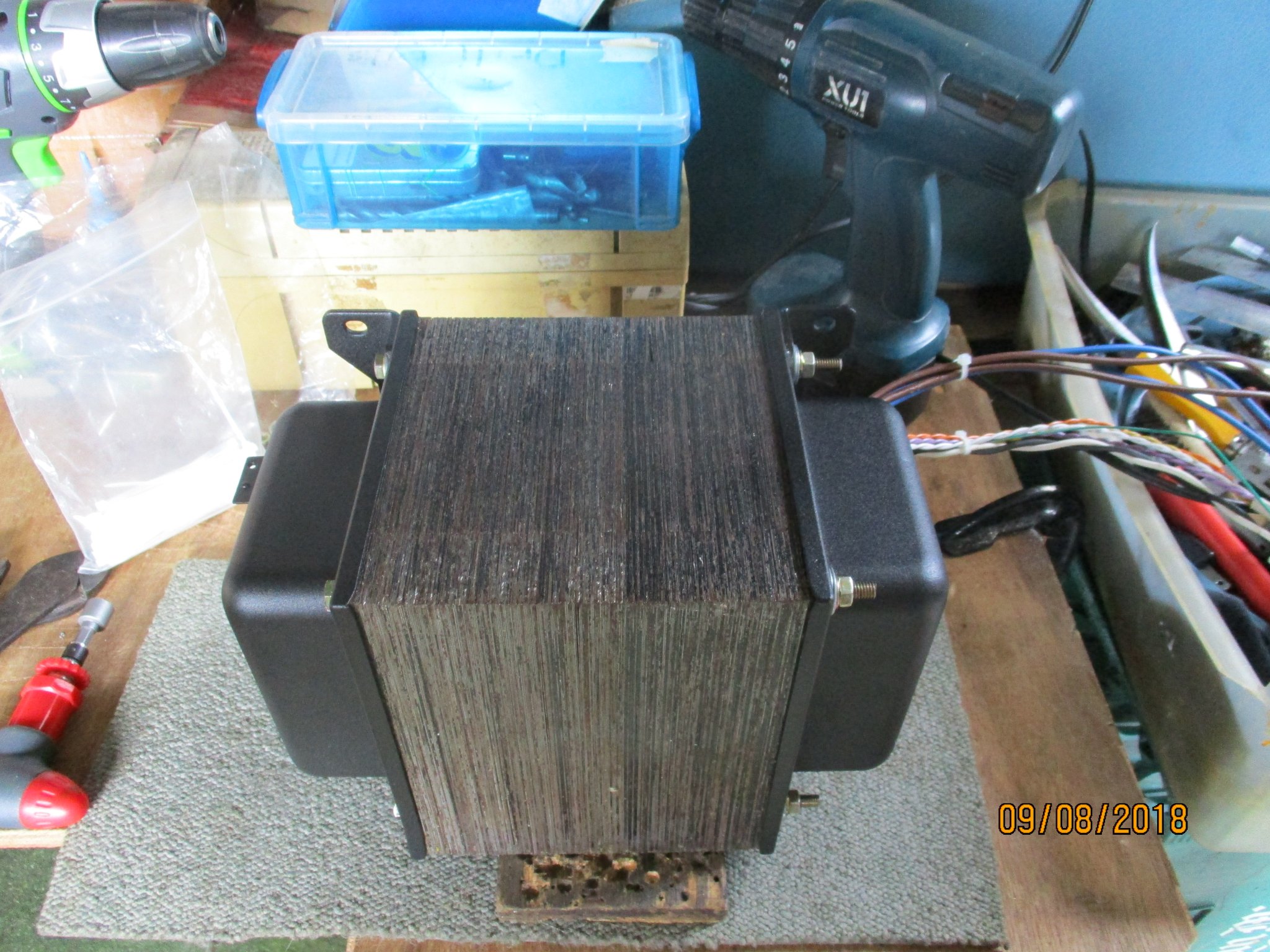

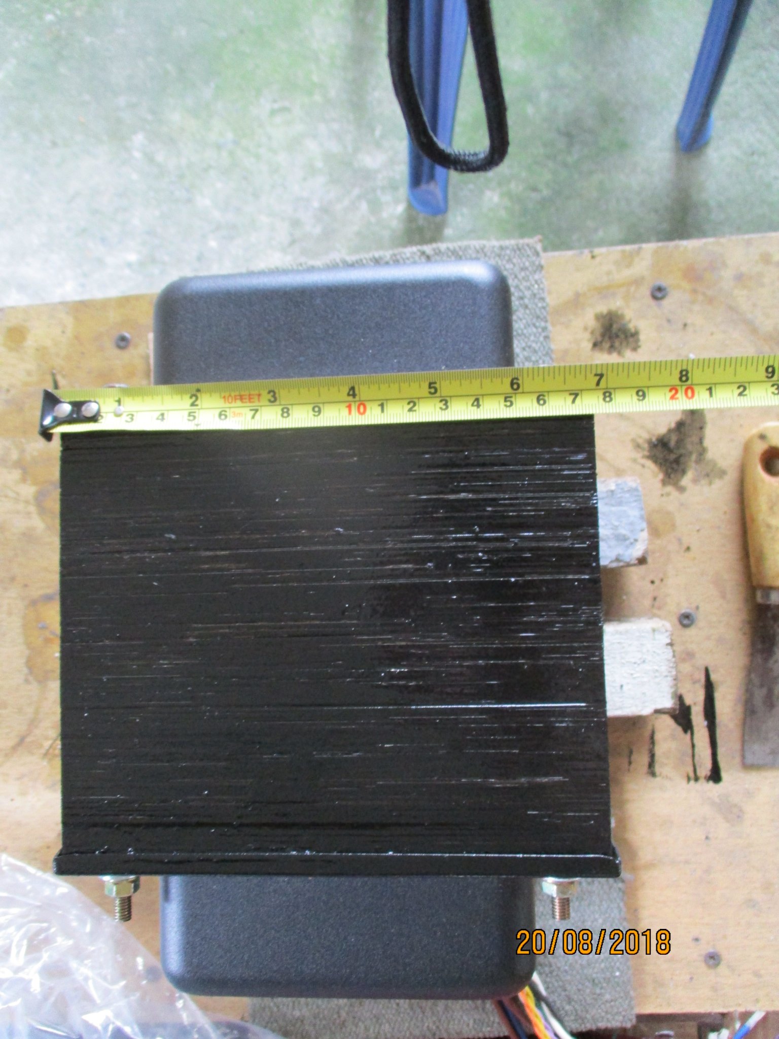

i have an even bigger PTX made.... weighed in at around 28kg..
