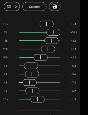

For example, I built this 'enclosure' in 6 minutes, and installed the speaker in another 10 minutes. 16 minutes total. The finish is not good since it is a prototype, but I was amazed at the clarity and definition of these speakers, yes I left the tweeter on this time. I had a great listening session to Sade in the afternoon. Every instrument was clear, and the voice had more expression. The bass is present though discreet. Altogether enjoyable with EQ shown.
Scale model out of thin card:
Folded baffle
Completed prototype
EQ That had to be used...
Any suggestions on the dimensions, height, depth, driver placement? Sounds good to me, could be better. I want to extend the bottom section and make it a floor stander of 1 metre height. Speaker placement is important and must be designed in to the speaker.
Would a port or passive radiator do any good?
Width: 12.5 cm, Height: 33 cm, Depth: 12 cm. The side baffles are held in place with a slotted piece of corrugated cardboard.

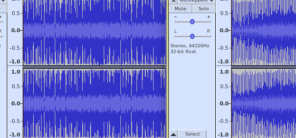

It's not. Maybe it sounds better to you because you happen to like the added distortion, or maybe because things you make yourself always sound better.Maybe you can answer the question why everything in audio is so upside down, with cheap stuff being better than expensive stuff, single transistor amps are better than multi transistor amps, cheap speakers are better than expensive stuff. What is happening here?
It's well known that louder sounds better. Just turn the volume up rather than altering the source files.The track on the left sounds better than the track on the right. Is this what compression is about, and should I compress all my files to make them sound better on my system? Any drawbacks?
