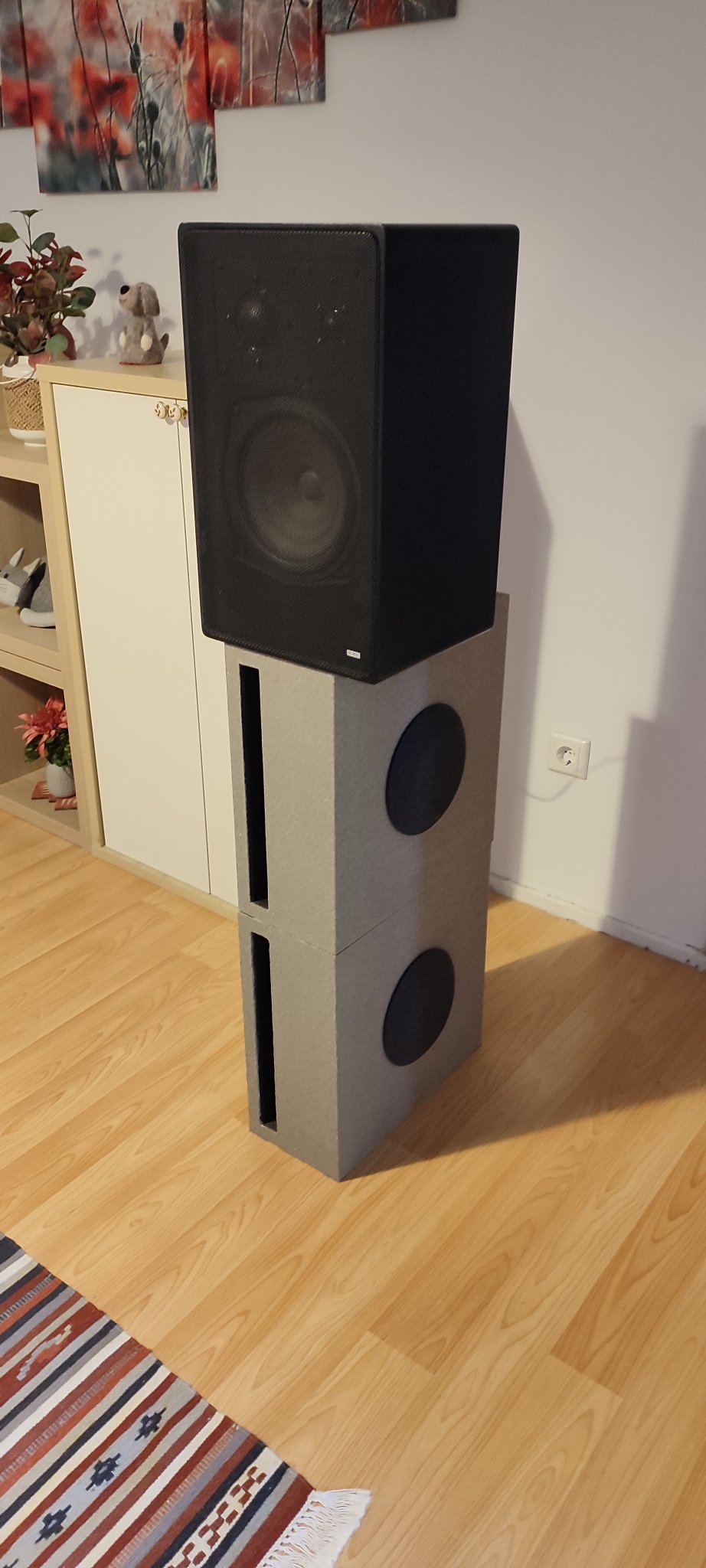

It's really easy to do. For the openings for the drivers I take silicone and make a rope around the opening. So no cement leaks out. Take a spoon to fill one side and wiggle the box in order to spread the cement equally everywhere.
The screws put in advance into the wood and even with thin wood the screws have already the right depth.

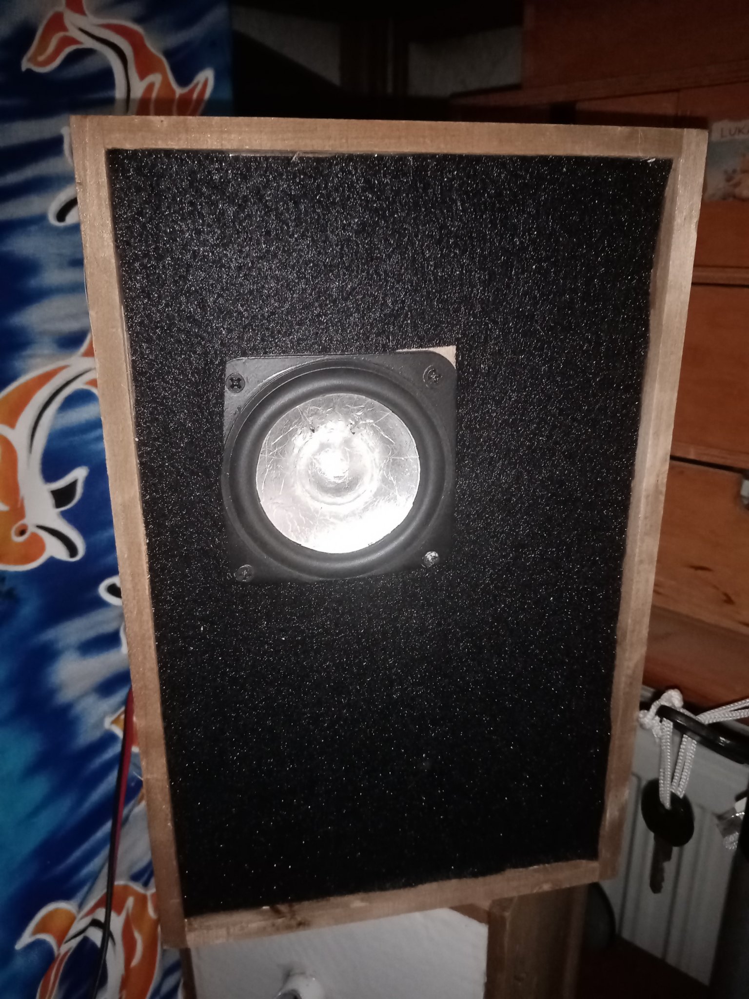

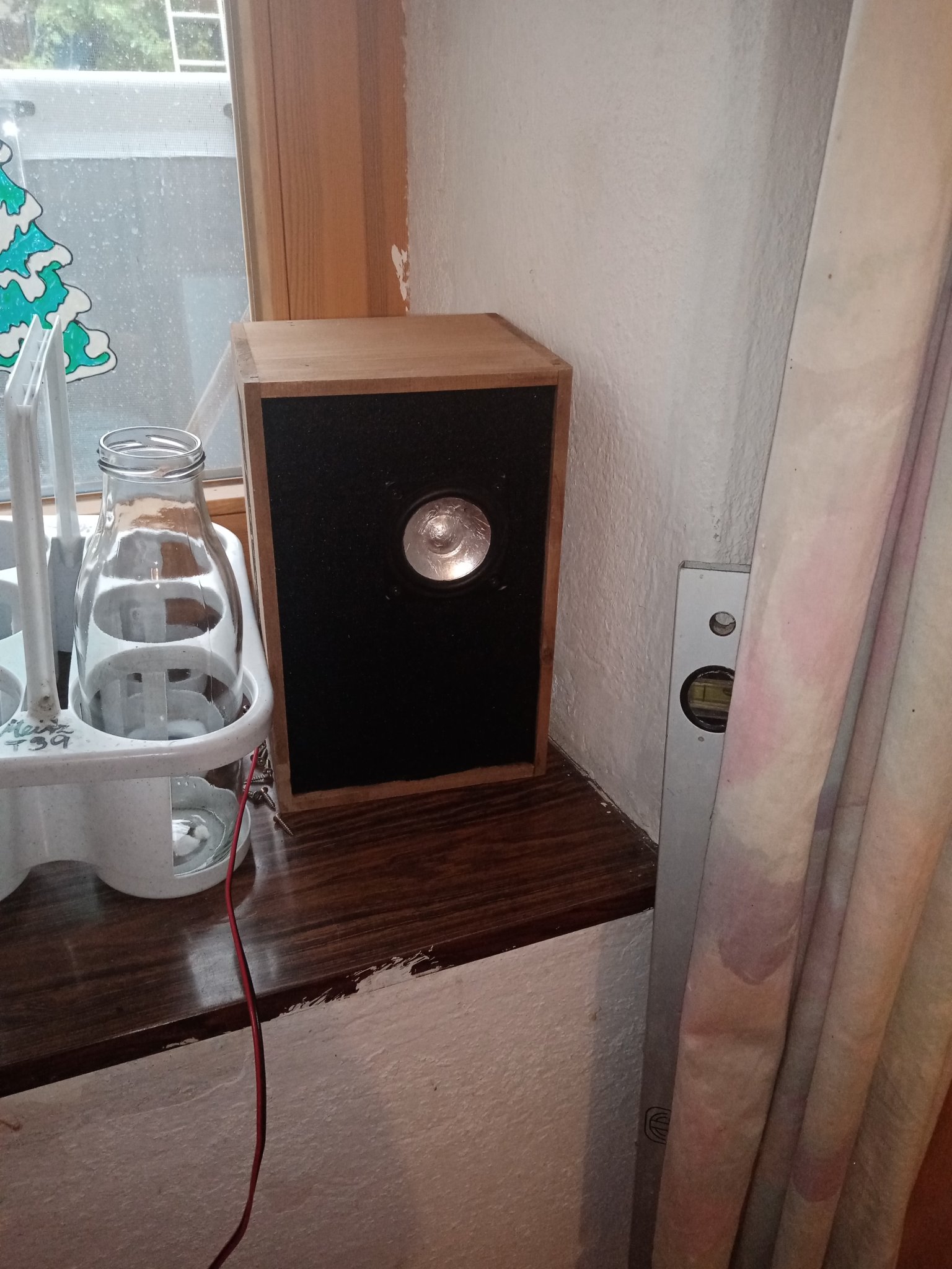

cardboard used for the back side of the box.
later I put aluminium foil inside to prevent making the paper wet and reinforced all box sides internally with 1cm concrete.
Box was a design all purpose tool box. Five wooden sides already there so easy work for diy project.
Always wanted to try my 8cm diy aluminium sandwich foiled fullranges in a bigger box.
Reflex tuned low to 30hertz.
diy alu tweak
diy alu tweak
https://www.diyaudio.com/community/...loudspeaker-sandwich-cone.402917/post-7443470
small 8cm jvc fullrange opened, kapton former, faraday pole piece

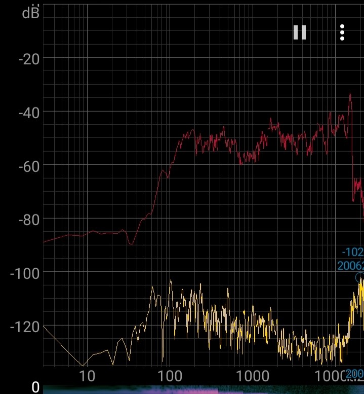

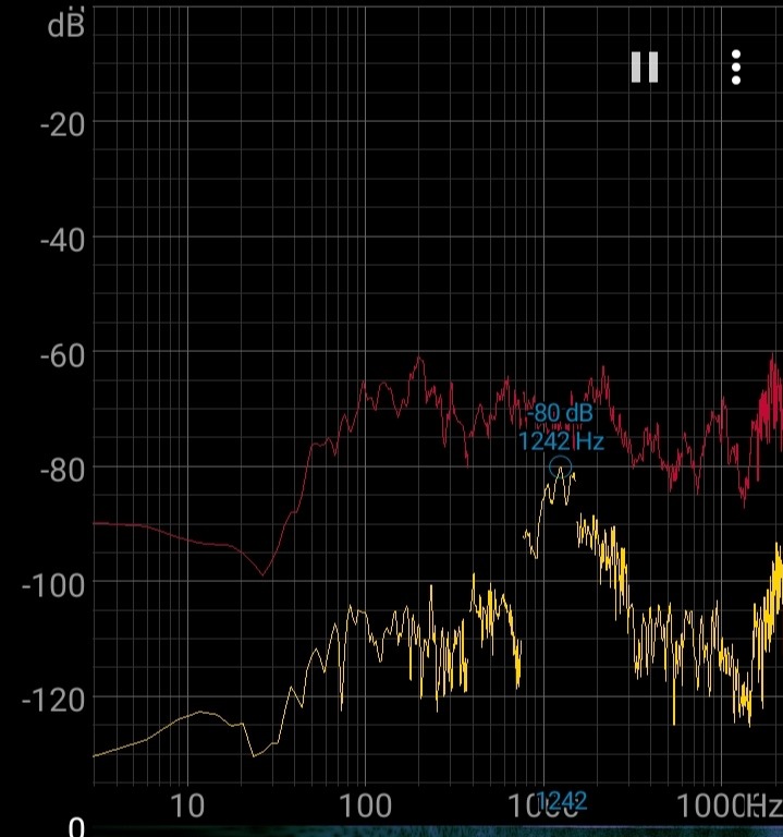

Sound test. Sounds really good. If close to back wall also good bass.
Slight EQ for listening (measurements without EQ!)
+5db at 60 hertz
-3.5db at 150 hertz
+3.5db at 14 khz
measured in this position
8cm driver goes down to 120hertz
with reflex down to 100 hertz and falling response down to 50hertz (measured back side at the reflex port)
this is a true high end loudspeaker for voices and with moderate listening level
at all frequencies sounding right, also in the bass.
measurements roughly made with white noise and spectroid as measurement program (all smartfone based)
