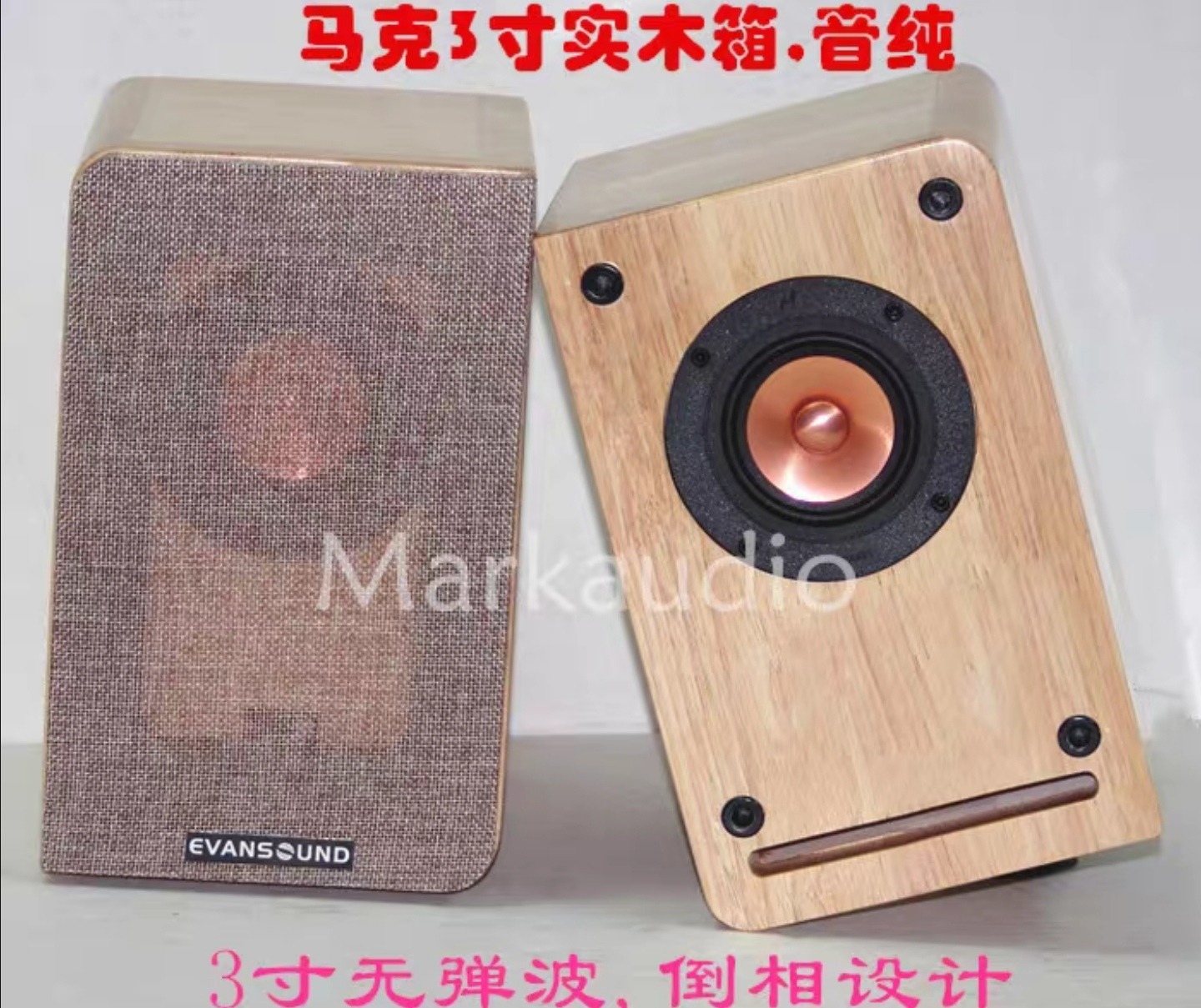

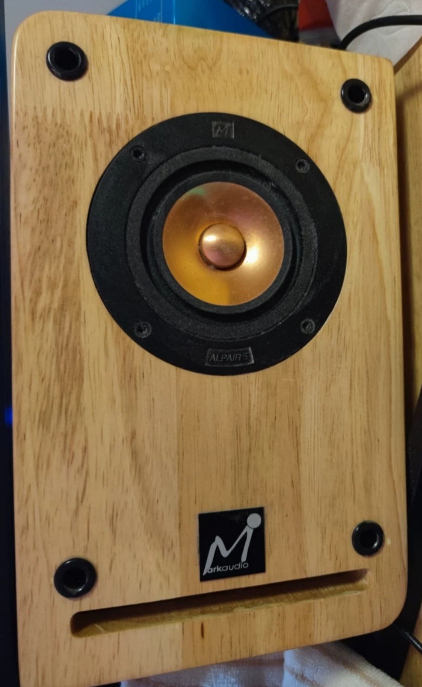

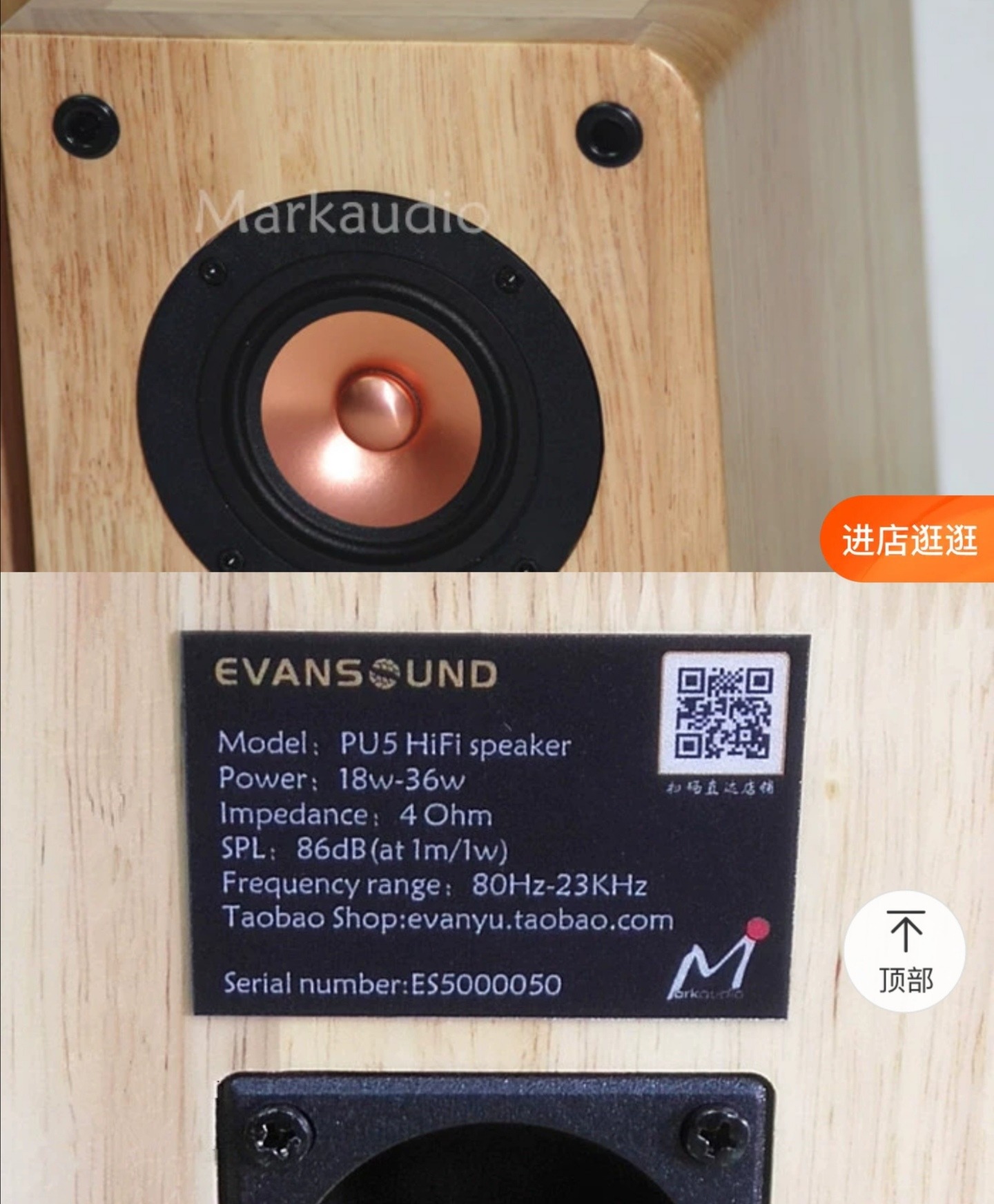

Thanks to China efficiency (41hr after ordering) I have the 5W 86dB 5cm Mg cone mono-suspension Alpair in oak 3.5L BR and listened for a very few minutes before work. Need to warm up both speakers and amp. Tone sweep 250hz hump due to cab otherwise quite good. Dvorak symphony bass drum... not comparable to my 5" TLonkens of course but I'll wait till after work to pass judgment.
Seems to play mid-hi (brass) loud enough in a smallish bedroom. I don't know what 110dB transcient means in mid-hi range.

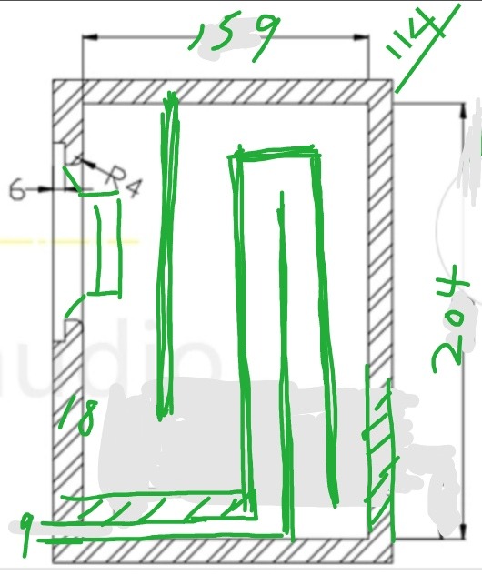

Thick fingered-oak slot-loaded, I'll open them up tonight to measure slot and maybe compare TLonken with 1-2L sealed etc. According to product page 150x240x195ext so guesstimate 114x177x159int ~3.2L excluding slot.
Slot ~10x114x100.
