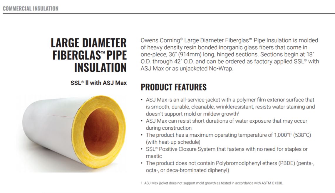

I've made many panels, gluing various thickness sheets to thin luan ply, and then wrapping it with fabric.
One of my favorite finds has been pipe insulation, 24" diameter, 36" long.
Wrap with fabric, and cap the ends by gluing ply on them.
Bass traps, and double as incredibly strong, super lightweight stands. I've put 300lbs on them no problem.

I never looked at the large diameter pipe insulation. I learned something new today !!!
Thanks for sharing, should help DIY' ers make some good corner bass traps !!!

note that pipe insulation is often made of very high density mineral wool, higher then is optimum, so it might be a good idea to have an eye on this and choose less dense versions
Why do you think the high density is an issue? For moderate thickness (up to 6") HD mineral wool (around 100kg/m3 or higher) does an excellent job.
With increased density it becomes more reflective, bbc did some studies showing this, i think others has done studies aswell
With absorptive material there's obviously an optimal range of density. Not dense enough and some of the sound will still pass through, hit the cabinet and reflect back. (And also vibrate the cabinet walls)
Too dense and you just reduce the volume of the enclosure and the surface of the "absorptive" material becomes the new boundary of the enclosure and you just lose box volume with no real gain.
