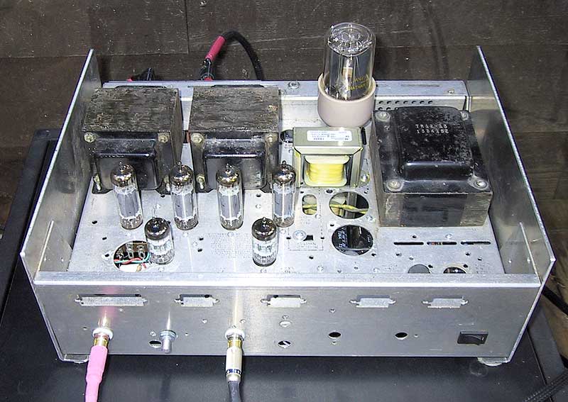

.......A recent session with my Class A PP EL84 (a staggering 3.2w at clipping) did not have anywhere near the loudess limitations expected. And i wa spleased that it held its own against my SIT-3 in sonics.
dave
Is the PP EL84 a public domain design that could be shared?
Great sounding for one listener may be crap sounding for another. Using such subjective criteria for amp search is not a good idea. After deciding on the amp typology, try something more objective such as distortion level below ##% or power output and impedance numbers.Great, as in great sounding?
Sure. I’ll have to dig the map out, i did not draw it. The schema (when it comes) doe snot show the CCS on the bottom of the LTP and does not show that there are no electrolytic caps in the entire amp.
Loosely based on Eli Duttan’s El Cheapo built on a Scott EL84 PP donor
dave

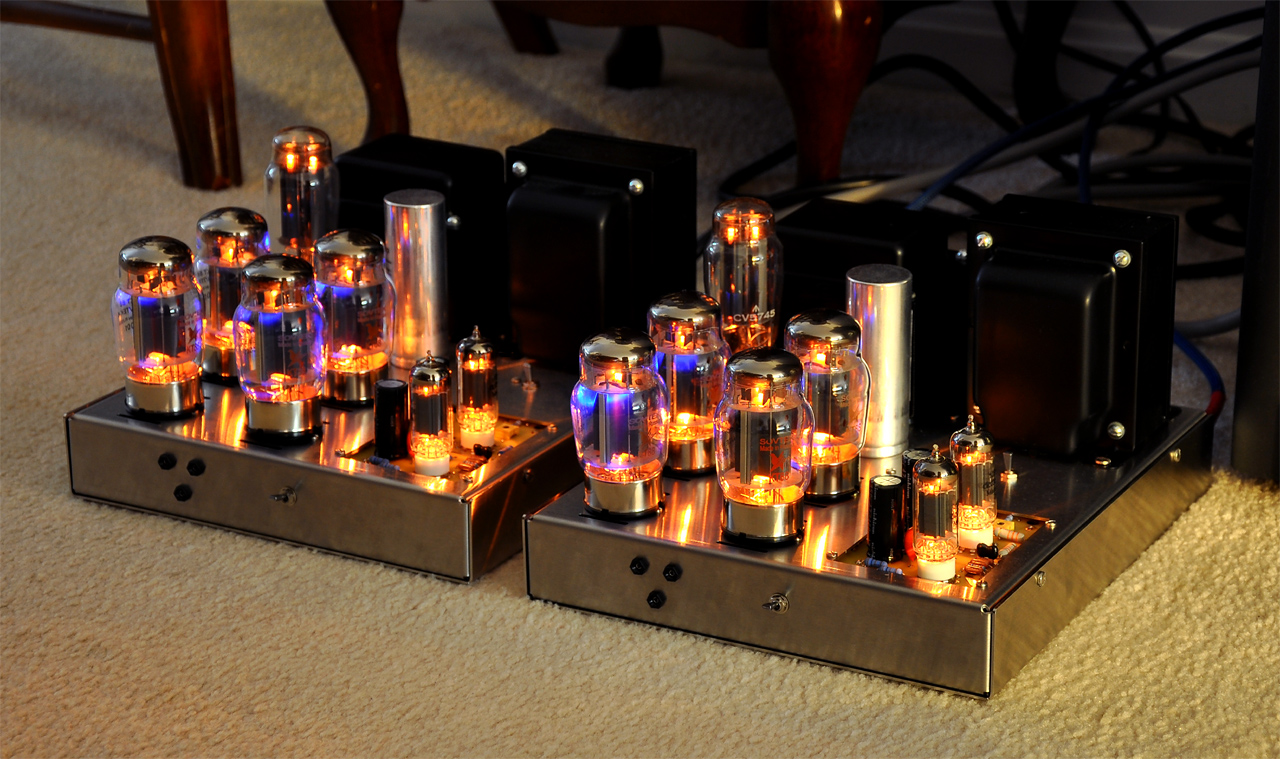

That 16KG6 amplifier works really well, tube can be found in XXKG6 variants. 12AU7 is also plentiful.
Is playing with a friend of mine just fine. There is also a EF86 ECC83 EL84PP i there, dunno if that works, but im pretty confident it will.
I have about 4 more amplifier designs at hand, for bigger power stuff as well. But you'd have to convince me to share the gerbers of those.
