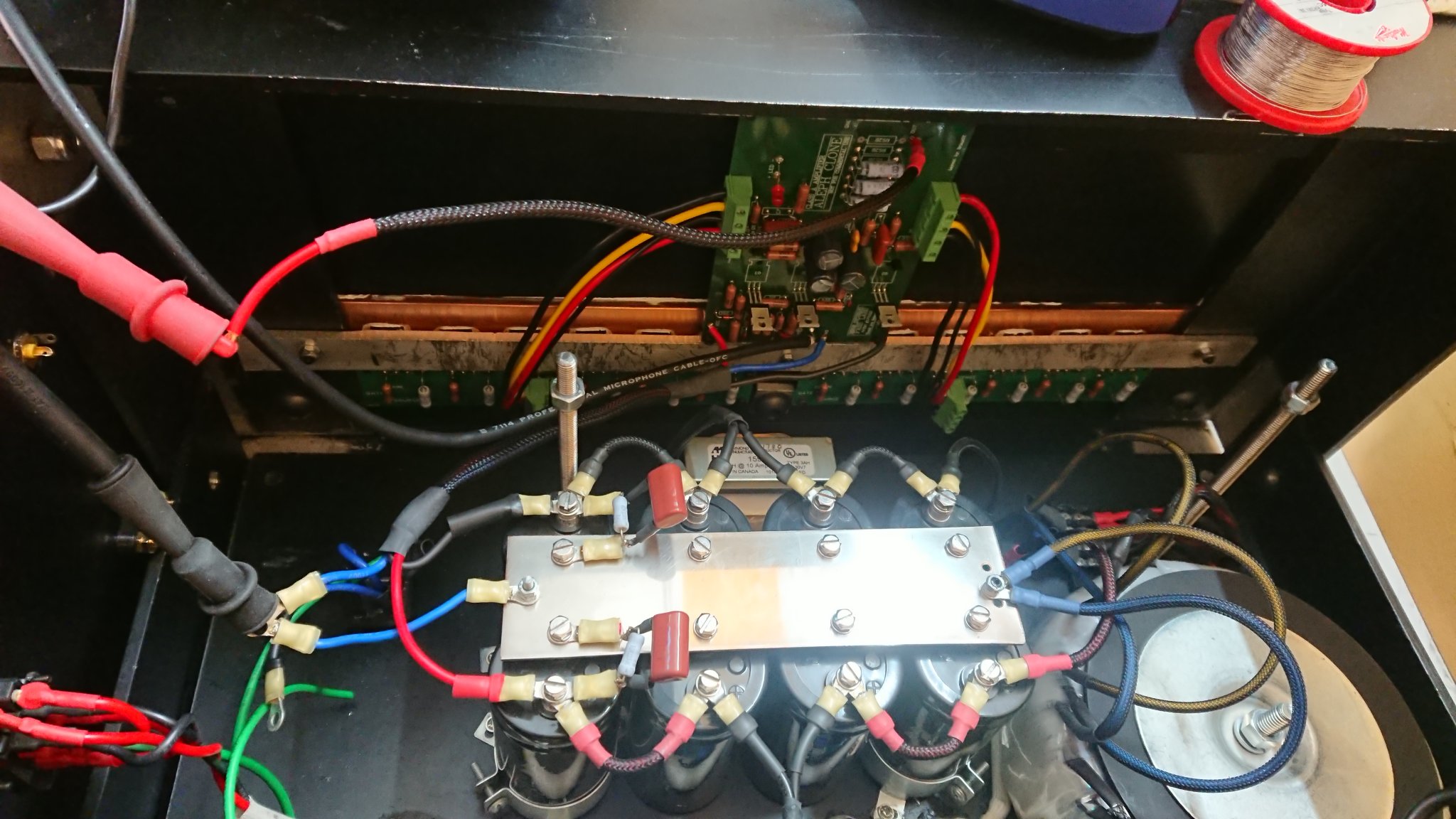

it takes really long time. It's a 3W 10K resistor (two of them connected to each cap). It pulls down but very slowly.

So centre tapped. Four caps per rail but using a 10k. That would take nearly 40 minutes to reach 5 volts.

Another thought would be a DPDT relay (so just a standard relay) held open when the power is on and that closes at power off. You can get them I think with 48 volt coils but if not its only a single series resistor needed. Super simple. A 100 ohm would pull it down in as little as 30 seconds. The relay would have to fed from a separately derived rail of course, otherwise it would still take for ever for the relay to drop out. Still super simple.
Thank you Mooly, can't I use only resistor(no relays) ?
What value and wattage should I use to discharge caps in less time without any I'll effect to audio quality or unnecessary power dissipation when in operation, otherwise I can live with 40min discharge.

Why do you insist using this resistor? You may omit it as well, saving unnessecary power waste all the time. Only before doing some internal works, you discharge manually using one 100Ohm/4W wire wound resistor.

Not really. To discharge that amount of capacitance in a short time takes a low value resistor and that means it dissipates lots of power when running normally.

I'll be adding back LED indicator, keep existing arrangement and keep 100Ohm resistor to discharge manually.

I already have a bleeder resistor 10K 3W, that is what I meant by keeping existing arrangement, it's just that it takes time and I am ok with that after discussion.

I'd anticipate the OP was referring to a secondary side ss amp filter given the LED and series 15k ohm comment in post #9.
Some safety regs called for <60Vdc within 1 minute, and whilst 60Vdc still imposes a safety risk I still use that as a guideline for valve related B+ supplies. I also don't rely on the valves to drain B+ caps, so a bleed is always added, as some maintenance/repair activities can have the valves pulled out, and safety is about mitigation whenever practical. Also with valve amps I would use a bleed to also provide a 100:1 divider to allow external measurement/monitoring (along with output stage bias voltage levels) as a convenient check, and to avoid having to up-end and probe for that information.
The risk for ss amps with large bulk capacitance is not per se the voltage as it reduces below say some 'safe' level of 12-24Vdc, but rather the risk related to the residual energy within an arc should one start probing around.
For ss amps, it is easy to obtain 72Vdc rated PTC that could support connection across a main rail (via a series current limiting resistor). Unfortunately larger ss amps have higher than 72Vdc rails so some extra effort is needed there. However like a LED, a PTC part is not as robust as a power resistor operating within its limits, so there would seem to be a reasonable argument for redundancy even if one was well trained to always measure before starting any repair or maintenance.
