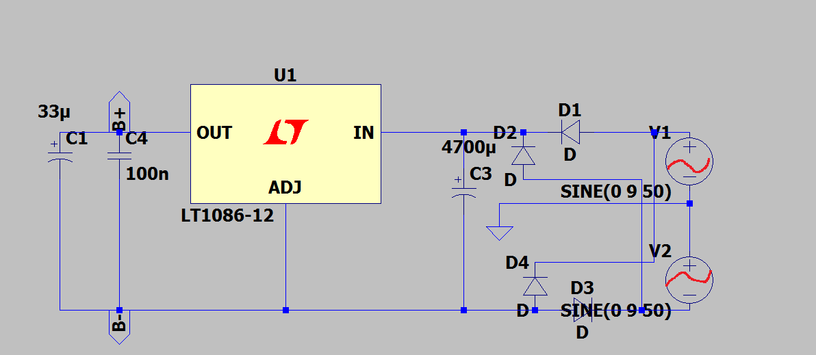

.With just using two bridge rectifiers, one for each secondary, you can make two identical, isolated, filter-and-regulator sections whose outputs can be put in series for symmetrical +/- DC outputs.
... is Mark Johnson’s VRDN something of this? (Asking just so I get an idea of what I’m reading/building. Electronics is to me as much a riddle as it is fun to be in „there“)

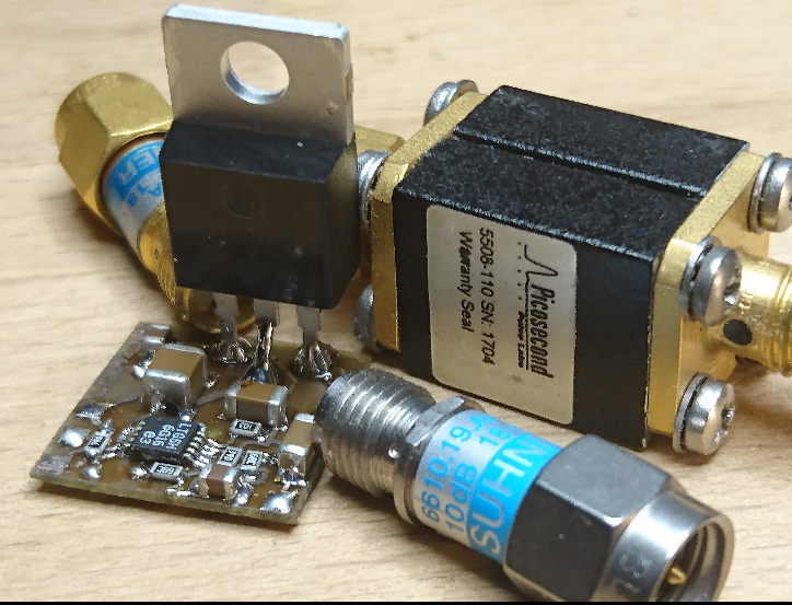

And it does not take JLCPCB to deploy a simple 3042. Such a thing takes
2 hours from layout in the computer to soldering. It just takes a laser printer
with full toner, a sheet of transparent foil, a face tanner as UV source,
a glass plate and a corner of a presensitized board.
It's the circuit from the LT3042 data sheet with the extra pass transistor.
Yes, I would like a TO-220 version of that thing, too.
The coax stuff is only there to keep it from falling over for the photo.

The first glance at the schematic indeed shows two bridges on the two secondaries, but that's about the only thing that's in common with what I was saying. Both regulators use the same "ground plane" connection, thus requiring the different LM317 and LM337 regulators. My idea is to have TWO ground planes (and two identical supplies, rather than the mirror-image schematic requiring different polarity regulator and transistor in each circuit). I was at first thinking have the "ground" connection at the output connections J5 and J6, but no, now I'm thinking not even that. Don't even have a ground connection between the two supplies, it's already at the board that these jacks connect to.

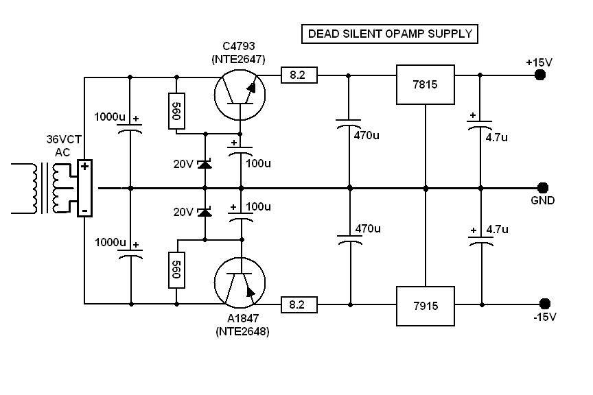

Only thing I can say: if you add a large cap because you think it improves the sound, it will sound better.

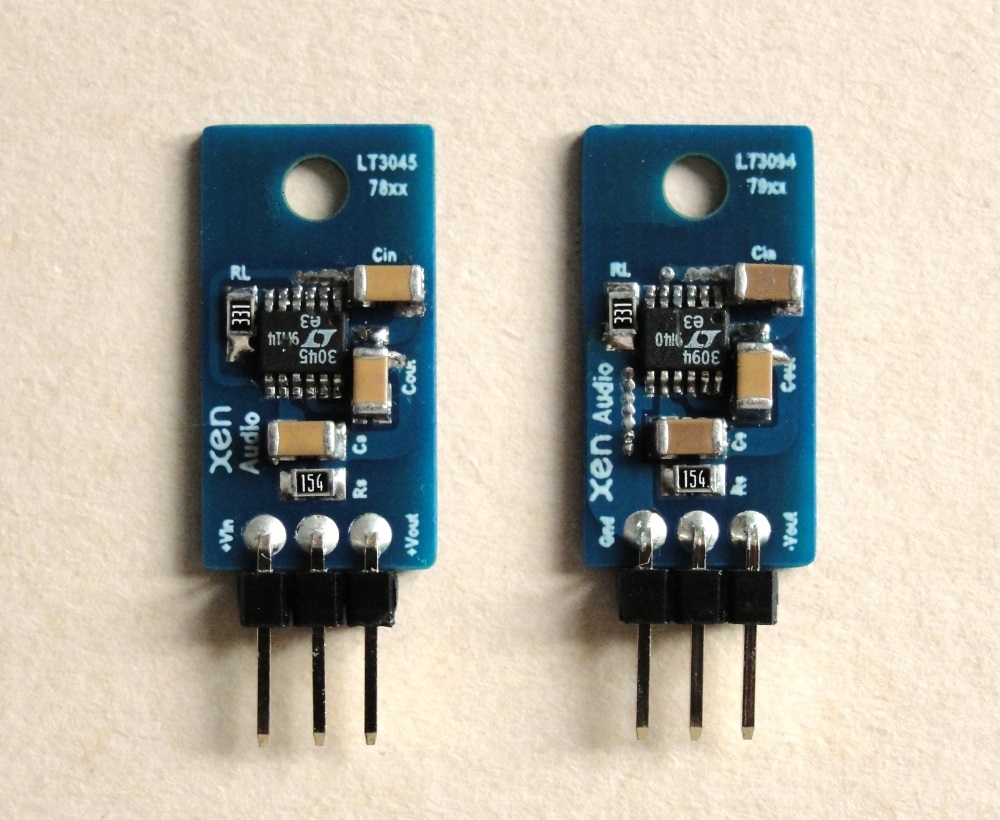

LT3045/3094
When we start discussing what sounds better, it becomes subjective and there is no right or wrong.
Everyone can choose what he believes, like religion.
Like Gerhard, I believe in measurements.
The LT3045/3094 is nothing but impressive, not only in terms of noise level, but also bandwidth.
I tried replicating its working principles with discrete components and got nowhere near.
For high current application such as power amps, I do not need tightly regulated supply.
So 500mA is more than enough fo rme.
You can also make it TO220 compatible.
The only thing is that it does not like a lot of heat.
But a 317/337 prereg will solve that.
And the caps recommended in the datasheet are way better than the normal Murata GRM's.

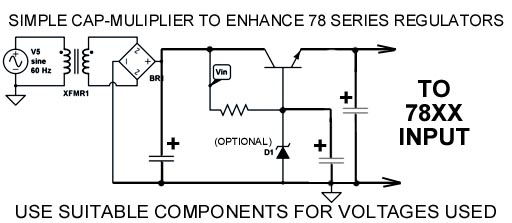

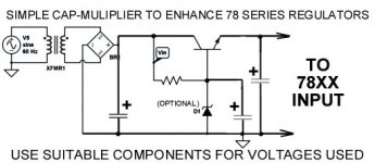

VRDN can be configured as two half-wave rectifiers, one for positive output and another for negative output; this allows the use of an AC wall wart with a single secondary. It also requires two opposite-polarity regulators (an LM317 and an LM337) since the common ground connection is foreordained and unchangeable. There's only one secondary.
On the other hand, when you abandon the feature to operate from a wall wart transformer with a single secondary, and instead require a within-chassis transformer having two independent secondaries, then you obtain the freedom to use two identical regulators, one for positive and the other for negative.
Personally, I'm fond of the idea of an AC wall wart. It keeps the AC mains out of the DIY chassis, which improves safety and reduces DIY chassis size (volume). The barrel jack connector cutout on the rear panel is smaller and far easier to drill, than a rectangular IEC mains inlet. Not surprisingly, both of the DIY headphone amps I exhibited & demonstrated at the 2019 Burning Amp Festival, used AC wall warts plus dual half-wave rectifiers. Attendees who listened to those HPAs ("Azul" and "Rojo"), liked what they heard.

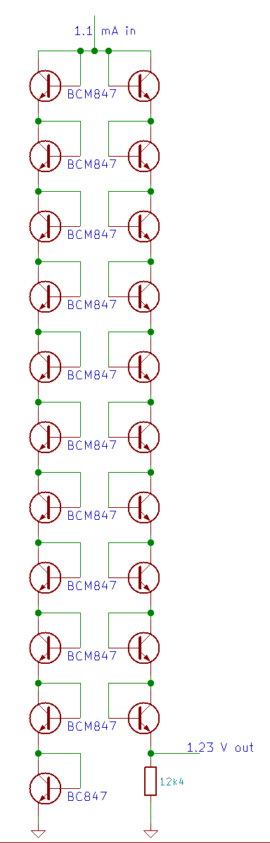

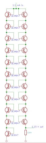

By the way, this is a relatively low-noise bandgap circuit that can be made of discrete dual transistors. It is similar to something that was published in the 1960's, but is almost never used. As drawn here it is relatively sensitive to variations in the input current; the transresistance from input current to output voltage is almost 286 ohm, so a 10 % variation of the input current changes the output voltage by about 31 mV or 2.5 %. A refinement could be to derive the 1.1 mA input current from the 1.23 V output voltage while ensuring the circuit doesn't get stuck at zero current and voltage.
Unluckily, the 78xx may add more noise than the Vbe multiplier
has removed.

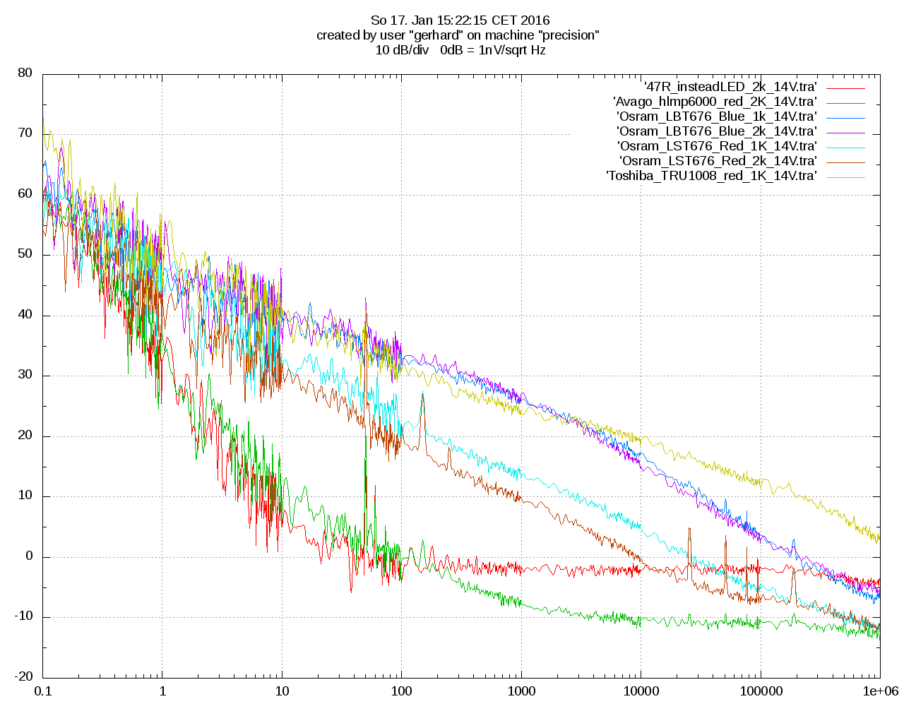

The measurements in #60 have been made with 10*NMH batteries
as the input voltage. These add no visible noise at all. All you see
comes from the regulator.
Those here are measurements of LEDs abused as voltage references.
The LEDs are fed from 14V through a 1 or 2 K wire resistor.
One trace has the diode replaced by 47 Ohms. All you see is the
thermal noise of the 47R, slightly below 0 dB = 1nV/rtHz which
would be the thermal noise of abt. 60 Ohm. Nothing from batteries.
Note the outstanding performance of the HLMP6000. I got that
from someone here, forgot who. I owe him a beer or two 🙂
Optically the HLMP6000 is quite a dim bulb.
My belly feeling is: the brighter a LED is, the more noise it does make.

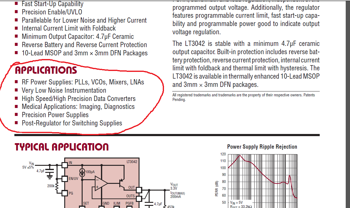

Or maybe we should read the datasheet of circuits like lt3042 exactly how they were written.
I can understand that they can be used for audio too, but....no mention of professional audio in the datasheet in the first place.LT3042 was simply ment for higher purpose ...
