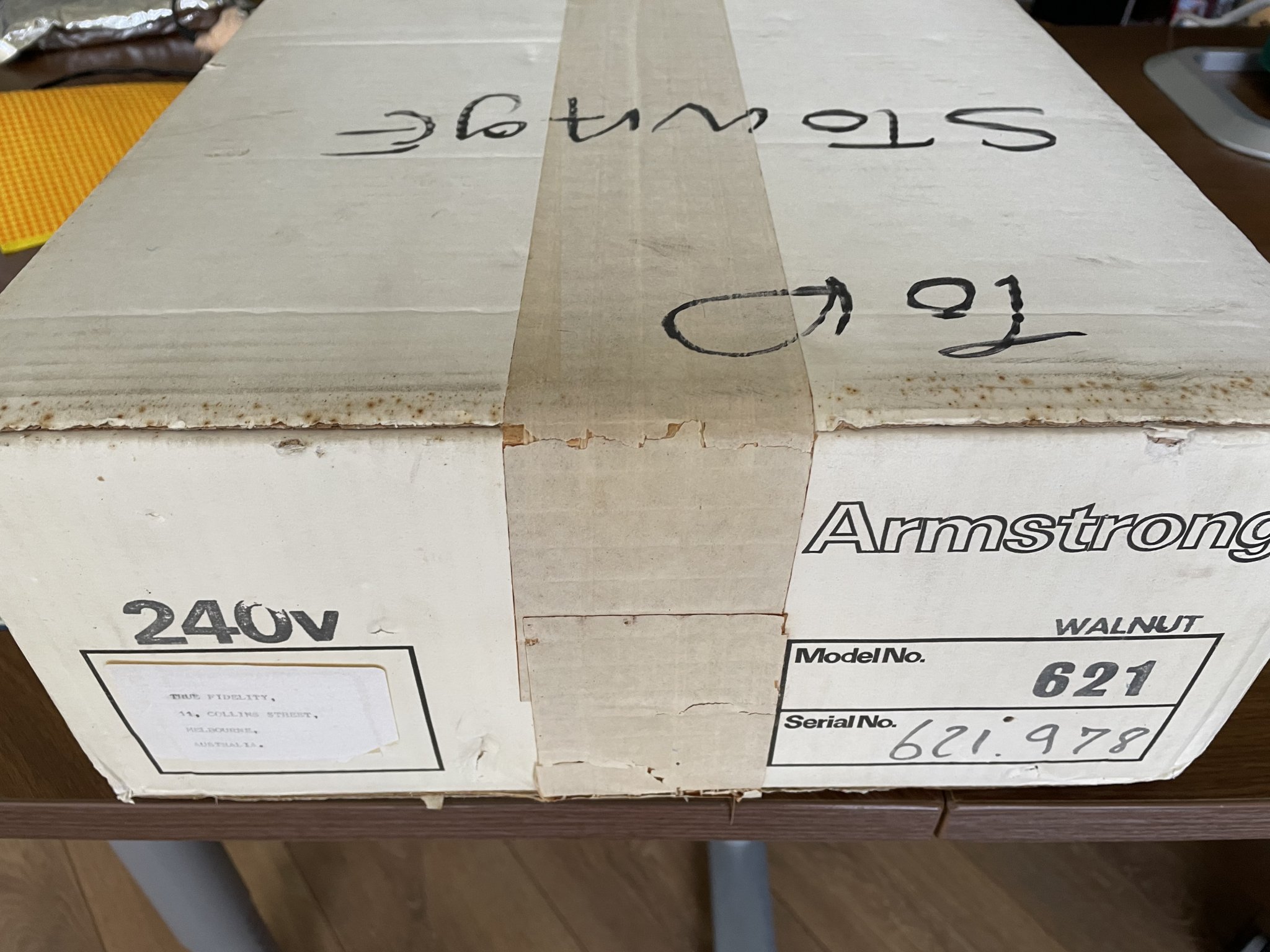

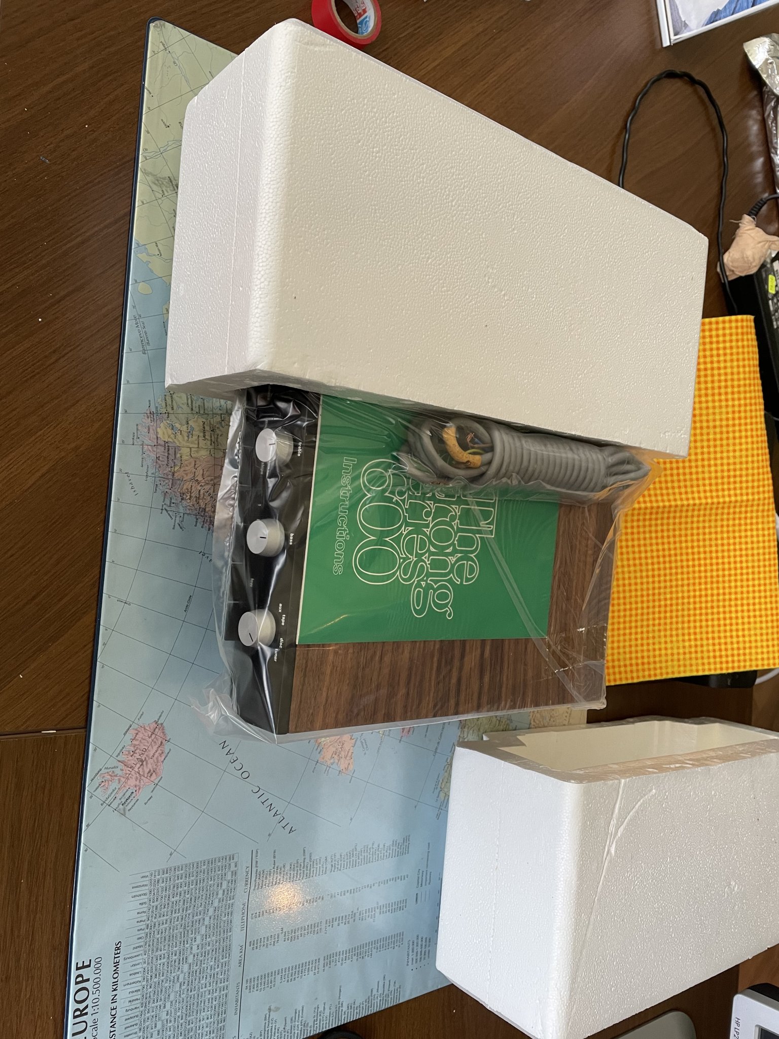

In fact, this last one is a brand new amp, which amazingly waits for 49 years to be opened for the first time today. From Britain to Australia, and finally arrive in Bulgaria to be part of my collection! It sounds just brilliant out of the box! Its so amazing. My question is if I can get some advices from you? What do you think, should I check some parts, which could be important, or should I replace some parts, as long as the amp sounds as good as it shoud be? Im afraid I might damage the unit, since Its been in a box for the 5 decades. Thanks.

I'd just admire a NOS 621 on the shelf. Maybe operate briefly to show friends or something. Germanium transistors were not long life components, just the newest thing on the block in 1962(?) My employer tried germanium drivers briefly mid 60's then went back to vacuum tubes (5221) for rough rider geophysics sine wave generators until ~1976. The data recording trucks used to come in for repair with broken springs, but the tubes would be okay.
Those screw top caps had enough water they probably survived, but the axial lead electrolytic caps I'd give an ESR test before operating at full temperature. Rubber cap seals can crack on the shelf, or not, depending on what grade rubber the manufacturer used. No telling how long the life would be from appearance. A cracked seal cap will work fine for a few hours until the water evaporates out after warm up.

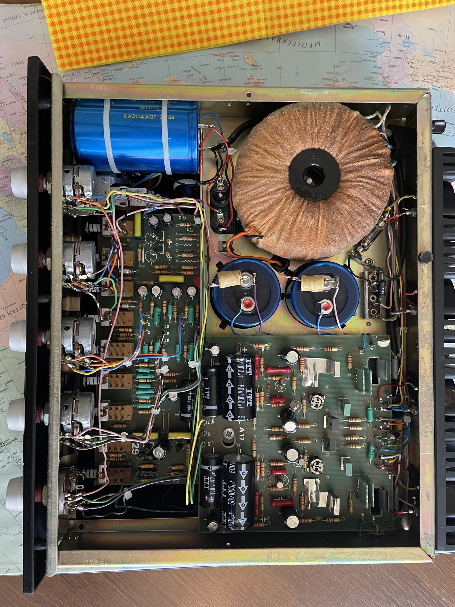

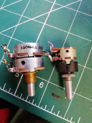

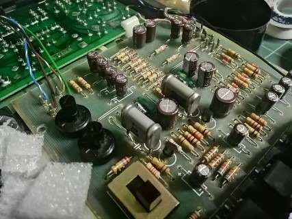

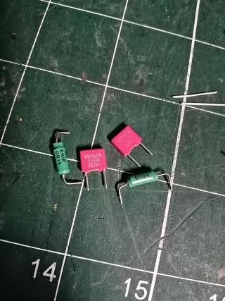

So yes i did infact do a complete rebuild of the 621!
I ended up doing a full electrolytic replacement, i even upgraded the power supply somewhat (part changes).
The 625 i used for spares was the updated and later version which had better parts like the pots (all alps) same with the preamp board, any noisy transistors were replaced with equivalents.
I took all the good parts and rebuilt the 621 and it came out splendidly, i even measured the performance and i have to say it did better than expected.
This has been runninh for a year now with no issues, sounds wonderful and will last another 30 years.

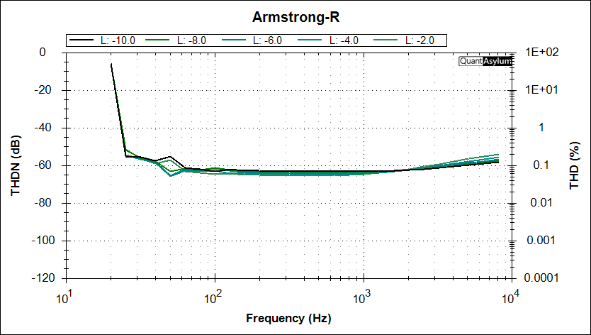

I know this is an old thread but I hope someone may be able to give me some advice. I have a 621 amp which I bought secondhand. After working through and repairing a few silly faults caused by minor component failures, and replacing a couple of noisy small signal transistors I decided to measure the distortion just to see how it compares with more modern equipment and to prove to myself all was in order. And it was terrible 0.5% at 1KHz and 1W. First thing I noticed was that swinging the balance control or unplugging one speaker immediately halved the distortion. So it appeared to be current related. My first thought was that the 0V between the main pcb and the smoothing cap was high resistance. I checked this and all was OK. In the end I detached the front end of the power amp 0V (by cutting the pcb) and connected this directly to the 0V star point. And the problem has gone, in fact the amp measures around 0.01% to 0.005% so very good indeed for such an old design (using the tape monitor input) and roughly in line with SPICE models. So... am I going crazy? Surely no amps would have been sold with this kind of fault and certainly the reviews post circa 0.08% figures of which approx 0.06% is due to the preamp. And finally, if anyone has a spare Armstrong illuminated badge from the front panel (it just clips in) I would be happy to purchase one from them. Thanks!
I have had several conversations with Jim Lesurf over this issue and he has been very kind despite being unwell.

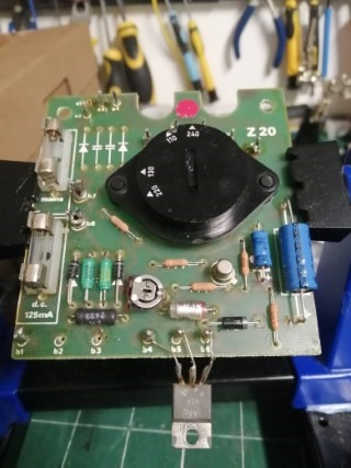

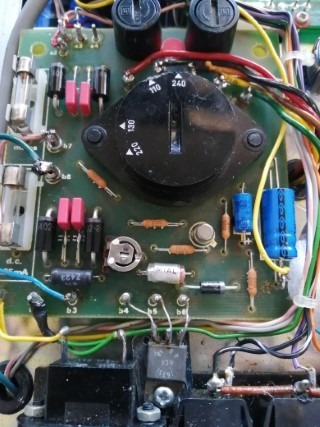

He advised that build standards did vary and much information has been lost, as he joined Armstrong near the end of the 600 series production. Number one candidate is the thermal delay switch which is known to fail frequently and others have commented on. I had checked this early on and it appeared to be working, but I have now removed it and upgraded the rectifiers with little result. The problem IMO is caused by 0v output stage current injecting noise into the power amp from the output stage, This is exacerbated by the lack of decoupling on the power amp pcb and the relatively long power feed.
Love to hear anyone else's comments and theories. But seems this could be a major reason why these old capacitor coupled amps sound different to the later direct coupled amps. Its just more difficult to get rid of 0v related distortion products.
BTW I have no idea how to PM anyone on this forum, or indeed if its turned on for me, So hoping you can contact me! Please let me know.

Hi Indianajo, the amp dates from 1972/3 period so the transistors are not too bad, I replaced a couple of noisy small signal ones. The published distortion was 0.08% in the spec sheet. So pretty good for the time, and the reviews bear this out. The engineers at Armstrong were pretty competent, so I was surprised when 'my' amp showed such high figures and that the position of the balance control (or disconnecting one speaker) made such a drastic difference.. I agree that AC/DC coupling should not make much difference in itself, but I had not considered the 0V noise issues before. My solution works fine BUT I can't believe the amps were sold like this, hence my post, as I felt I might be missing something. Thank you for your interest!
