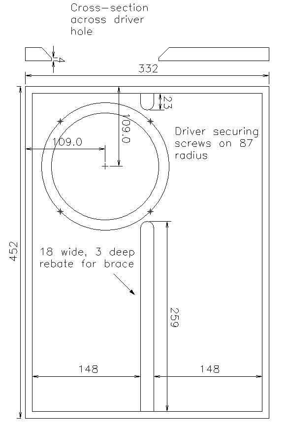

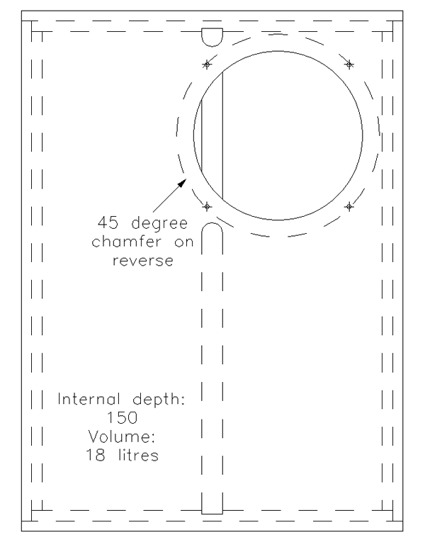

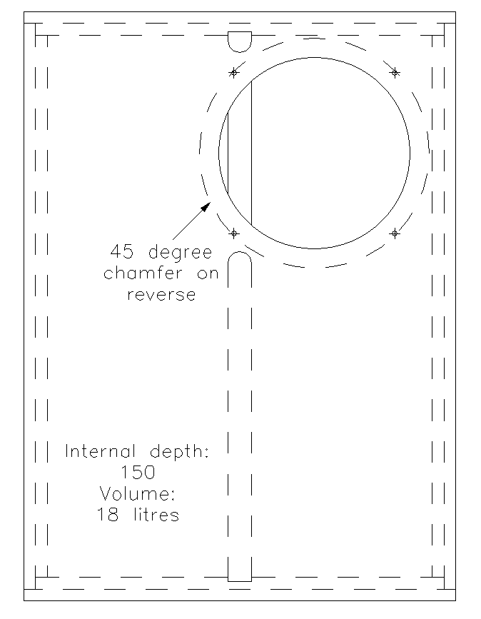

I've studied Mr Morgan's great article and arrived at a volume of 17.32 L and Fe of 83.63hz.
I'm looking for some advice concerning the zobel and output impedance from the experts out there. It seems like i am on the right track?

Thanks ( I think ). I didn't really understand your reply. I take it the design for the CGR ( is that the shape of the box? I will have to swot up on topology ) is commercially protected?
The centre speaker design you posted has an internal volume of about 14 litres which is a bit less than the 16 litres I calculated for the FF165WK.
A Classic Golden Ratio box is one with dimensions really close to 1.618:1:(1/1.618), 1.618 being th efirst digits of the Golden Ratio.
All of the miniOnken designs use an alignment developed by us and typically a driver will have boxes doen for trapezoidal (8 sided in the end), the rectangular full-on miniOnkens with the slot vents down the side as in a traditional Onken, the CGR, often a centre, and if the box is large enuff, a Compact FloorStander (CFS), if small enuff a millSize box.and often other shapes to meet the needs of users.
The CGR (small one in the case of FF165) is typically free for use, the cente if the driver is also used in a Frugel-Horn. Full plansets are typically $25 USD.
The small box is 13 litres, the large one 17 litres. The larger one is the optimim size for the miniOnken alignment, goes a bit deeper with a less contrained bottom end. It wuld be easy enuff to take, for instance Dr. Scott’s Woden box for A10.3/p and adjust the vent (and mounting details).

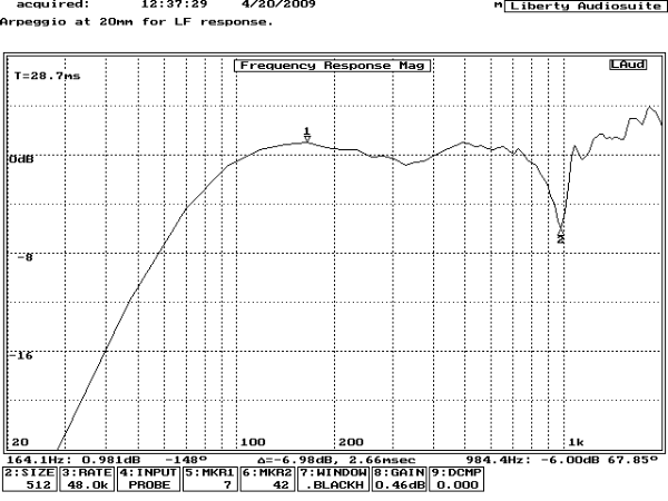

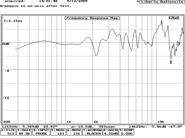

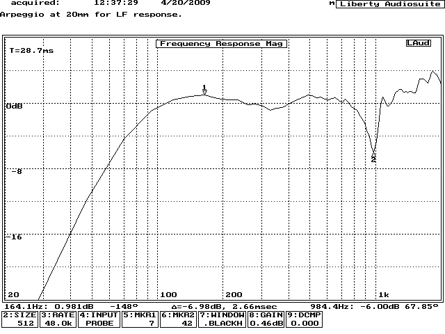

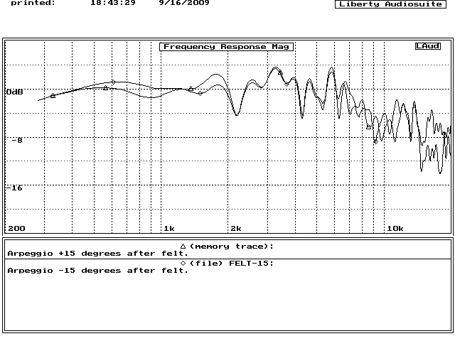

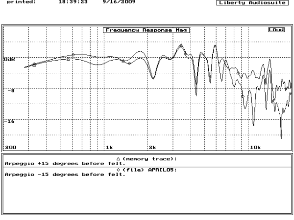

Just talked to the Arpeggio designer, Morgan Jones. His take:
Good news for your Arpeggio enquirer. I looked up the Thiele-Small parameters for the FE166NV and expected to need to reduce cabinet volume because of the reduced VAS. However, the BL factor has also fallen, and it turns out that the two cancel one another out and the required volume is exactly the same as before. He'll have to experiment to get the Zobel network right, but other than that, the FE166NV (non-vintage?) is a drop-in replacement and should work just fine.
Jan
Jan

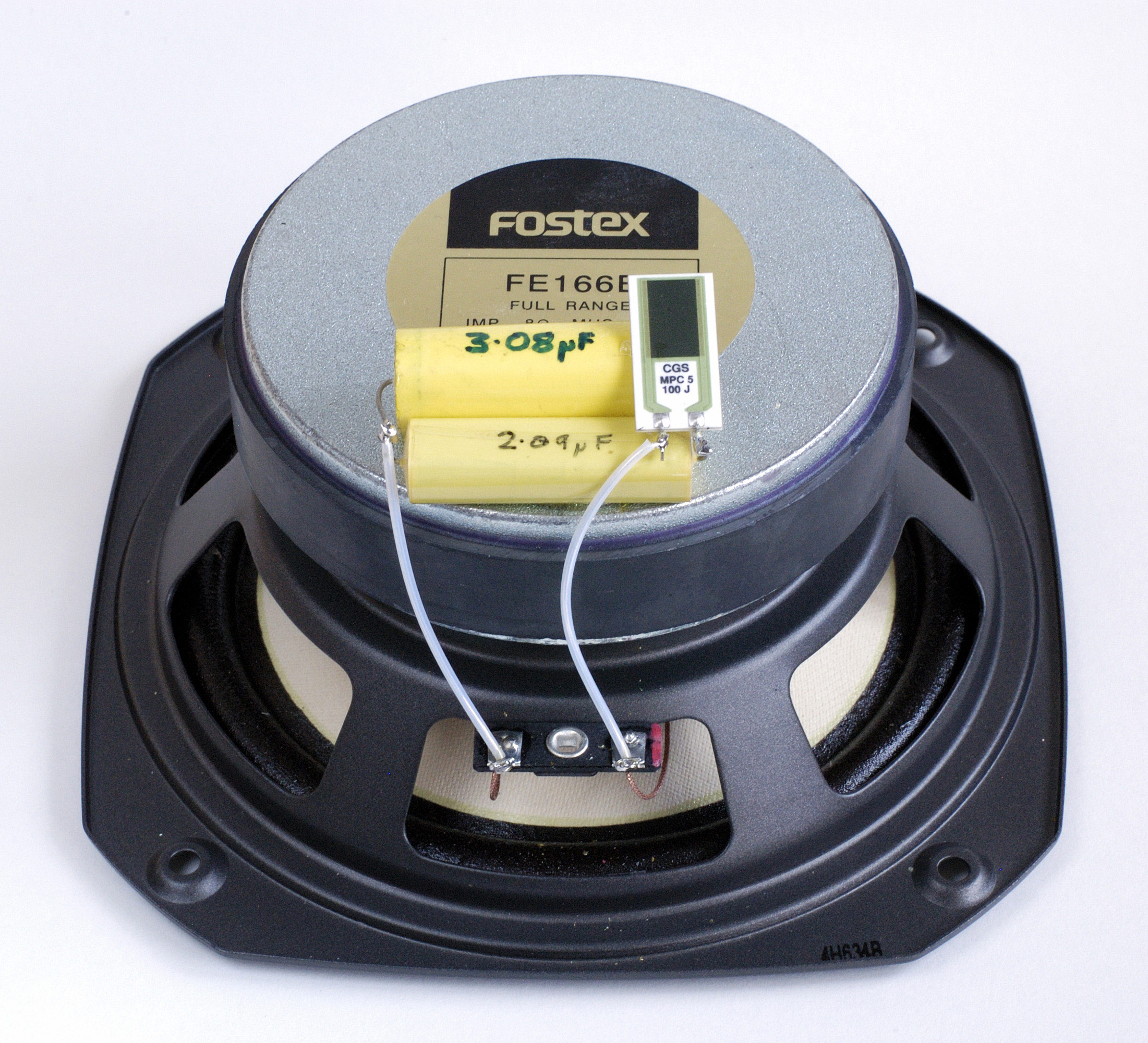

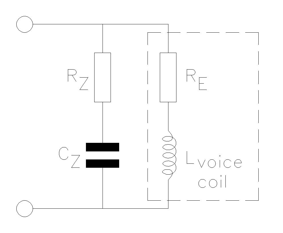

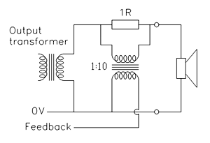

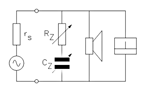

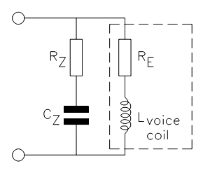

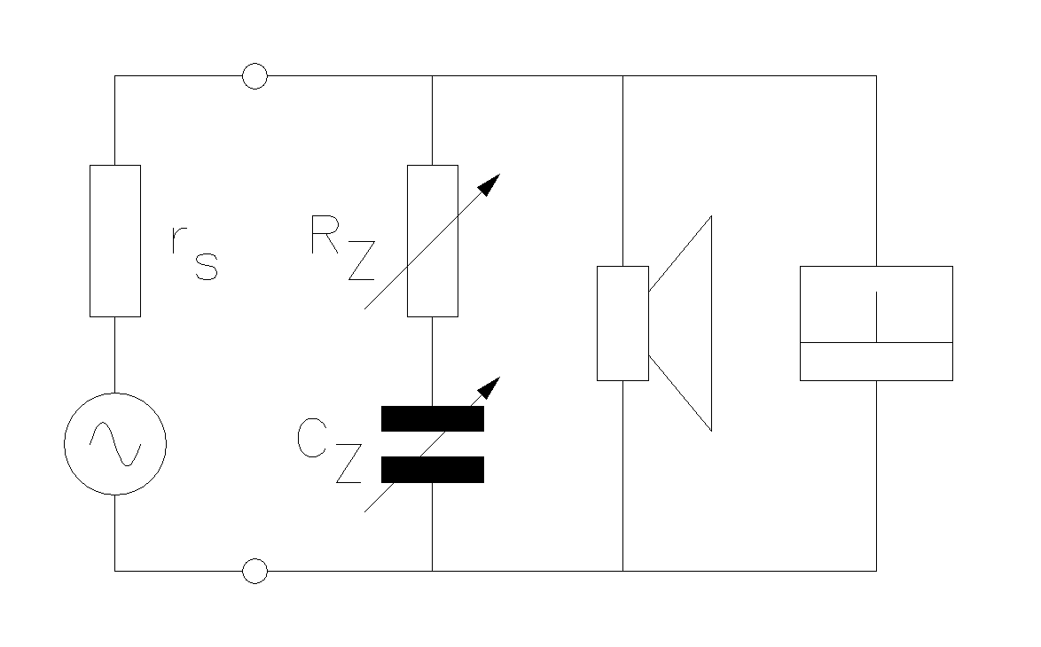

Has anyone experience with using this driver?
If so may I seek advice on the Zobel values?
I seem to have arrived at RZ = 6.8 ohms and C2 at 1.35uF but that does not seem correct.
Not me, but assuming the published [or someone's measured] impedance is ~typical, then: https://www.diyaudio.com/forums/multi-way/54349-zobel-calcs-crazy.html#post607076
