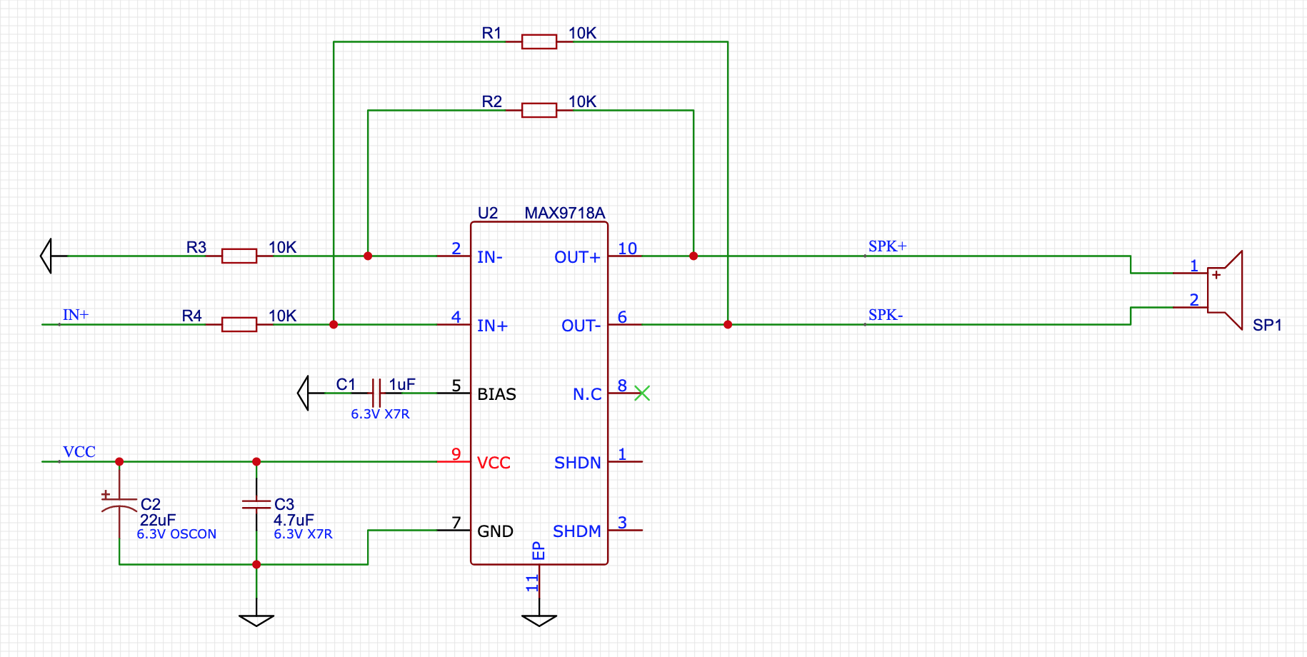

For this project I'll be using 40 pcs of micro speaker (102dB@10cm) spaced at 9.1mm C-t-C to emulate a ribbon.
The "ribbon" will be mounted to the throat of a custom ATH4 horn flare. I will use an 8PR200 for bass.
To improve the vertical wavefront / directivity I will add active shading to each speaker or group of speakers.
Each micro speaker will be driven by its own MAX9718A amplifier.
https://www.mouser.co.uk/ProductDetail/Maxim-Integrated/MAX9718AETB+T?qs=1THa7WoU59FvOsgrnnj7bg==
It will be straight forward to taper the levels vertically as the MAX9718A exposes adjustable gain.
For delay I may try wrapping the appropriate allpass/bandpass around the MAX9718A or alternatively use a few LME49721.
More to follow.

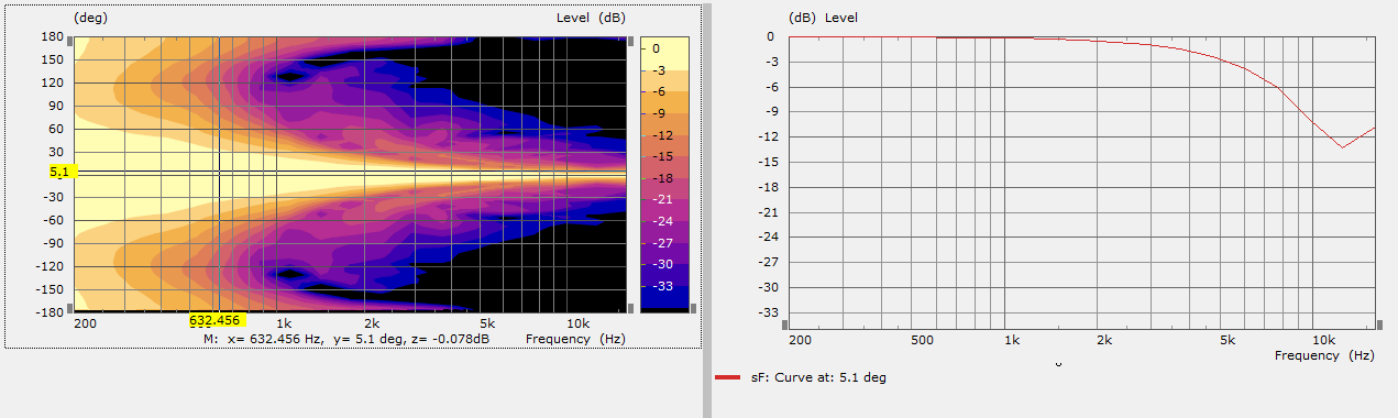

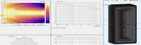

polars
horiz at 45deg no shading
vert at 5deg no shading

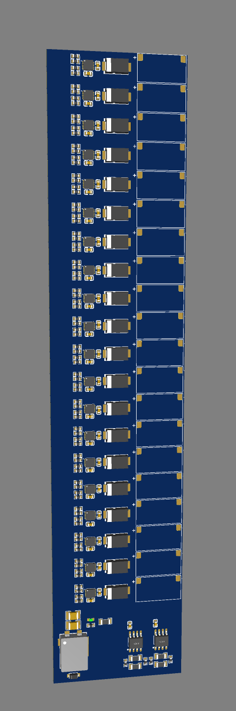

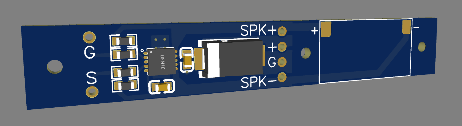

test board

![1667691960858.png 1667691960858.png](https://www.diyaudio.com/community/data/attachments/1014/1014525-d2ea7525d0dca99fee456fa610292597.jpg)
polars
![1667692005335.png 1667692005335.png](https://www.diyaudio.com/community/data/attachments/1014/1014526-66ce18794f9cf886682b9440a6c511e6.jpg)
![1667692151553.png 1667692151553.png](https://www.diyaudio.com/community/data/attachments/1014/1014529-bb95feed671541d23a8ddfd924f5b350.jpg)
![1667692181424.png 1667692181424.png](https://www.diyaudio.com/community/data/attachments/1014/1014530-4c4e7675935425a9aeca6a3de26b56e2.jpg)
test board
![1667692443484.png 1667692443484.png](https://www.diyaudio.com/community/data/attachments/1014/1014533-59ff4153c607c9fa0db4f35371975af4.jpg)

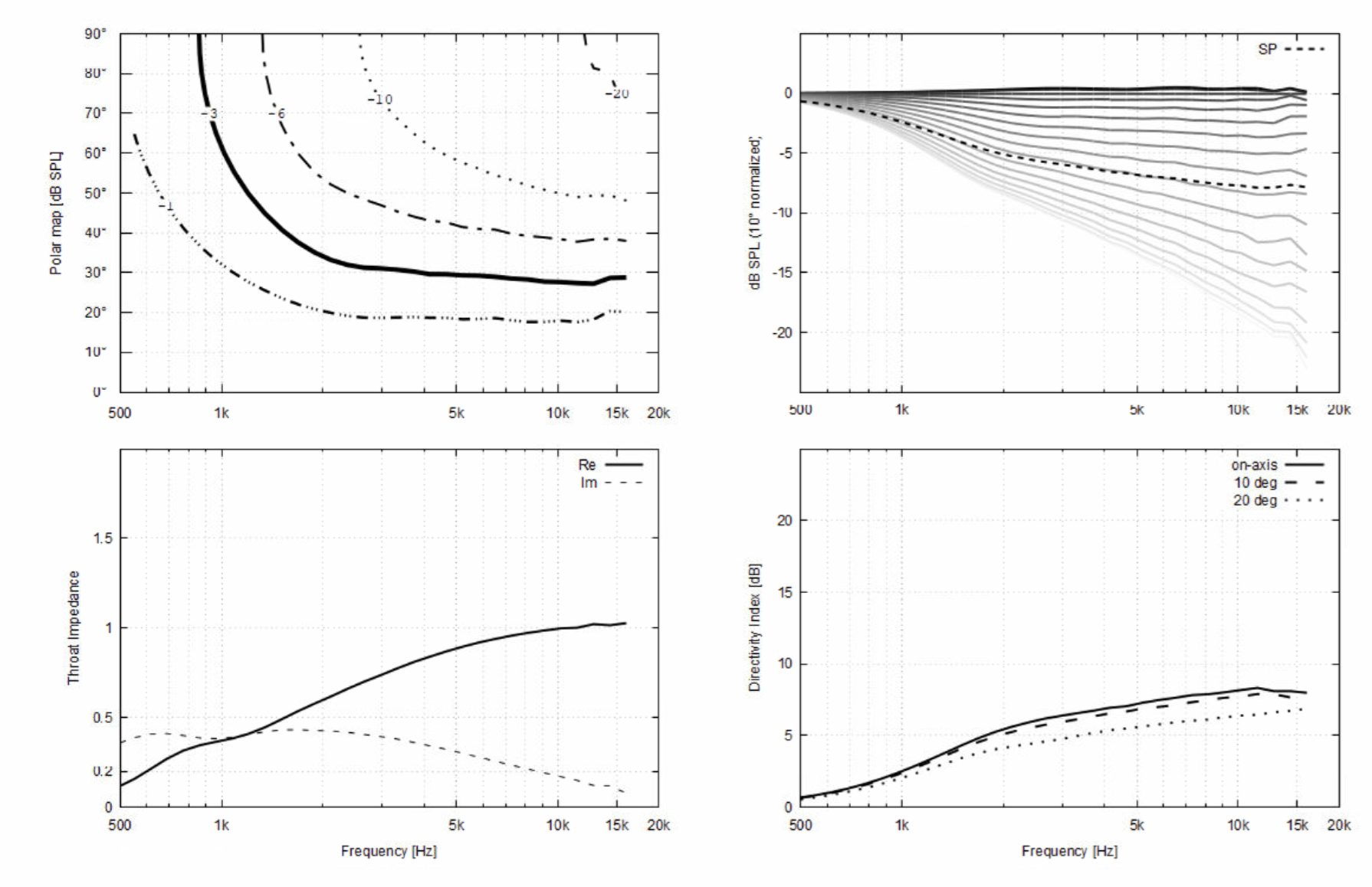

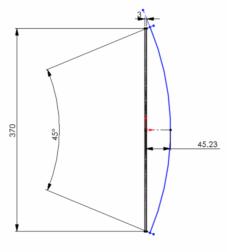

I'm not sure I need that amount of delay. I think i just need to electrically delay the wave front to exit perpendicular to the top and bottom surfaces. In this case roughly 45mm or 130us. I may well be wrong.
![1667740412871.png 1667740412871.png](https://www.diyaudio.com/community/data/attachments/1014/1014687-89c61cc8e2e288b6d2df6f1393732cae.jpg)

Almost finished the 20 speaker "ribbon emulator"
I'll put the speakers on the rear of the board. This will end up 25mm x 210mm.
The large unit at the bottom is a BNX027 EMI filter
https://www.mouser.co.uk/datasheet/2/281/QNFH9101-1131754.pdf
I have a few from a previous project. They work well.
The two LME49721 form a HP high pass and buffer.

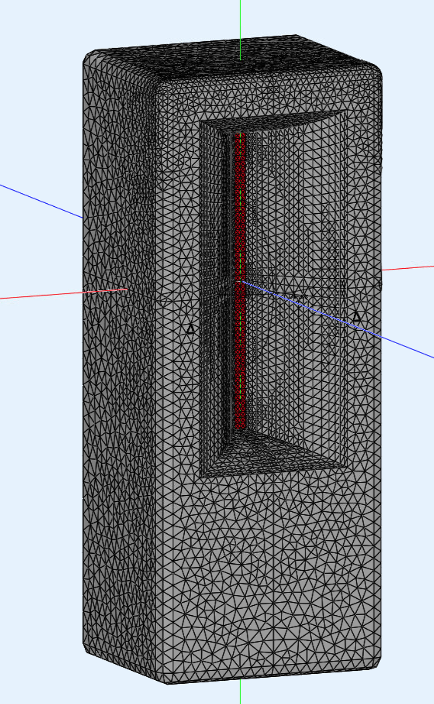

It would be interesting to simulate the actual driver size and spacing to see how closely it resembles a single source, to what frequency.Yes, 25mm x 210mm should be OK.
My ASUS laptops have speakers that look quite similar in shape.
It is quite simple in AKABAK or ABEC (Not in Ath) to see the difference between a solid radiator diaphragm and one composed of separate parts with gaps in between. These may be small enough to be irrelevant but sometimes things don't work out the way you imagine.If we say the effective dia is 7mm, will start to beam I think at
f = (2 * 343) / (3.14 * 0.007) = 31.2kHz
Maybe, when looking at directivity it isn't really necessary. If you know the size of the speaker radiating element and the gap in between I can check for you to see if it has any effect. If it did the diaphragm mesh could be changed in the ABEC sim without too much trouble.
