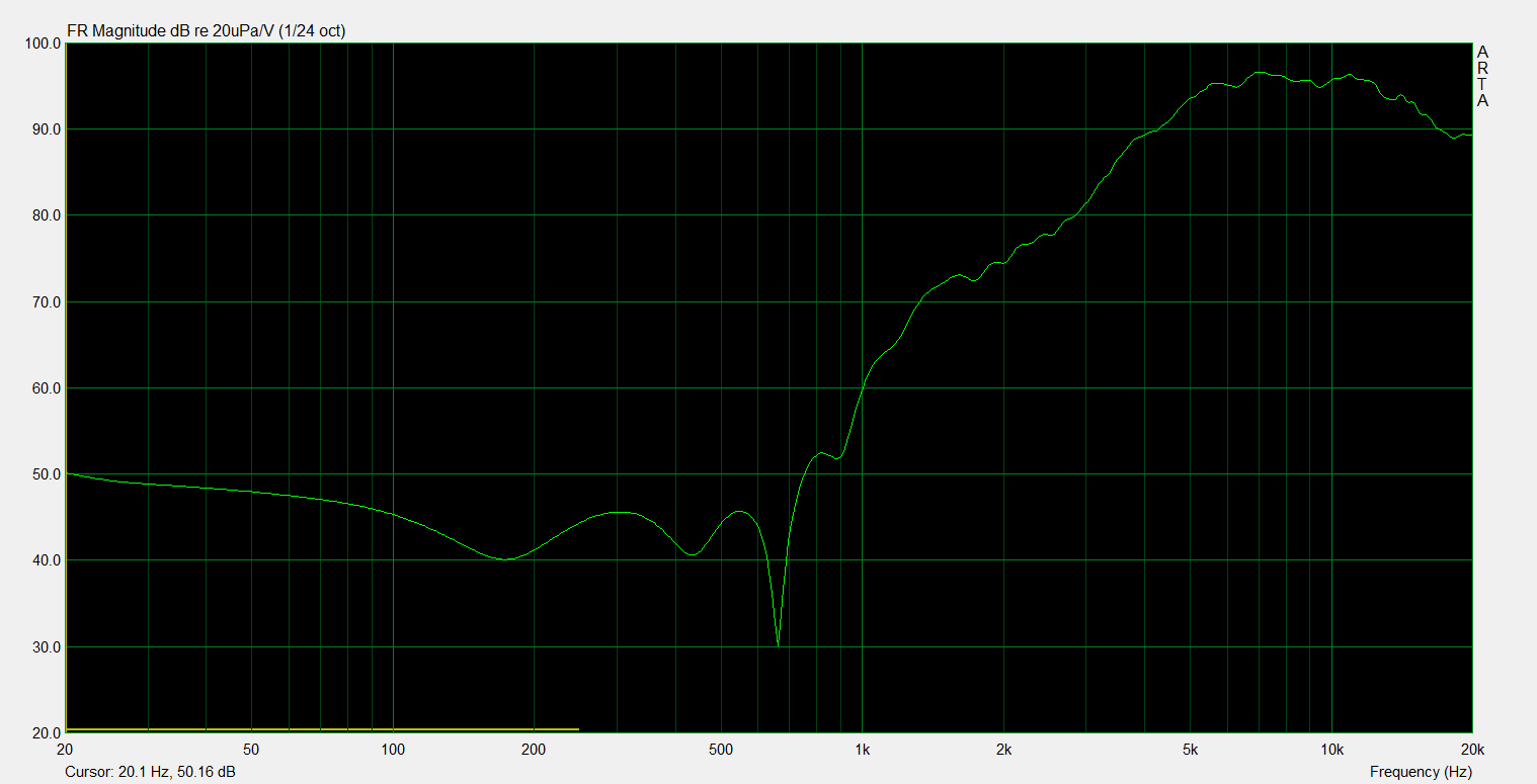

Hopefully you can help me with a problem I'm having with two channel measurement mode in ARTA. There seems to be some sort of bug causing inconsistent results.
Scenario: I am measuring a ribbon tweeter which cannot safely be measured without at least a 12dB/oct high pass filter. My idea is to use Dual Channel mode to cancel out the response effect of the 4Khz high pass filter (at least for a couple of octaves) so I can get a valid amplitude and phase response down to 1Khz to use in XSim modelling.
However this does not seem to work reliably due to incorrect impulse measurement and I cannot find out why. Here is a single channel measurement of the microphone on the left channel showing the tweeter acoustic response with high pass filter:

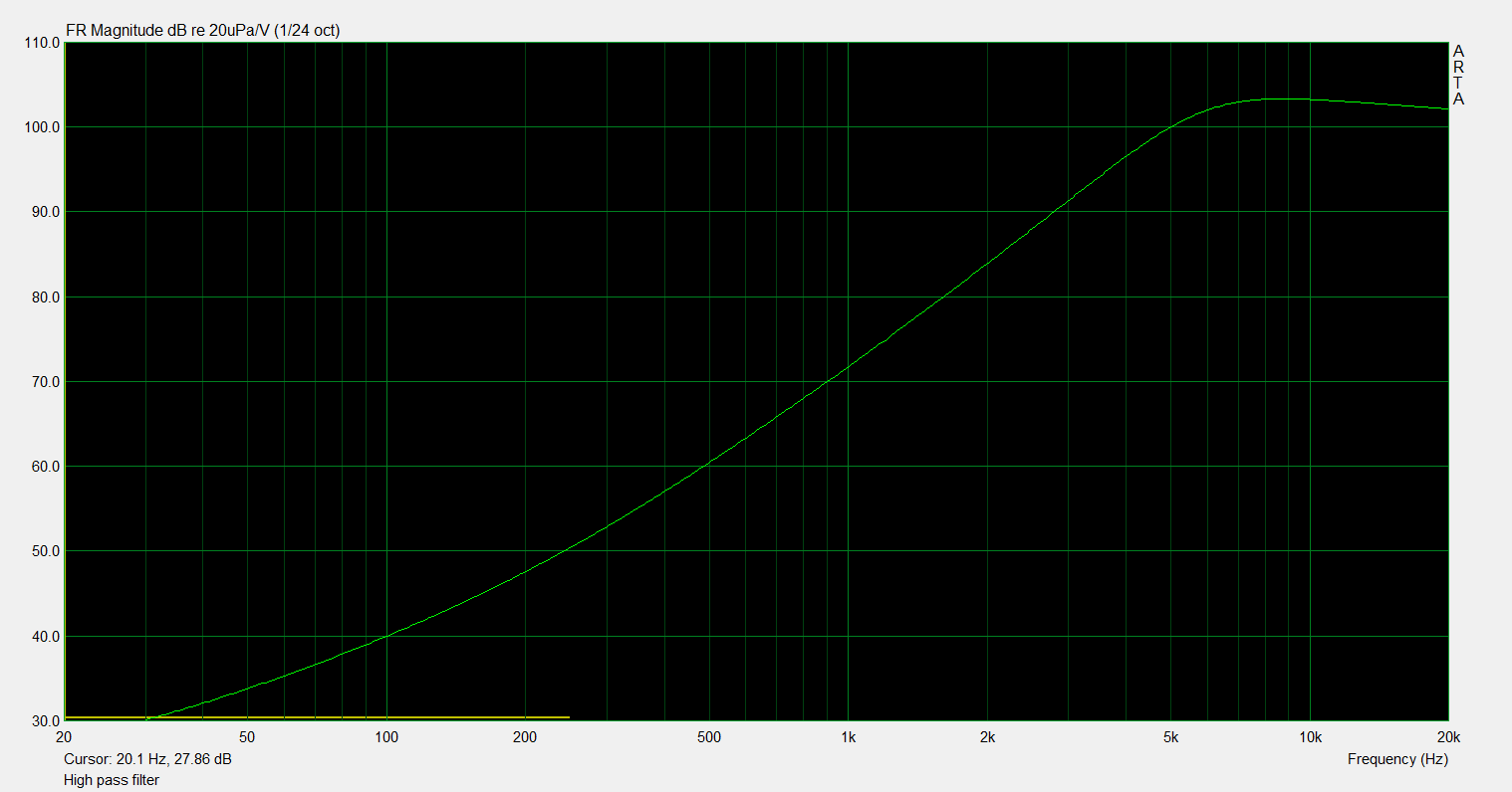

Here is a single channel measurement of the electrical high pass filter on the right input channel:
attachment.php

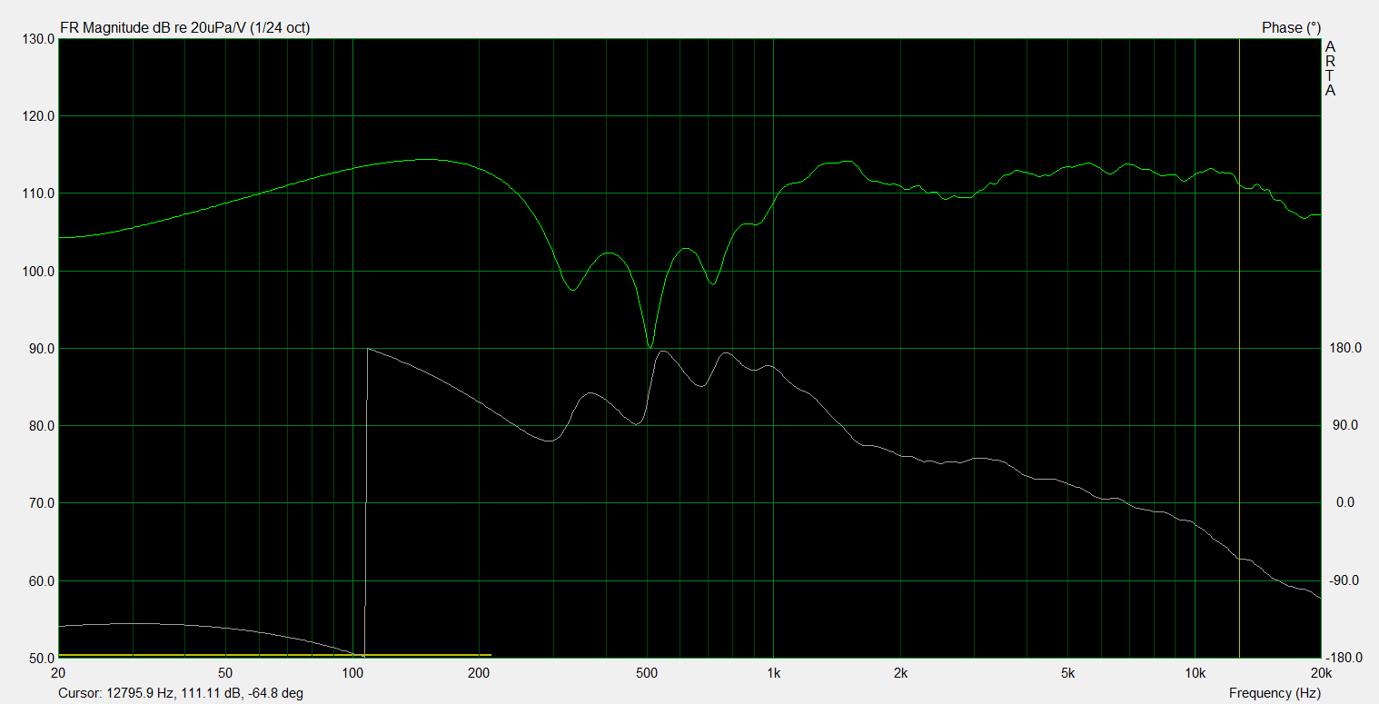

Here is a dual channel measurement taken with the Microphone in left and the direct electrical response of the high pass filter in the right channel:
attachment.php
This is exactly what I would hope to see, with valid data down to about 1Khz, and I would like to export this as FRD to use in XSim.

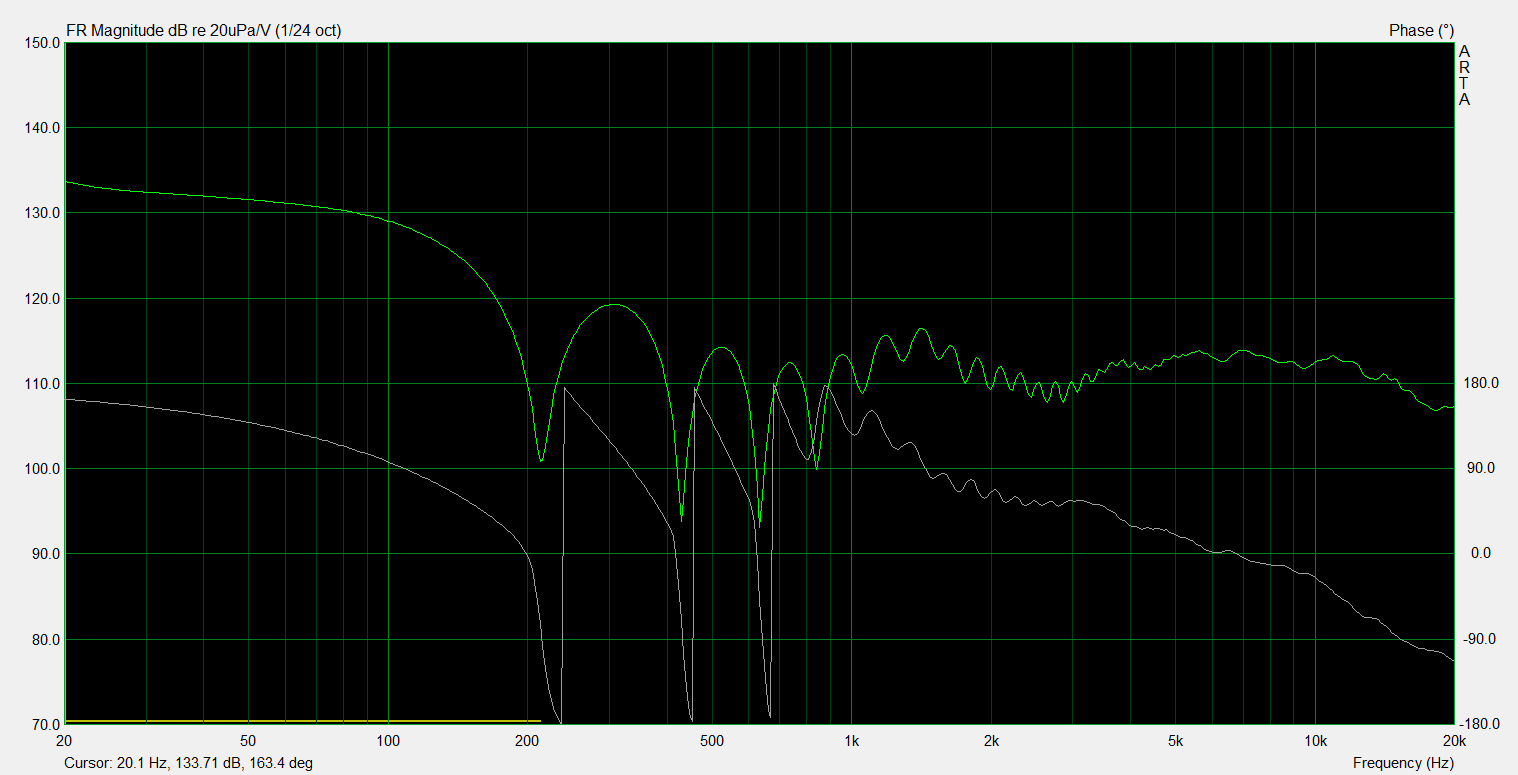

However if I try to repeat the exact same measurement without changing any settings I now get this:
attachment.php

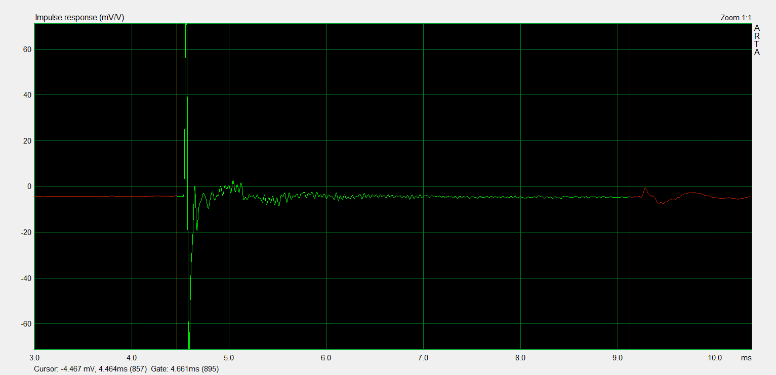

As you can see, the measurement is useless. When I compare the PIR of the good and bad measurement the difference seems to be DC bias in the impulse response. Here is the bad impulse belonging to the bad frequency response above:
attachment.php
As you can see it has a negative DC offset. (But the offset changes at random with each measurement)

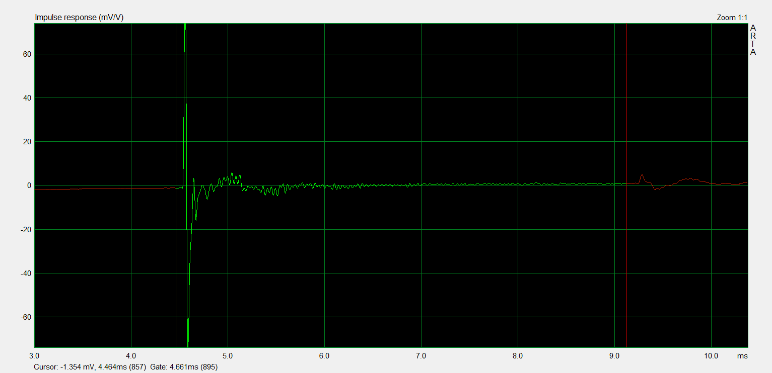

Here is the good impulse - the only difference seems to be the DC offset:
attachment.php
Is there anything that can be done to work around this ? At the moment I have my measurement environment set up but I am stuck as I cannot get a reliable reproducible response for the tweeters.
That does not work, because at low frequencies there will be no signal in both microphone and loopback input, except for noise. So you have almost zero signal to noise ratio at low frequencies and ARTA still tries to calculate the impulse response from that information.
All speakers have near zero output at very low frequencies, so if this was the case then the dual channel measurement mode would be useless for any acoustic measurements...
I tried changing the high pass filter to a shelving function which shelved down at 12dB/oct and leveled out at about -40dB to increase the low frequencies available for analysis in the loopback signal but I still see the same problem.
If I repeat the measurement process many times, about 1 in every 20 tries I get a perfect result, and the others I get various random DC offsets in the impulse response which cause various response anomalies.
It seems that in dual channel mode if the loopback signal deviates from a flat response by more than about 20-30dB at low frequencies a stable impulse response without a DC offset cannot be generated, even though the low frequency signal is still about 60dB above the noise floor at that point.
I still think this is a bug, as there is still sufficient signal available at low frequencies. If the loop-back signal is near a flat response there is no issue.

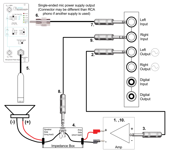

Here is the wiring diagram here,maybe my suggestion above will give you some hints for improvement of your software.Thanks for your advice and consideration.
