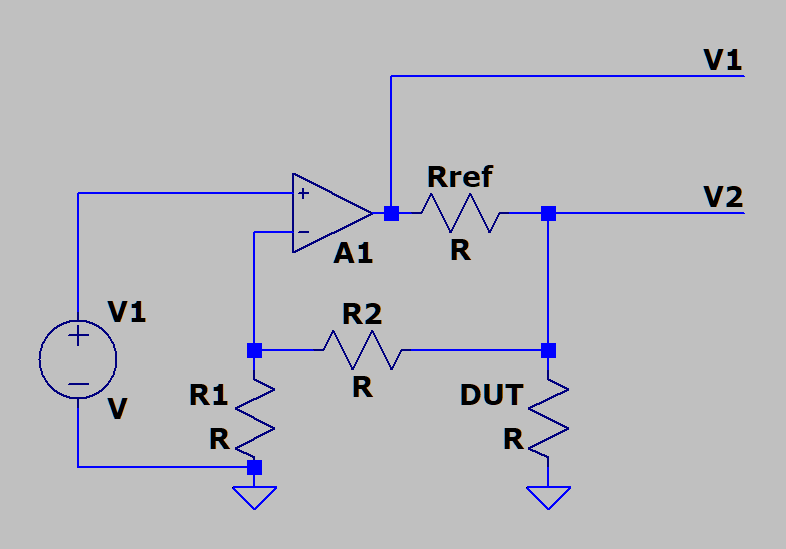

Here a global schematic with a constant voltage source with ref resistor.
Crossovers etc are not part of this story, since they are obviously the DUT.

For a more constant voltage across the driver you need the lowest possible sense resistor and a source with very low output impedance (i.e. an amplifier).
Yeah, some days my brain just ain't right. Low value sense resistor, constant voltage. High value sense resistor, constant current. However, very small sense resistor will make for smaller measurement amplitude, so decreased resolution unless signal is fairly large.
I don't understand the benefit of placing a resistor inside the feedback loop of the amplifier, and I've no interest in building a special amplifier just for measuring impedance and T/S. In any case, high value sense resistor may make more sense to provide a signal to the driver that is closer to what it will see when directly connected to the amp. I'll see if I have anything lying around, can always do a quick comparison of small sense R to large sense R if there is any meaningful difference in measured results.

The divider network isn't a constant voltage source, very far from it actually.
The benefit of placing the resistor inside the voltage loop will provide a constant voltage on the speaker terminals.
Yet, still give the option of measuring it ARTA (LIMP) as before.

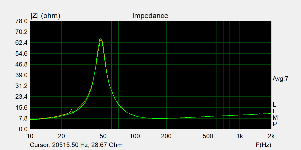

If it interests anyone, the difference in impedance sweep result between using a 10 ohm sense resistor and 190 ohm sense resistor is pretty much zilch. If anything, very small increase in the impedance peak amplitude, so it wil have very slightly lower Qms at 10 ohm test, but not enough to care about, certainly no change in Fs given about the same signal amplitude. So I'm just going to keep on with my 10 ohm voltage divider method.
Too many people focus on comparing their measurement to the datasheet, with exclamations that the manufacturer has given them a dud, the datasheet is wrong, etc...but without comparing the resulting cabinet model, or understanding of what difference in T/S parameters means. Last time I saw these claims, I did this person a favour and modelled the driver in a cabinet using his measurement vs the datasheet. Result clearly showed the driver was performing perfectly as advertised.
In any case, this is going a bit OT for ARTA/LIMP discussion, as the program can accommodate whatever testing method you wish.
Would it matter PN or sine ? Voltage is voltage 🙂
Here's comparison of stepped sine, yellow = 10 ohm, green = 190 ohm, never mind the wiggle at 25Hz that was my fault, otherwise I would say the difference is not enough to care about.

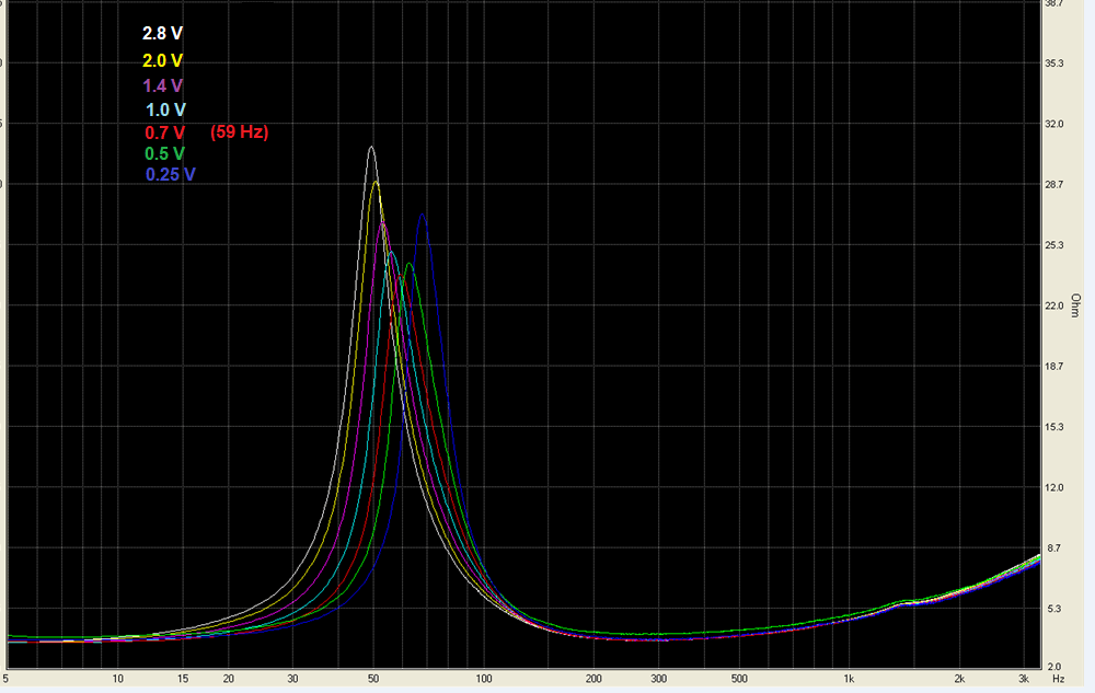

Simple comparison of different drive voltage. Here, a cheap 3" TB fullrange driver was used, no copper in the motor I am sure.
Measured complete T/S using 250mV drive voltage, and again at 1.5V, using voltage divider and 10 ohm resistor.
At elevated voltage, Fs is indeed lower, nearly 5Hz difference, as well Qts is lower, Cms higher, Vas higher, BL slightly lower. End result, cabinet simulation is pretty much exactly the same. Although, the T/S parameters at elevated voltage may look more favourable on a datasheet.

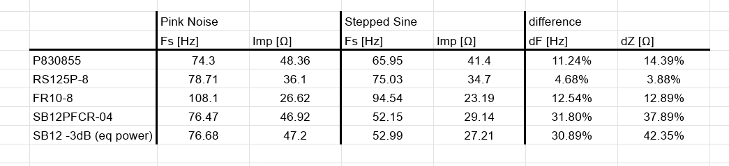

Here you can see a table with a couple of 4 inch woofers I tested a while ago.
Plus a measurements of a VERY reputable and respected brand (can't exactly tell which one unfortunately, I wish I could)
What does it show us?
Well how linear the speaker is really, (or the compliance)
In case of the speaker of the manufacture, this was actually VERY audible when the speaker was being played at small signal levels (a little more than just background music).
Klippel measurements aren't available, yet people still want to create nice speaker projects (for whatever reason).
In this case, someone was heavily disappointing by the outcome.
I say it again, it's NOT just about T/S parameters (which you keep referring back to).
It's all about getting useful data to get predictable results.
Showing a very well made speaker with some quick and dirty measurements is kind of showing the obviously.
Even more so when Klippel measurements are known and show they are super linear.
Why would you do a measurement in the first place?
Seen in the table is the Fs, with the impedance peak (I could have given the Qts, which is proportional to) from a PN signal vs stepped sine wave at the same gain level output as well as equivalent compensated output for the pink noise to sine wave level.
Some of the results fall into errors/tolerances that can be expected, around 10% or thereabouts.
But there are some that go towards 30-40% !!!
