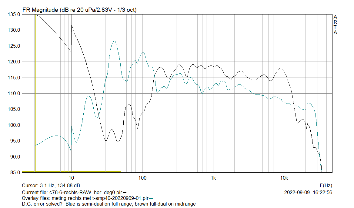

What is a good way to get rid of this awful D.C error (increase in frequency response from 30Hz downwards)?
I use a scarlett 2i2. together with Arta I just tested with a semi-dual setup by connecting right output with right input with XLR cable. I just had some time on my own in my living room and did test this, on a complete speaker looks ok, but also a lot of background noise with a lot of low frequency noise, so i am not sure. (do not mind the level, it is not correctly calibrated after fiddling with the input and output levels to reduce the influence of background noise.

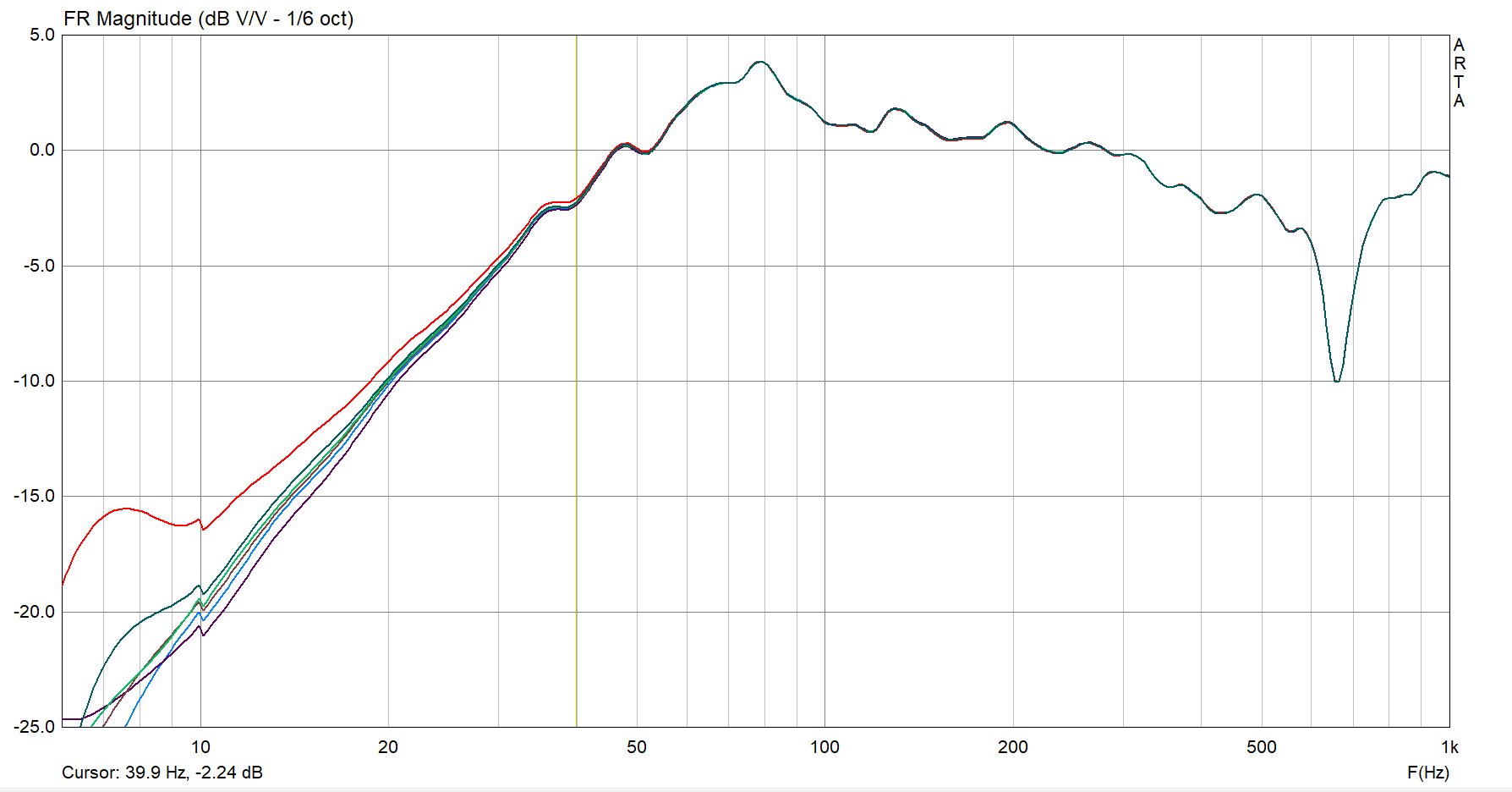

Maybe Ivo could propose a good solution about ARTA's "inconsistency" when measuring very low frequencies.
Here below is an example of a near-field measurement of a subwoofer based on a 10" peerless woofer.
These are measurements taken consecutively (each one within seconds of the other) with the exact same setup. Every measurement is different below 40-50 Hz.
I know this is due to the very low frequencies, because if I put a passive high pass filter at 20 Hz at the microphone amplifier output, all the readings are exactly the same.
I have also monitor the output of the microphone amplifier in an oscilloscope and I saw very very low frequency signals, probably due to noises.
Is it possible to include a good solution for this in the software?
What sample rate are you measuring at, as well as FFT length?
Or just ignore it, since the time window sits at 50Hz,see the yellow line on the bottom of the graph.
So everything below 50Hz is garbage anyway.
Go to view -> time-bandwidth requirement.

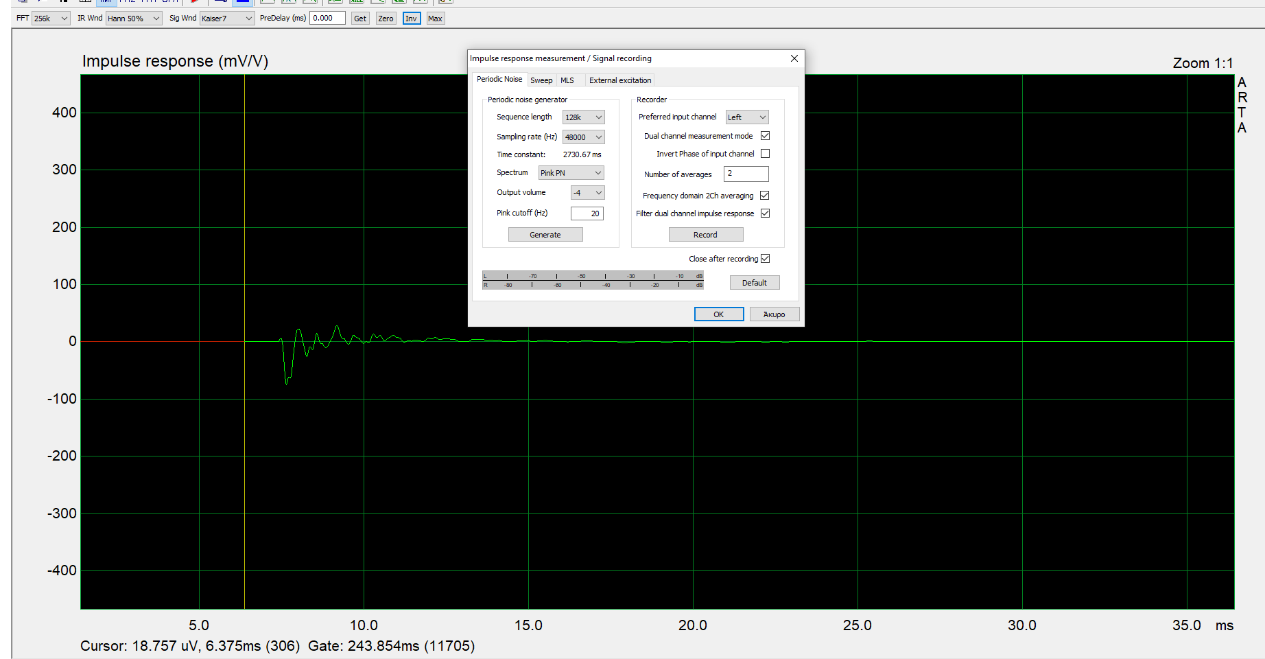

B_force, thanks for the reply. Just having some time to spend on audio, so started looking into Arta, but cannot find what setting determines the time-bandwidth frequency. I looked into several measurements, and regardless of the setting during recording it is 50Hz. The Arta documentation does not give me any clues. What influences this, and is it worthwhile?
Ah, found it Setup>analysis parameters. But is it worthwhile to set it to a lower frequency?
