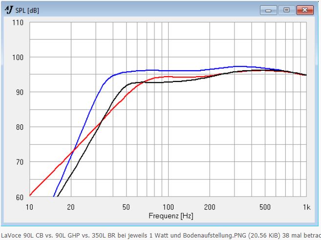

This woofer runs very well in a closed box, which is brought to a lower cut-off frequency by a high-pass cap. Not super deep, but it will work well when the speakers placed close to the walls.

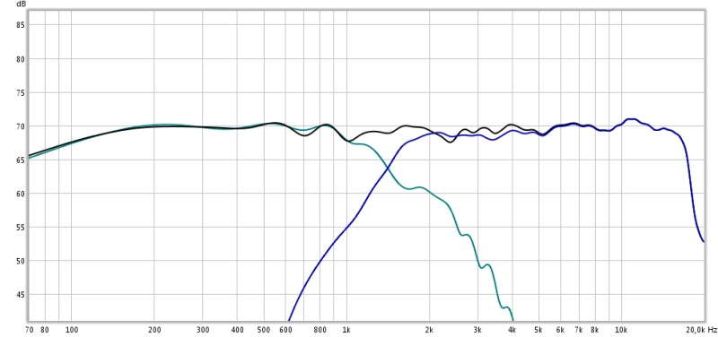

Tymphany DFM2535 with Celestion Horn:
Bass simu:

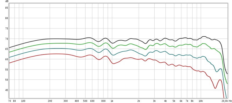

Measurement on axis:

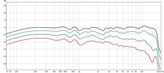

Measurement off axis (0, 15, 30 and 45 degrees, 2db offset):

Very nice overall and off axis response. I walk around while listening, so off axis it important to me.
Looks like bass is only 5 db down @ 40 hz. That is better than SP2-XT or even Peavey 118 18" woofer. Is that because your bass cabinet is so big? Looks sealed?

Off axis respons is not only important when you are outside the sweet spot. At the listening position, significantly more sound energy comes to the ear via reflections than directly from the loudspeaker. That is why this is also very important on axis.
In my experience you get a very good illusion of the sound when there is a good response off axis.
Yes, at 40Hz this is about -5dB. It's a closed cabinet with around 90 liters (around 2.16 square feet) and a big cap to push low frequencies a little.
Here you can see the difference between closed box (red) and closed box with high pass (black; in Germany it's called GHP). Both with same volume.

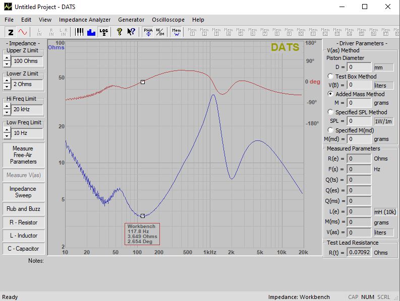

Looks great except for the 3.6 ohm minimum @ 120 hz. If I'm going to play organ music @ 70 w with my house amp, 2 pairs 2n5630 2n6030 output transistors, I'd have to leave the parallel caps out.
A handsome speaker.

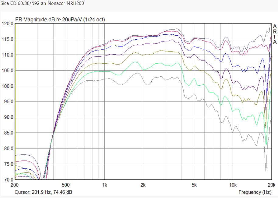

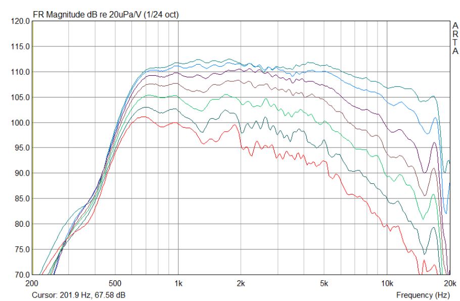

I wonder if the bunching up/diffraction between 2-3k is inherent to the horn or the CD/horn combination? I use the same Peerless driver and I agree it is great.
A handsome speaker.
Thank you!
The horn plays a little wider than the bass between 1.5 and 2.5 kHz. Especially at small angles. Here is a measurement with a Sica driver. The same behavior can also be seen there, so it's up to the horn:

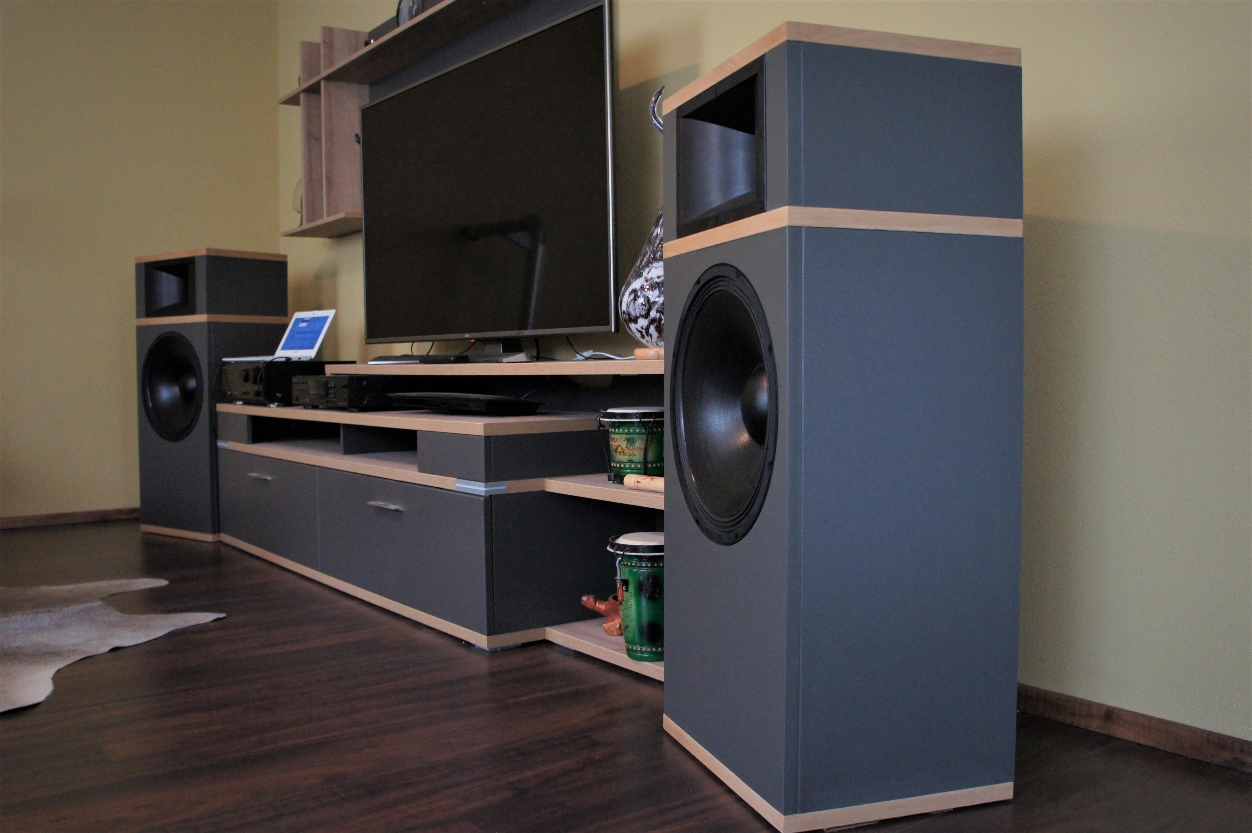

Many people think of the typical PA party speakers when they see them. But the Asathor plays more like a good hi-fi speaker. I actually wanted to make a version with a higher quality woofer, but the LaVoce plays excellently in the midrange and goes very deep in the bass if necessary.
The driver horn combination does everything right in my ears.
Whether Eric Clapton or Billie Eilish, when you close your eyes it seems like the artist is standing in front of you. The speakers themselves disappear completely.
And that works even at very high sound levels.
I listen to a lot of rock and metal, which unfortunately is often poorly produced. It can get a little too much at high sound pressure levels. That's why I made a small modification for myself and connected the tweeter with a smaller capacitor (4.7 instead of 6.8). As a result, there is a small dip at 2kHz, which makes this music much more pleasant.
