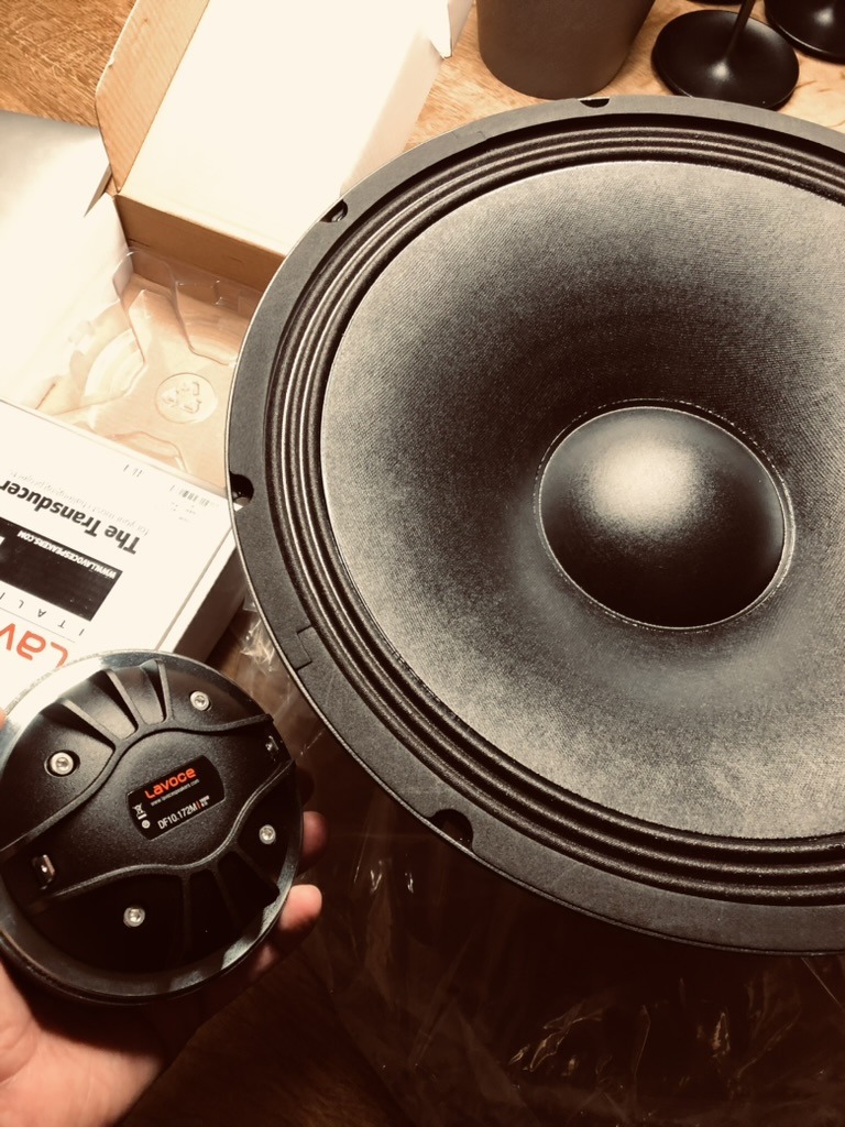

Reading this from Resse,i'm confused a lot.
Is it about the cross point?
Is it for the Lavose COMPRESSION DRIVER?
Resonance frequency for WSF152.50 woofer=Fs 46Hz
Was the speaker in the middle of the room when you took the measurement or was there something within 2 meters (6 feet) that reflected the sound (walls, window, table or similar)?
This could be the reason for the increase in the lower frequency range.
Between 1kHz and 2kHz it is not quite optimal, but that can also be due to the tolerances of woofer and tweeter. The resonances of the woofer, which are exactly in this range, can differ somewhat more from woofer to woofer and this is then reflected in the overall frequency response.
Unfortunately, I have no other explanation at the moment, but all in all this is not bad and such small differences are also very difficult to hear.''

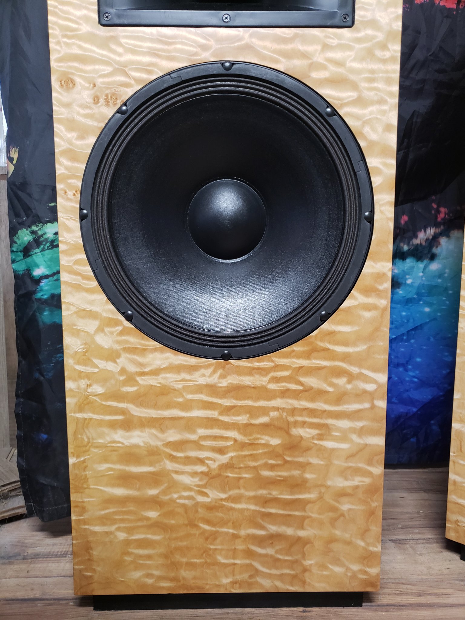

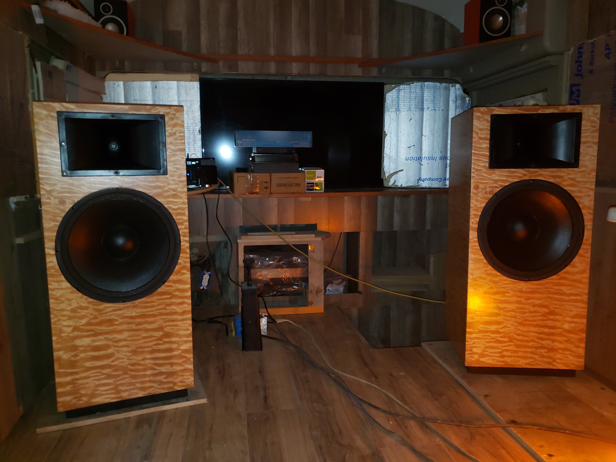

There's not much activity in this thread, so I want to share my new speaker project; the Asathor.
Last spring I finished my first-ever speaker build: An extended version of the classic Dynaco A-25.
The result impressed me. They nearly rival my Harbeth SHL5+ in the midrange, with more fun and punchier sound.

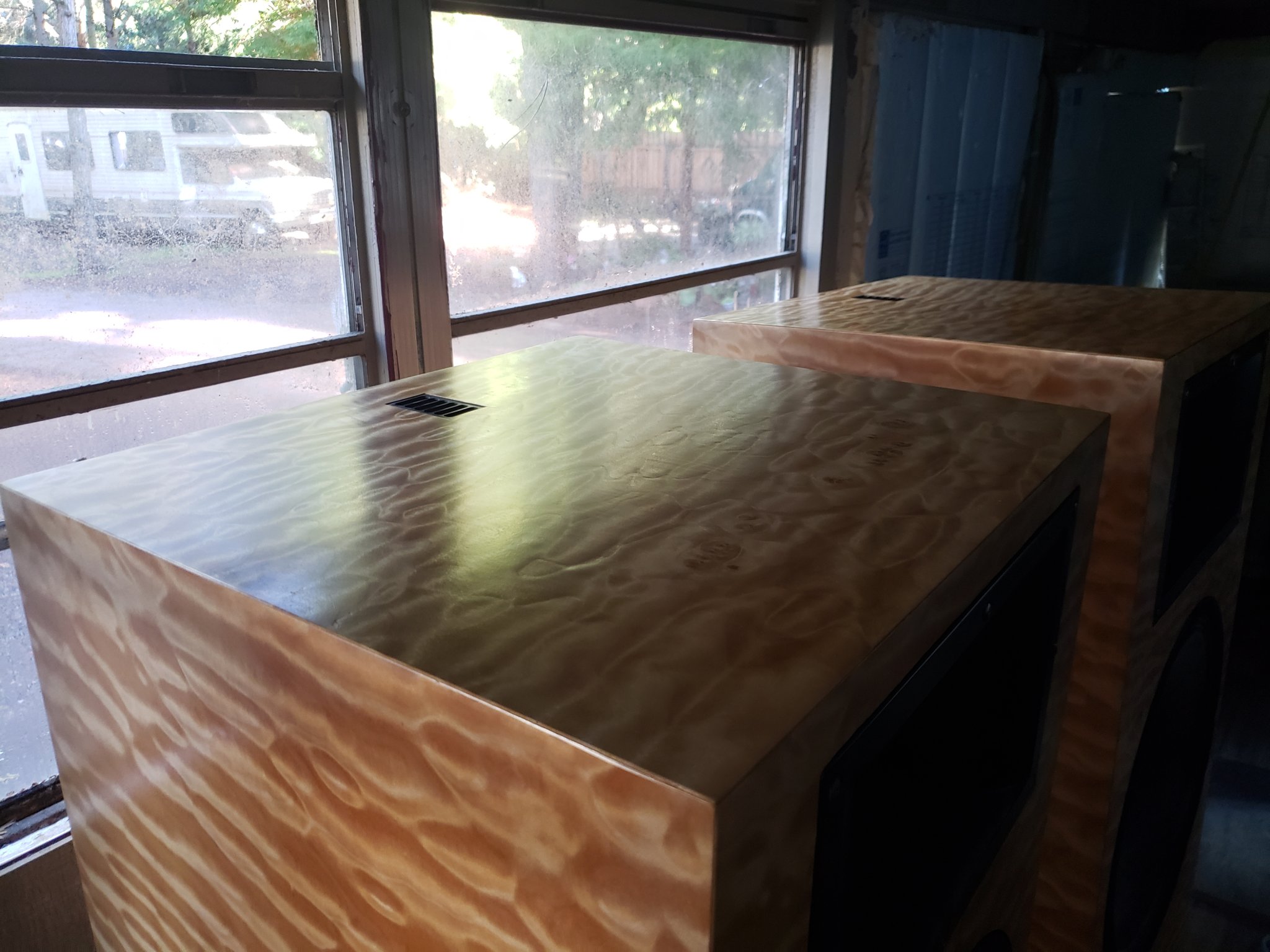

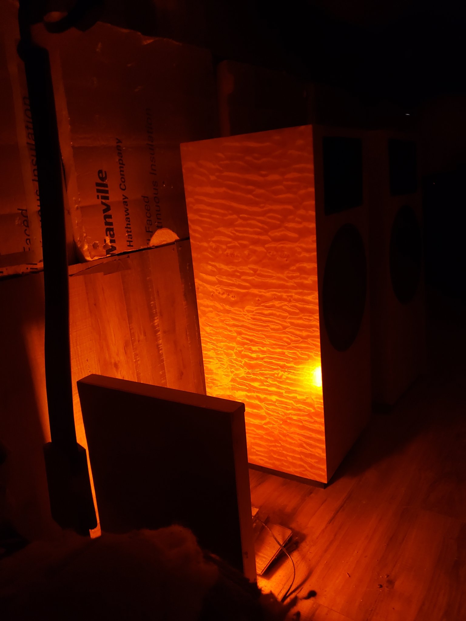

I got some spare sheets of baltic birch plywood from the A26 project for the fronts. Just enough for the sides, and the top panels. The back panels and the bottoms would be MDF.
That is all I know for now. Will post some photos when start building my Asathors.

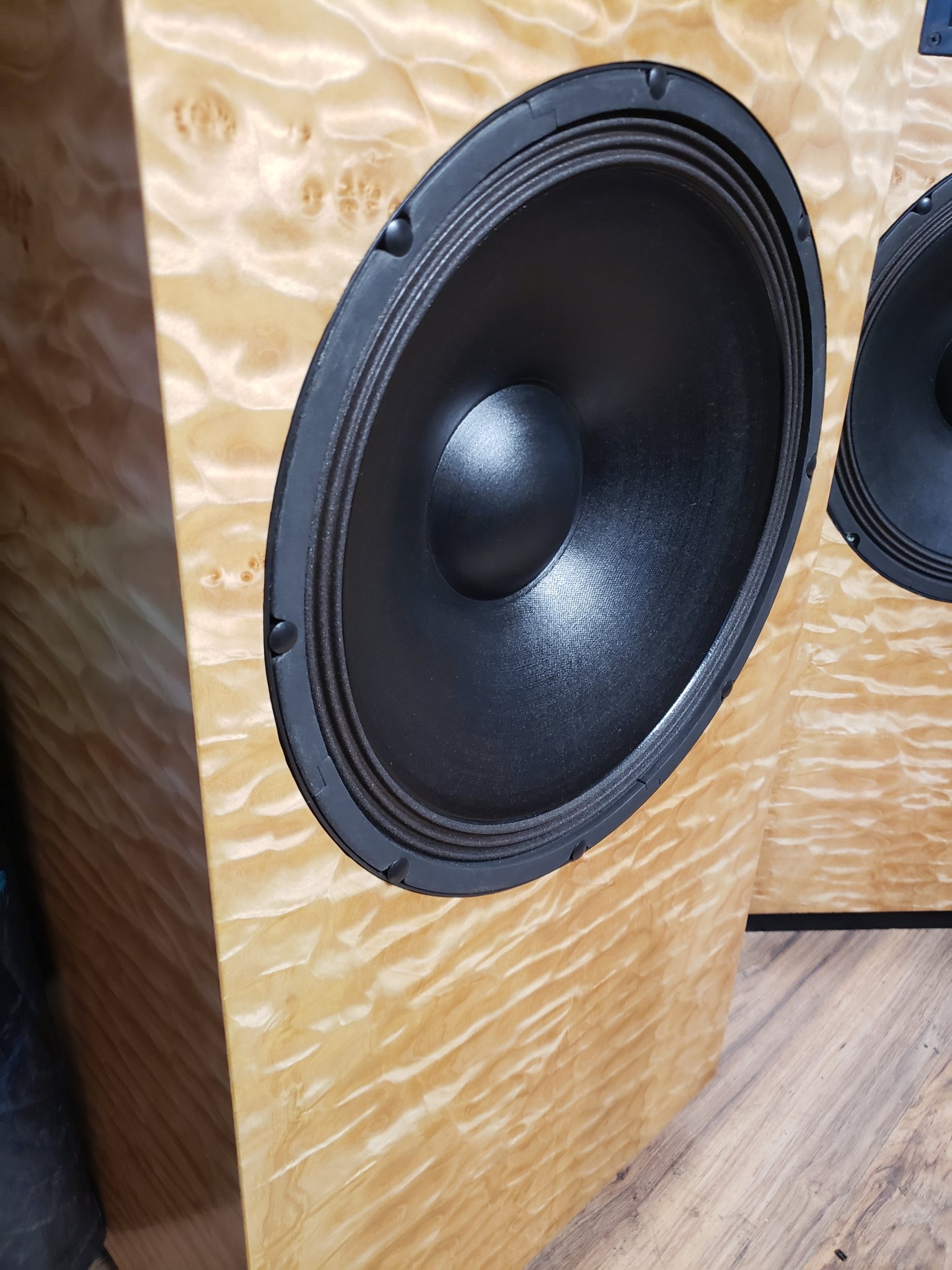

Go back to read page 1. Copy of a JBL design, 4367 maybe? Plans on page 2.IDK about the asanthor design, is that a sealed cabinet?
PORN!!!!!It's a satin Arm R Seal finish on raw wood veneer.
Wrong! Not even ported.Ported 2 way. Go back to read page 1. Copy of a JBL design, 4367 maybe?

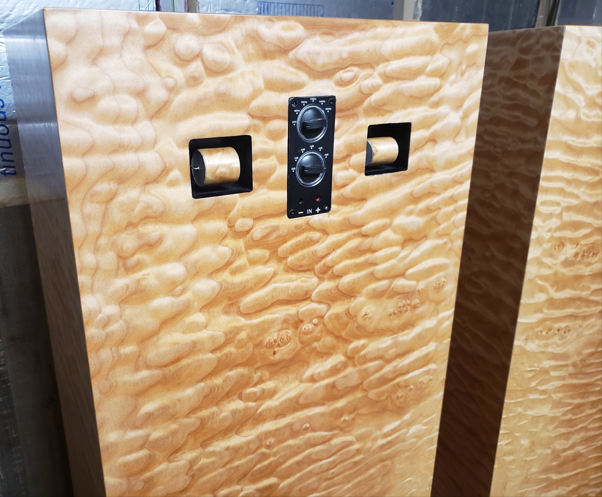

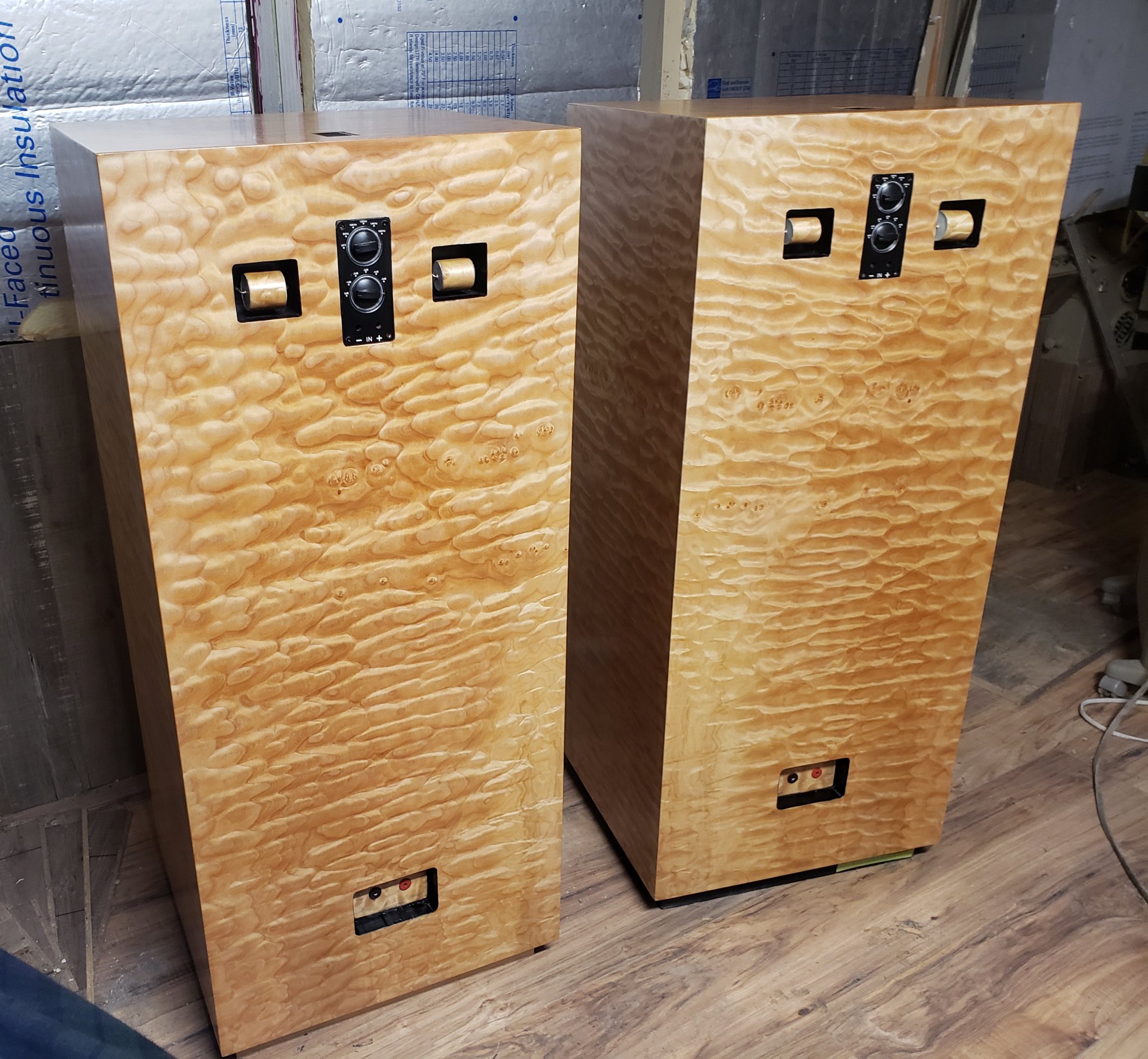

Anywhere in the thread, were you have shown your crossover with the adjustments/regulators shown in the pictures??
Cabinets are nothing less than gorgeous![]()
I used the exact xovers the designer specifies. Only expensive components instead. But the same values.

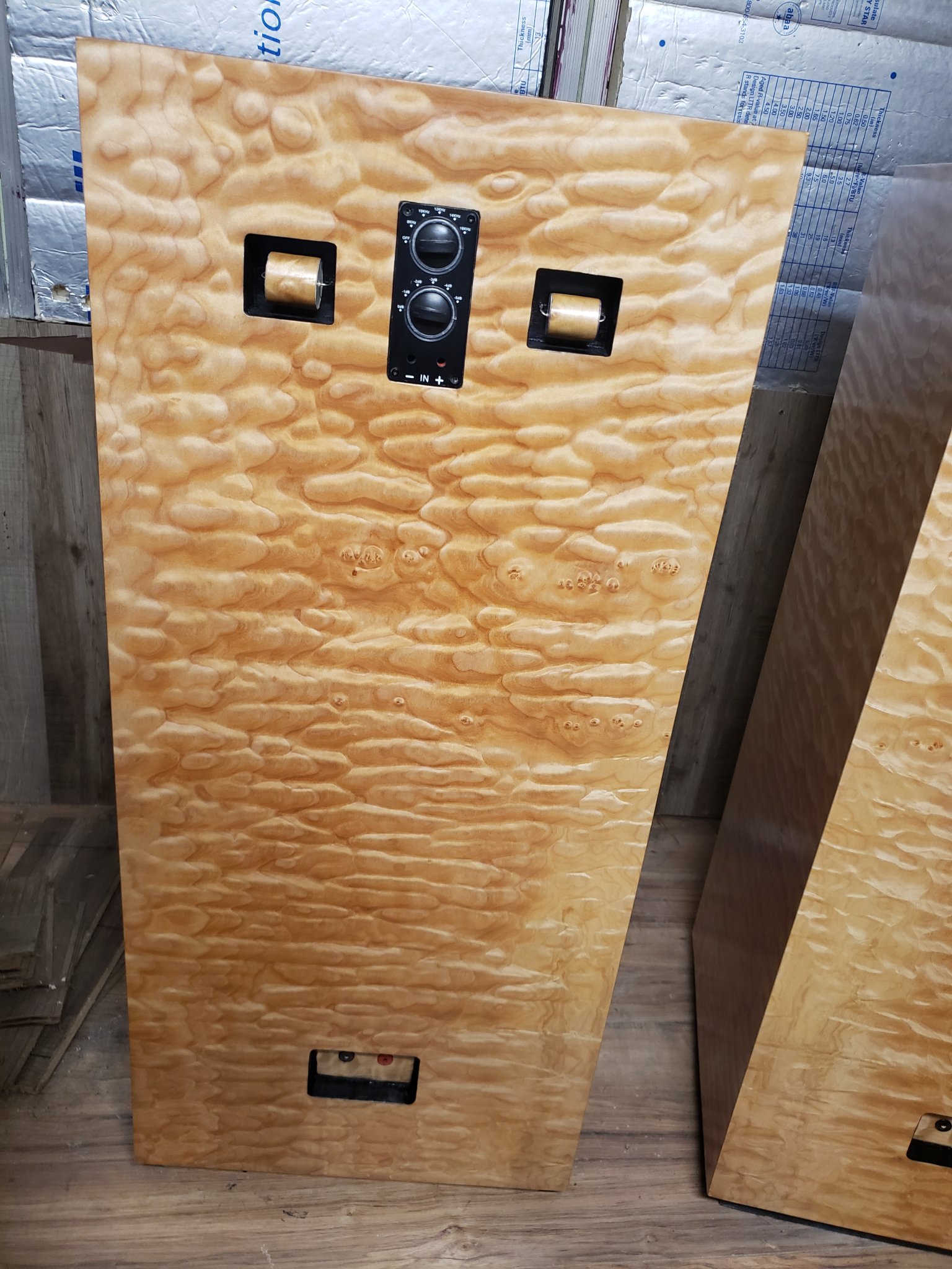

The recesses on the rear that hold capacitors ... One side is just a wooden holder for the 2.0mm mini plugs on the leads of the capacitors. Inactive dummy side.
The other recess has the female 2.0 mm mini banana plugs in it, and is always active. This allows two things: It allows you to tweak the value up or down by one step, to suit your personal tastes or particular music choice. The main purpose is for changing brands of capacitors. Cap rolling.
The controls in the middle are completely separate from the main xover. They are for turning on and off, and blending the super tweeter with the speakers.
No changes
