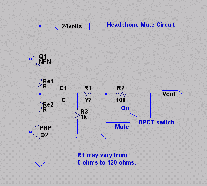

Hugh & committee,
I think a headphone amplifier should have a mute circuit which can be used during power on, or plugging in or removing the headphones. Attached is a suggested circuit (copied from a 1970's Crown preamp).
Some headphones are designed to have a series resistor in the output. Some standard that I cannot recall specifies 120 ohms, but most headphone amp circuits that I have looked at use a lot less, typically 33 ohms. I suggest you provide one on the PCB as an option.
Also I have looked at the requirements for headphones, and the maximum voltage required for maximum output level is never more than 7 volts peak. There is a table on the Headwise website that lists max power levels and impedance, from this the maximum voltage can be calculated. The headphone with the highest requirement is the Sennheiser HD550 at just over 7 volts peak. The amplifier rail voltage therefore would need to be at least 18 volts (and 24 would probably be better).
I have a half built headphone amp that I abandoned about 10 years ago, I might use this circuit to finish it.
Paul Bysouth, October 2009
