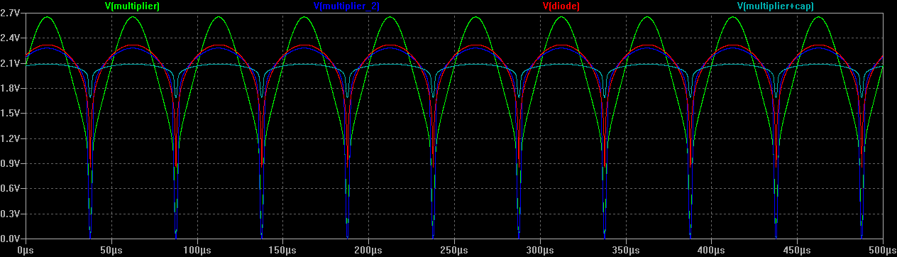

One more thing, and I'll leave the diodes alone.
John and others, I'm sorry if I seemed rude when defending the diodes.
By placing a special capacitor, we can greatly increase the regulation of a Vbe multiplier at AC, one advantage the diodes don't have. Here is the plot and my simulation file.
This works quite well with the BD139, and will probably work even better with the MPSA18.
- keantoken
- keantoken

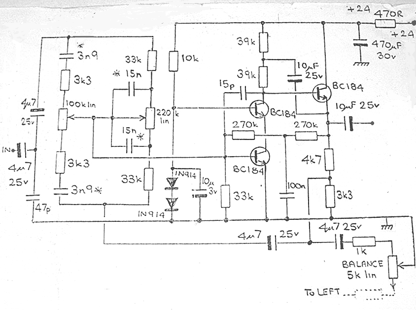

Hello Hugh
Sorry, I've forgot that it was single rail amp. I did think about the op-amp tone control also for my LF amp who now replaced the Radford, so I've done it double rail.
Until few month ago I was using a Radford HD250 integrated amp, there is a tone control in that amp, I was needed to raise the treble to get the high freq. correctly, but there is also a possible high lost from my room acoustic.
I will use a tone control with the Haksa, so for old geezers like me who will want to use an ad-on tone control line amp, here is the schematic that I may use, it's a Crimson Electric tone control line amp, it's single rail. A 30 years old circuit but it still a fine circuit like my old Crimson power amp. Btw I did not simulated this tone control line amp, but it should work good as is.

Okay then, it's decided.
This cap is placed in parallel with the top resistor, the one that goes from C-B. It decreases the divider's impedance, so that the base current of the transistor causes minimal error.

Thanks for the cap trick, how big, presumably as an impedance at 20Hz a small fraction of 1K5, the usual value of this resistor, so around 22uF, same as the bypass?

As for the cap, I just did a simulation and for an equivalent response of -3db at 20Hz, the cap is 47uF. (but the usual bypass cap is smaller than this, I'm not sure how important bass response of the Vbe multiplier is).

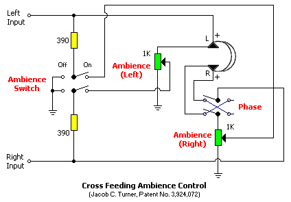

Oh, look what I found. It has the crossfeed and stuff, everything we need to know. Is it desirable in any way to have an inductive crossfeed? Hmmm...
http://www.headwize.com/tech/sshd_tech.htm
It doesn't seem to say anything specific about canal resonance though.
EDIT: This page has some more stuff:
http://www.headwize.com/projects/equal_prj.htm
So I've now heard figures of 5KHz and 3KHz for canal resonance.
- keantoken
- keantoken

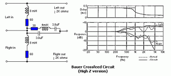

Hello Hugh and keantoken
The Bauer's passive auralization crossfeed network circuit seem very interesting and relatively simple.
Bye
Gaetan
Bye
Gaetan

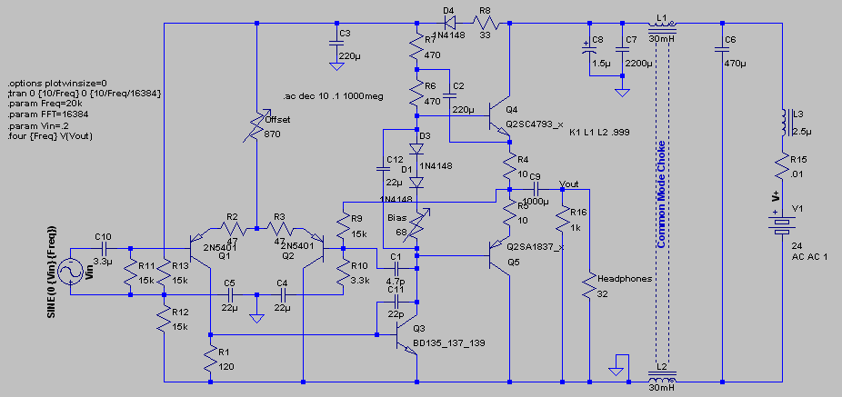

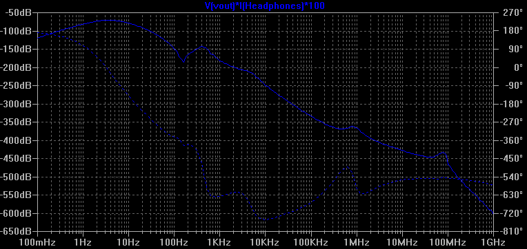

Okay, here is the updated schematic. Doesn't yet include CF or muter, etc.
I've also attached the PSU noise as seen by a headphone impedance of 32 ohms, at 100db/mW. I couldn't match the datasheet curve for the 10u bypass, so treat this like "worst case" I guess. Looks good.
- keantoken
- keantoken
Gaetan, Hugh is worried about the AC characteristics of the crossfeed interfering with the sound processing that is already present on the music, which is why he has opted for a purely resistive crossfeed.
- keantoken
