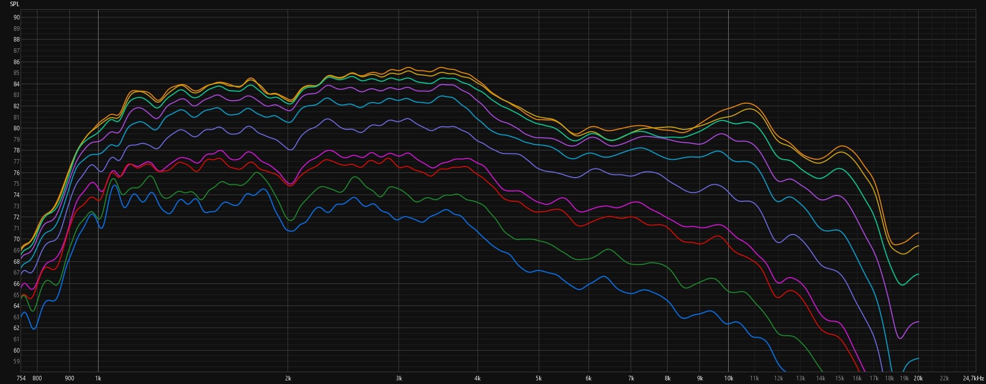

Been playing around with DSP every evening in the workshop. It´s kind of crazy what you can do with EqualizerAPO. It can basically brute force the whole response in any shape or form you desire. Below response is just using a simple parametric crossover, measuring the whole speaker response and the FIR it into shape. Measured from 1m inside (7m ceilings tho) gated at 100ms. N151m is crazy smooth and has incredibly low distortion.
