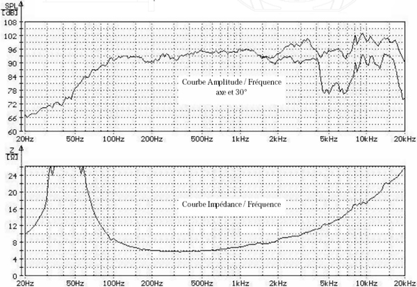

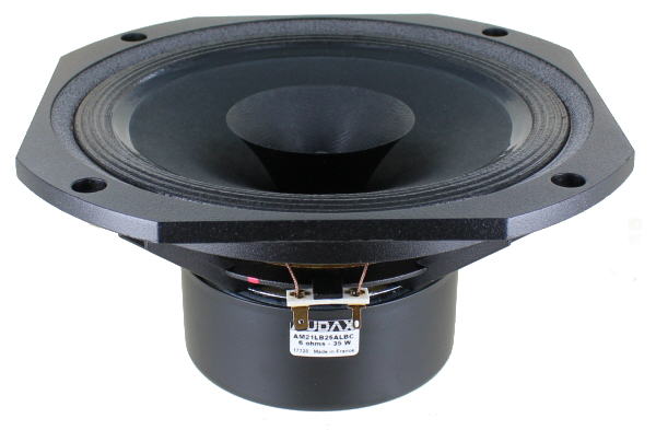

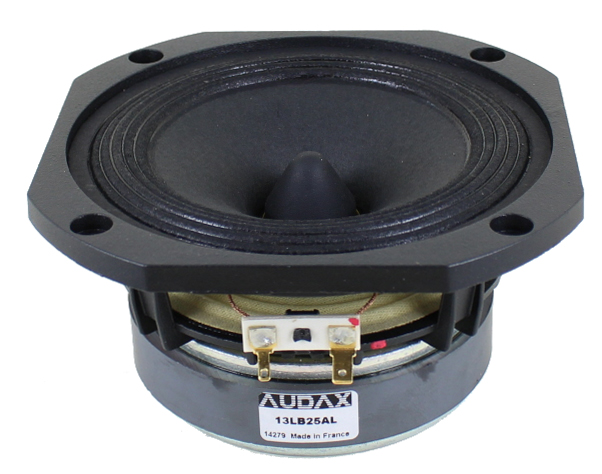

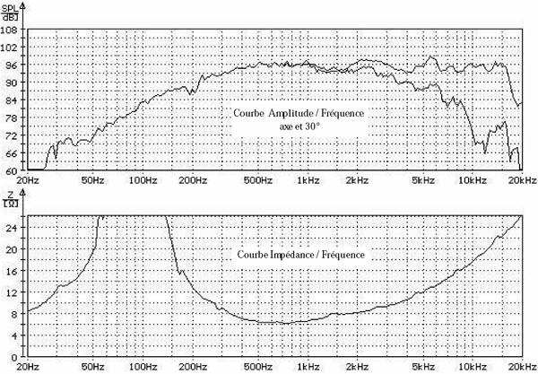

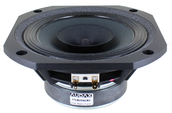

I added the photo of 5",6.5inch and 8" audax drivers with order.
Which one of them can I use a full range without any correction circuit and without any irritation?
I do not know which frequency peaks more important.
But I am guessing, it starts with 2-8khz??
What is the important thing, peak degree/sharpness or just the amount(db)?
I am guessing frequency response change wrt enclosure.??
When I tried to understand this graphic:
5" 5-6khz 6db peak
6.5" 7khz rising response
8" 2-4khz 8db peak and at 7khz rising response
But also I thing 5" has peaks at 2,7,10,15khz
How much are these important?

I like the 5".
Beyond a certain frequency, the sound is nothing but breakup modes, it just matters how smooth they are.
How close are you to the speakers ?
Tang band 4" bamboo has a similar 5-6khz spike,
I found it added some clang to cymbals, not the 8khz spike adding spit (s's and t's).

I think 5"one is only ferrite, 6.5inch and 8inh are both neo/ferrite hybrid.Maybe better I choose 6.5inch ferrite/neo drivers?

I also like the 5inch, but other drivers have magnets made of neo/ferrite hybrid. I am not sure but this hybrid magnet can have less interaction with VC ac field, so they may be have less distortion..

I asked the 5inch magnet type ferrite only or hybrid. I am waiting answer.
If we trust to frequency graphics of manufacturers, some people apply notch filters to their drivers that have small peaks similar to 5inch audax drivers..
Maybe sharpness/degree of the peaks is more important. So 6.5inch maybe can be better choice..

5" full range start to fall down at 500hz.I think it is too quick. It can cause "anemic" bass like wolf_teeth said.

6.5" goes well until about 150-200hz
8" goes well until about 100hz..and 2-4khz 8db peak
both have rising response after 7khz.
Which one do you prefer between this two? (bass wise and treble wise)
If 5" one went well about 200hz,I definitially choose it, but..
thanks.

Most drivers have problems.
Most 8" have trouble 1-4khz causing shout.
I like to eq this area down at least 3db, not up.
And yes without a whizzer, it isnt nicely getting up to 10khz.
And don't get me started on the problems with whizzers.
And 8" works foir 1 pair of ears at 7'.
