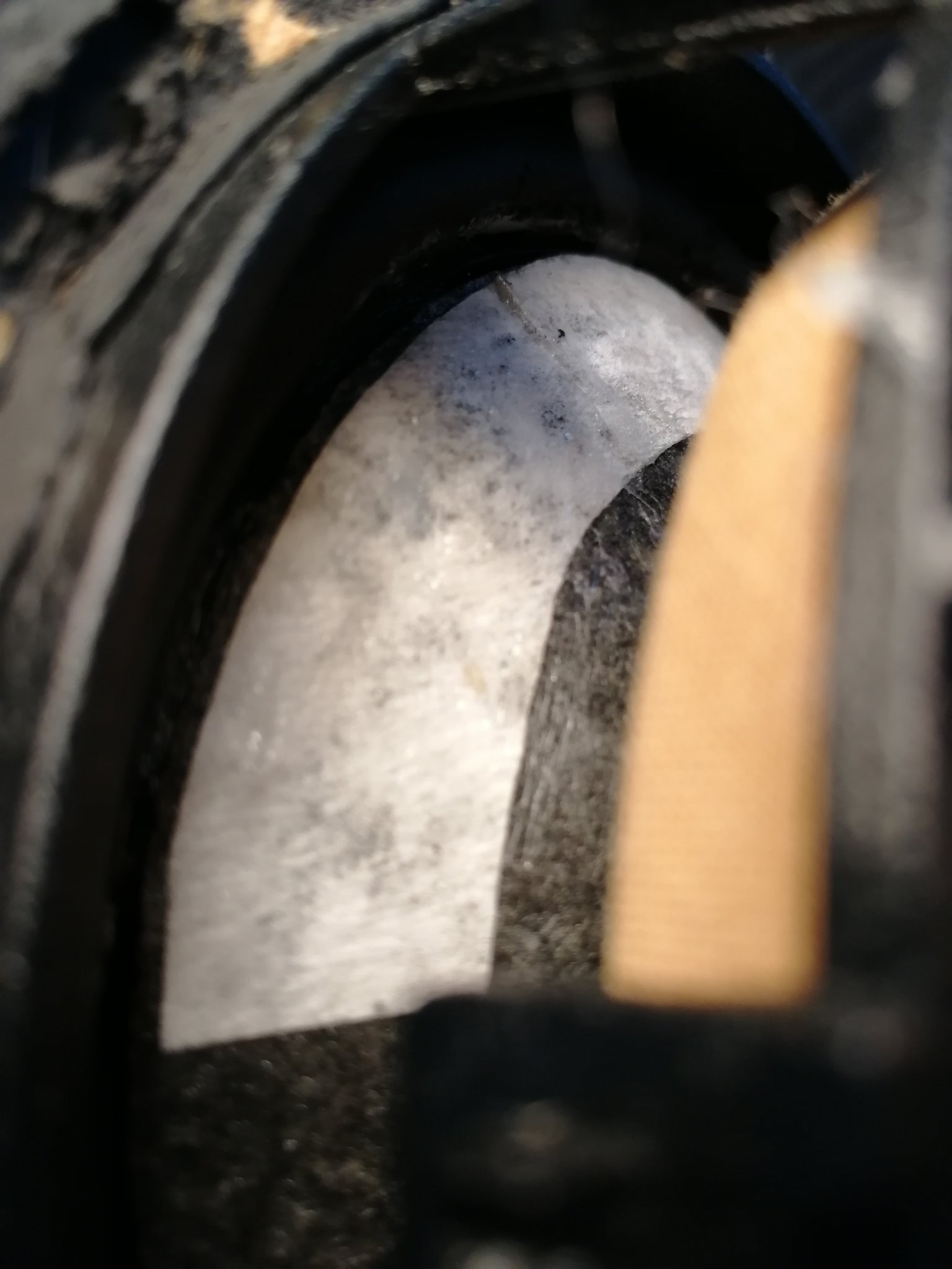

Albert use 12 mm filt material glued all around inside cabinette walls, and also foam and lots of filling.
Yeah, that's not a particularly good implementation (w/ the insulation).. BUT the cabinet volume looks relatively large and deep - which is excellent.
My recommendation is: also a large volume and deep enclosure, but move the cotton re-bond (insulation) toward the center of the cabinet (hanging) starting at least 3" away from the driver's magnet and then extending most of the length/depth of the cabinet (but not close to the cabinet's panels). Also, a bass-reflex design with the port tuning at least 2 octaves BELOW the high-pass of the crossover (..so that would be <75 Hz tuning freq. for a 300 Hz high-pass). Note that the interior bass-reflex pipe should also not have insulation near its internal opening, and the diameter of the port should be "generous" in size. Finally, wax and buff the interior walls of the cabinet (and the bass-reflex pipe) to further reduce air-drag.
In effect then you've got reflections suppressed by the sound bouncing off of the walls and into the center-mass of the re-bond. There is overall lower friction that would damp the driver's motion in the sub mm range. Finally, there is an air load on the driver's resonance (from the bass-reflex) that damp's the motion of the driver where it is most non-linear and because of its low freq. tuning relative to its high-pass filter - is NOT designed to extend the lower freq. response of the driver (which would increase excursion and resulting distortion).

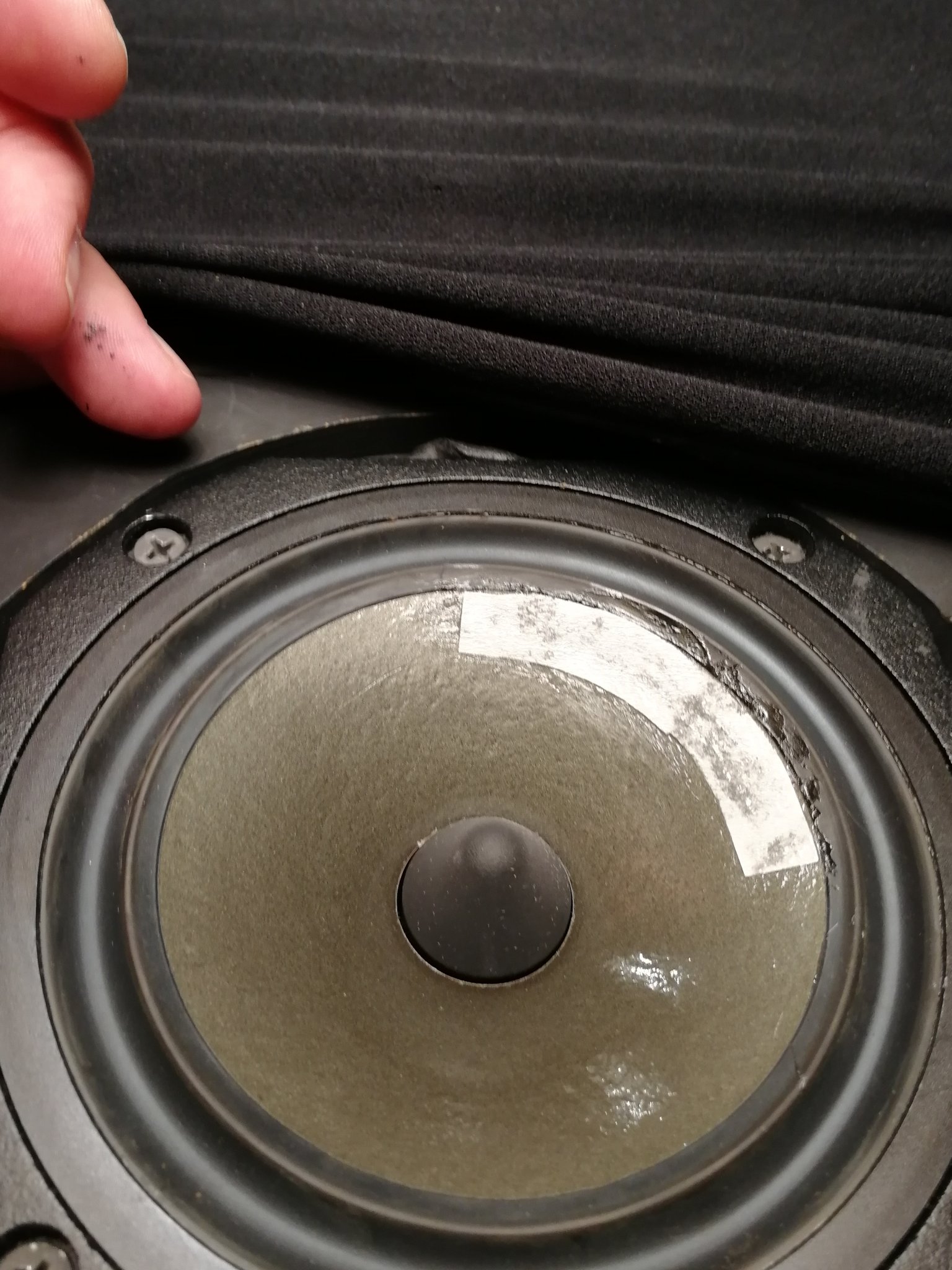

Ow, that's BRUTAL! 😱😊Last time i blow up all 4 of them in my MTM
Yeah, the aerogel from Audax can "fatigue" and crack more easily. It's basically an acrylic foam with a polymer "skin" as the substrate for the foam (usually the front of the driver with no "skin" on the back).
My 170ZO's are still OK but then they have been in their boxes for almost a decade now (away from UV radiation). (..projects come-and-gone, where I cannibalized other drivers used with them for yet another project.)

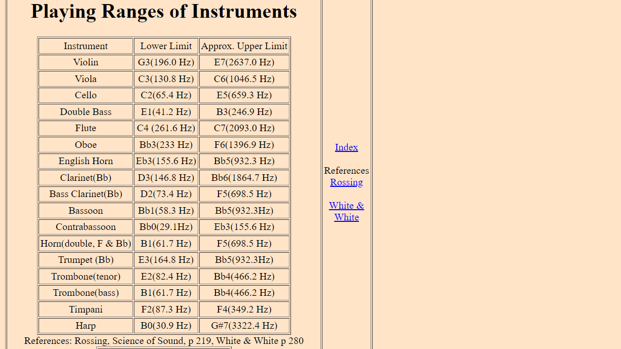

2 to 5k is most sensitve. 1 to 2k is the least sensitive range between 400 and 8k hz
Your right if we only talk about where we human hear sounds best, that is from range 1-5 K. ( to survive the best at the savann)
But my point here was that most instruments and what we hear "and analyzing" and are "real" sensitive to is between 1-2 k
We also talking about hifi and stereolistening and midrange here, and youknowyou´s xoverpoint at 1600hz.
Because now from 1600hz and up youknowyou´s tweeter has all "the responsibility"
Test if you raise the curve in your xover +2-3dB between 1-2 K, and you will likely experience the unwanted nasal cheap sound.

Yeah, the aerogel from Audax can "fatigue" and crack more easily. It's basically an acrylic foam with a polymer "skin" as the substrate for the foam (usually the front of the driver with no "skin" on the back).![]()
Yea, and you are right its no "skin" at the back of the cone.
The first 2 times it cracked i glue´d it with cut out coffee-filter-parts 🙂 , and i coulden´t hear any negative effect after the fix.
But last time when i blow all 4 of them it was the coil´s

WOW, coils blown on a sealed MTM! That takes some "doing". 😊

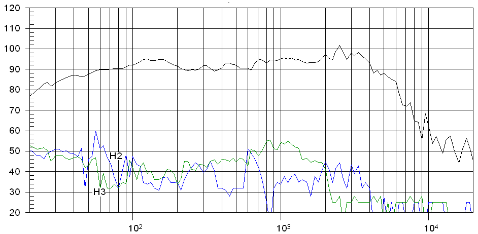

I don't think the Beyma 15" driver's will do anything better than what you already have. The LX60 should provide a bit more "weight" or "heft" in the upper bass than the 15a, but that's about it, and perhaps slightly inferior with detail retrieval. (Mms of the driver's would show most of those differences.)
Considering the rt2ha has a bit of "lift" on the low-end (1.5 to 3 kHz), the faital pro 6FE200 might work well with perhaps a 1st order electrical around 2.7 kHz. Detail retrieval won't be as good as the Audax but the driver does have some "charms" of its own and doesn't cost a lot to try out.
-really though, finding better would require a different design (and other than harmonic distortion the design is already quite good).
I'd almost say, add 2 more rt2ha's per channel and go the 4x 4" Audax aerogel drivers in a side-by-side small vertical line array (as long as you don't listen in the nearfield). Different design though..
