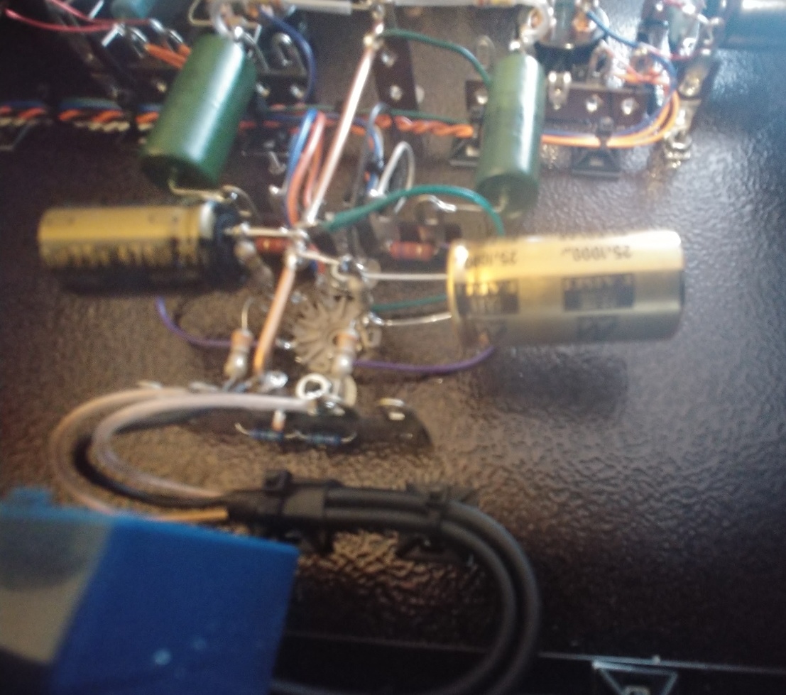

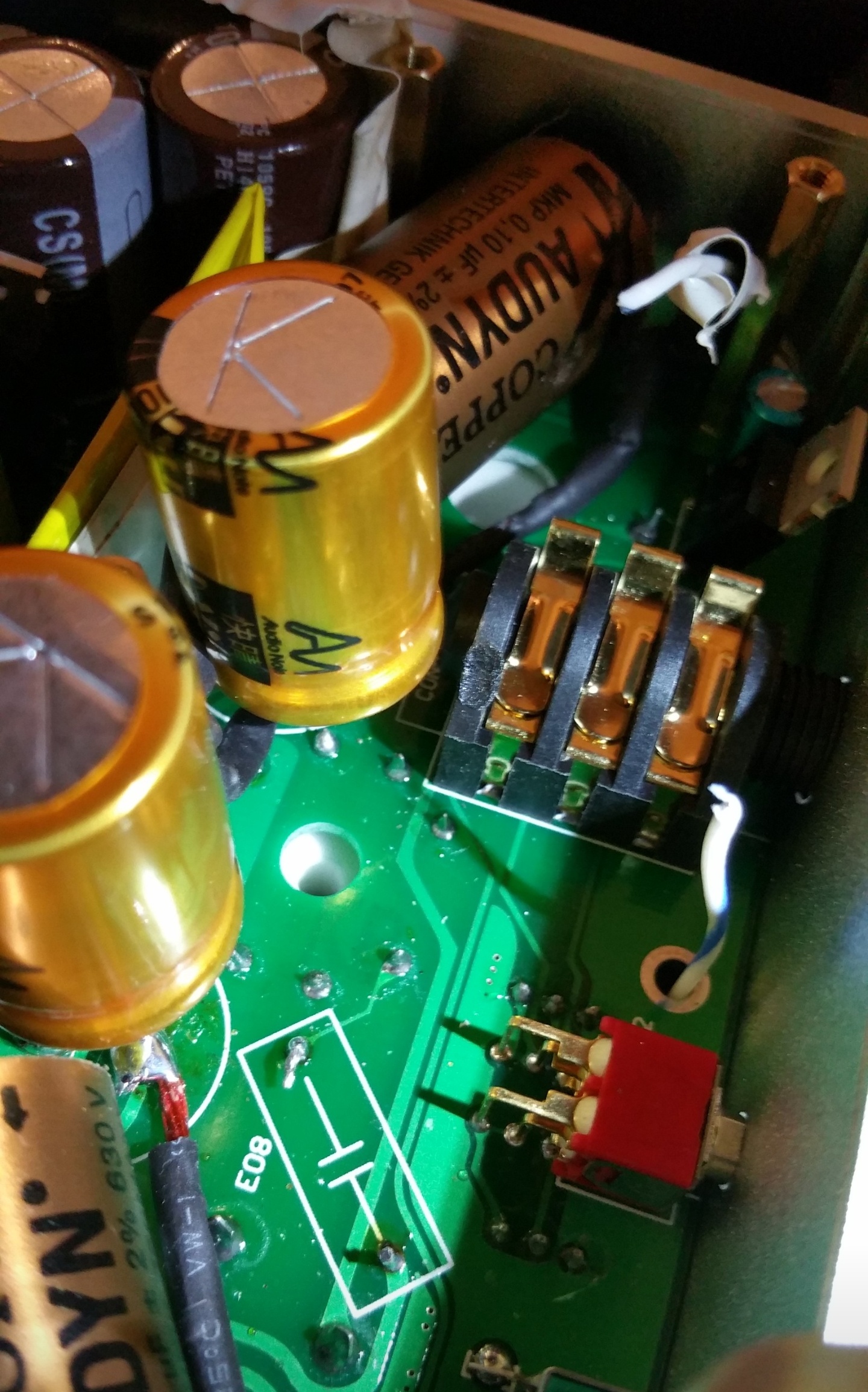

My fault for not being clear.
The problem was thatI used non-polarized kasise version on a $3k amp.
It was at higher capacitance, wich altered the cicuit to produce more low end, so not all kasie cap fault, as much as the circuit fault.
(I uploaded in first pic)
So I also tried and ended up keeping the same value Nichion muse, which in that situation was more neutral.
I had used the kasie polarized version before successfully, on a cheaper amp ($200 appj) , using same method of increased capacitance, but way higher, from 200uf, to 1000uf, for more bass sustain.
The result was only a little more bass on this circuit, and totally transparent sound.
I then placed bypass caps, which ended up doing very little to top end(!).
Almost no change, which made me believe the kaisie were excellent and why I tried on the other amp.
The issue was that they were sold out of the polarized version at the time, so I tried the non-polarized, which as I just stated, didn't work out for me to be as transparent.
My mistake was in not using the polarized, and not realizing the circuit will behave differently on every amp.
I uploaded pics of the circuits below.
This is interesting. I only have experience with the polarised types but have heard controversial opinions about the bipolars. Perhaps they are not as good.
