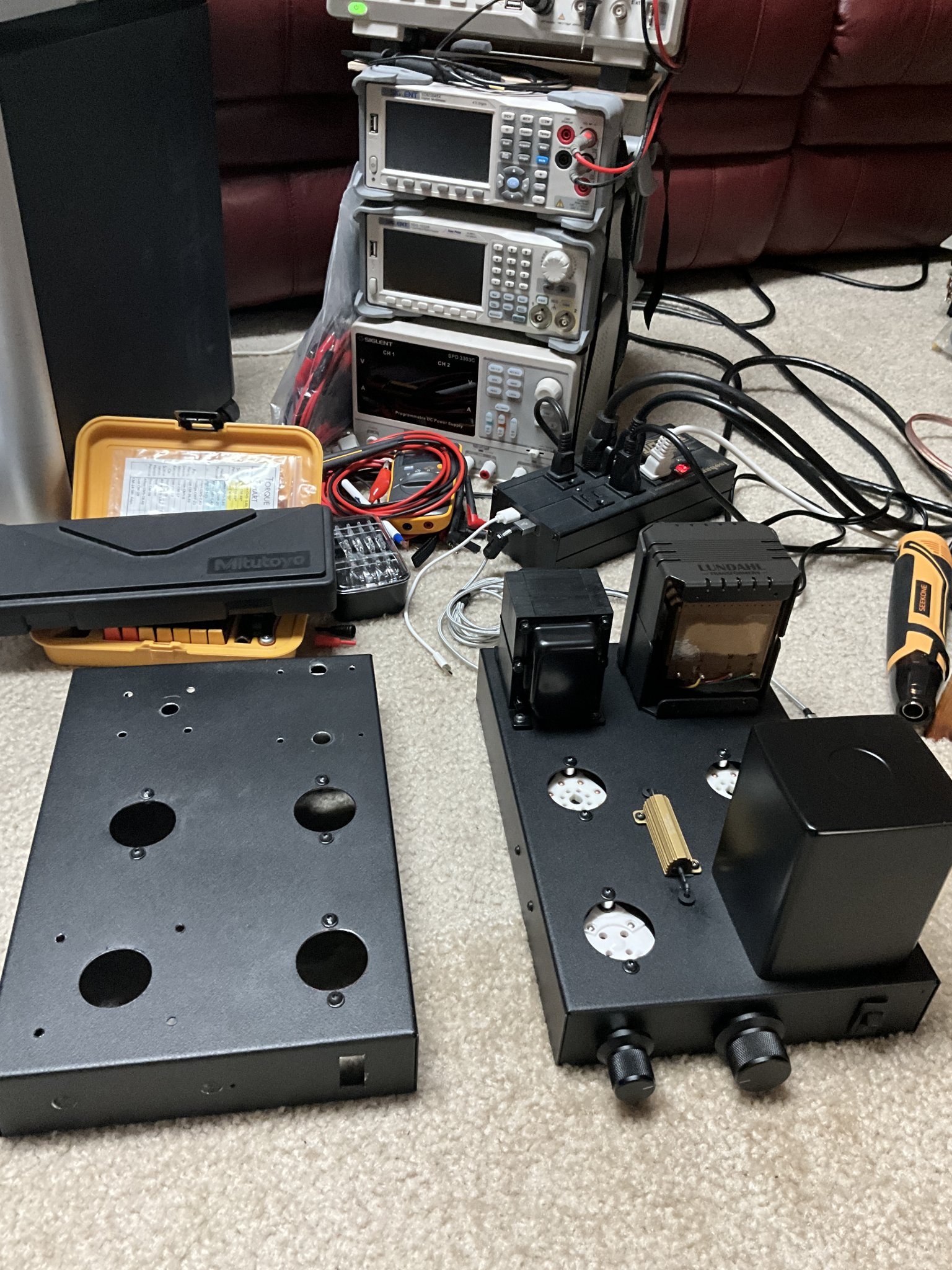

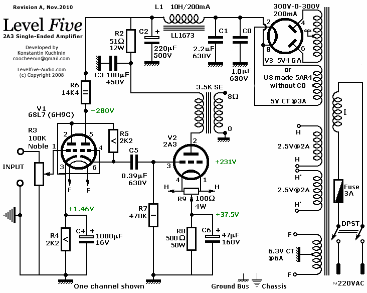

Am seriously considering Kaisei 100 uF 500V NON-polar for position C3 in Konstantin Kuchinin’s 2A3 design in a set of monoblocks I’m building.
As I’m using another AN cap in the 220/500v position I suspect the two may complement each other. the compact size is a plus too as I used 8x12x2” chassis.
I am advised NOT to use a POLAR electrolytic in the C3 position although I’m not exactly sure why. Considering running the PS with one anyway just for testing purposes.
How critical a choice is this?
Thanks in advance.

The only reference I have for this is the HiFi Collective website:Am seriously considering Kaisei 100 uF 500V NON-polar for position C3 in Konstantin Kuchinin’s 2A3 design in a set of monoblocks I’m building.

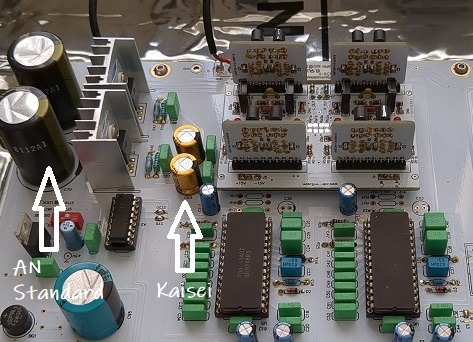

''…the all-new Audio Note Kaisei Electrolytic capacitor range specially suited for valve power supply use.
Alternatively the NON-POLAR (bi-polar) offer improved sonic performance…''
This is all they say. Hopefully, someone around here can give us a technical explanation.
