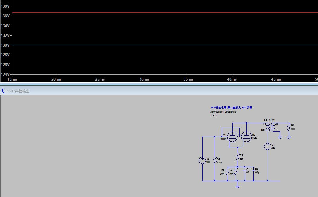

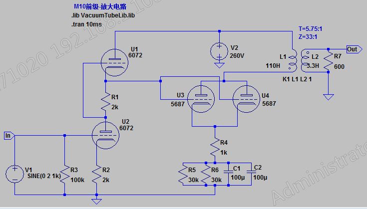

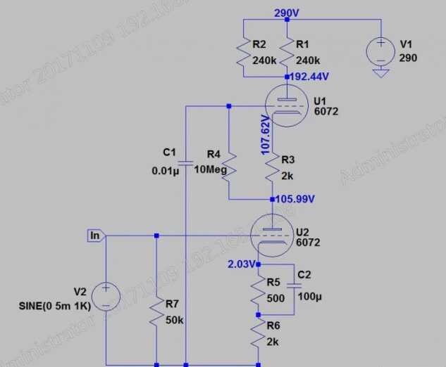

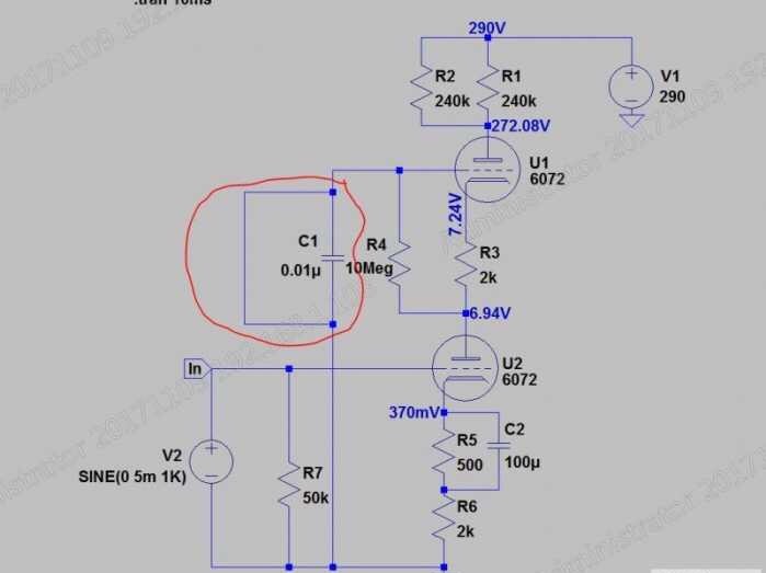

Why would you expect the same result?! Please compare the two circuits you posted above, do you not see the differences in the grid voltages? Another case of garbage in garbage out...
what fool I am, I thought the DC of grid will not affect the tube
after add a 130V DC to the grid, it is same as the real circuit. Thank you very much😀
Now put all to the circuit, It works.

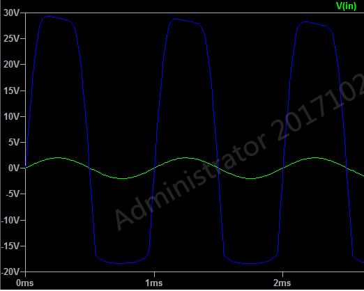

Output wave is not good
Output wave clearly shows clipping.
Did you simulate the voltage gain of this stage? It will be more than 50. 😱
Do you expect this to be a normal line stage? 😕
In the complete M10 preamp it is attached to a low gain phono stage (gain approx. 40, delivering some 200 mV into your line stage with a standard 5 mV input); that's why you need the "excessive" gain of your stage.
But this has been mentioned before, remember? 🙄
5687 operating point is poorly chosen; try 7k5 of cathode resistance.

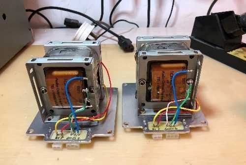

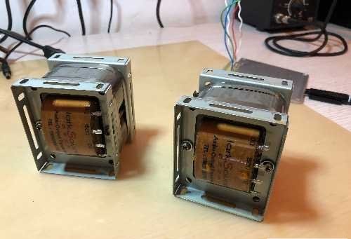

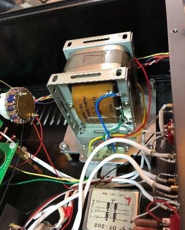

I used the buying OPT for the test, the turn ratio is 33:1, I will test it in real circuit to see if it has the same problems as simulation. I have not finished DIY OPT yetBeautiful! So how did the transformers work out?

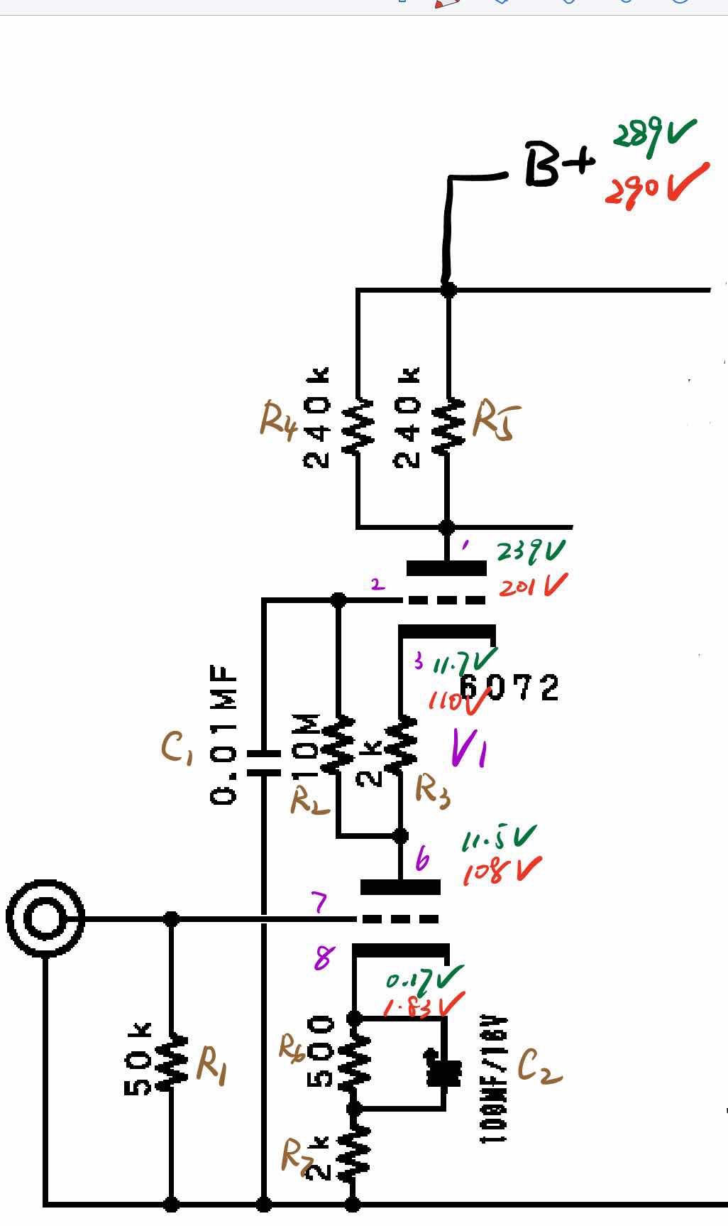

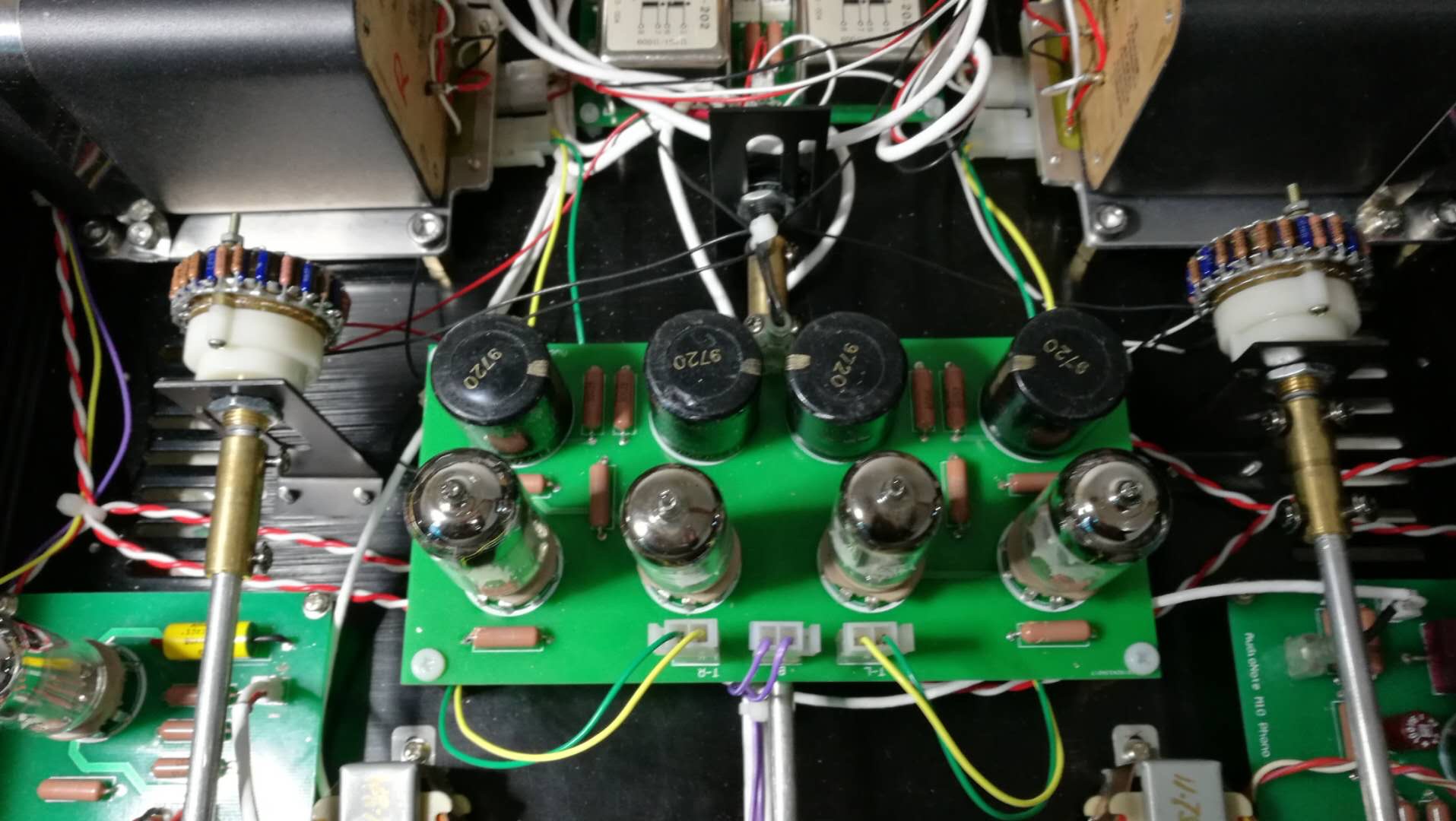

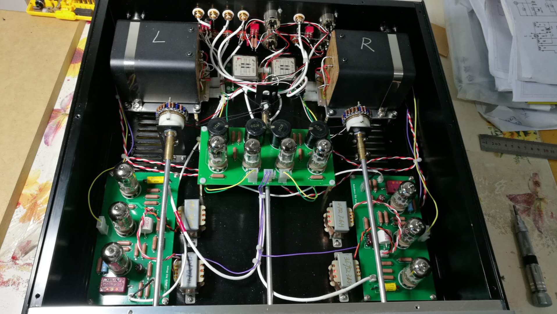

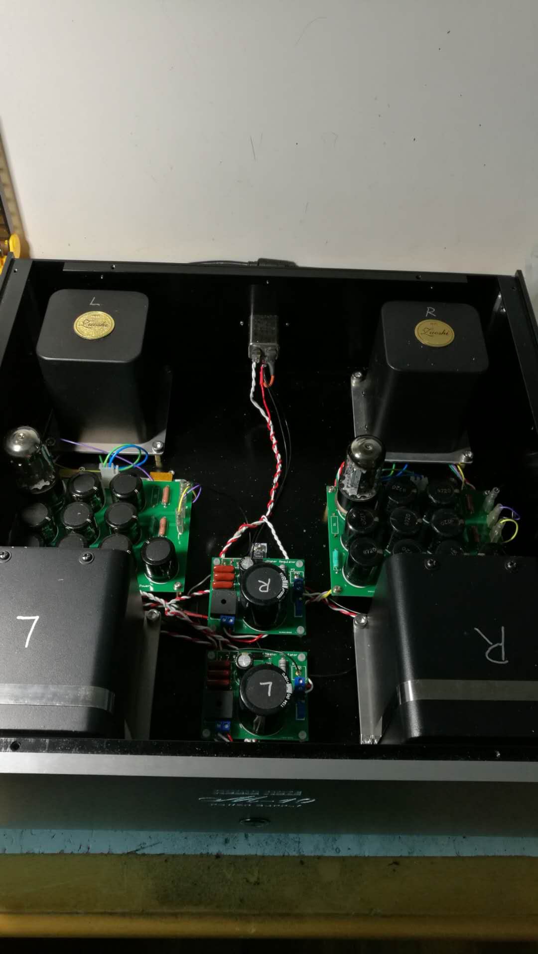

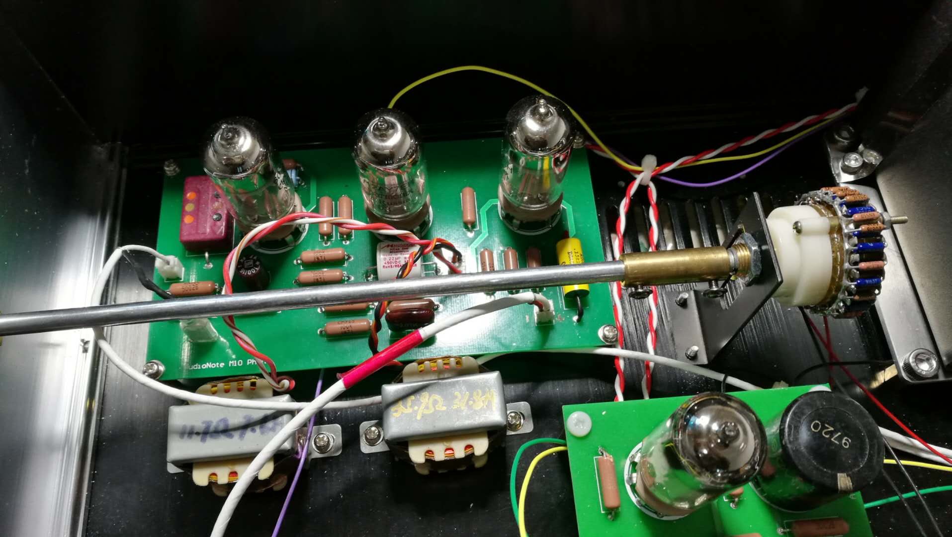

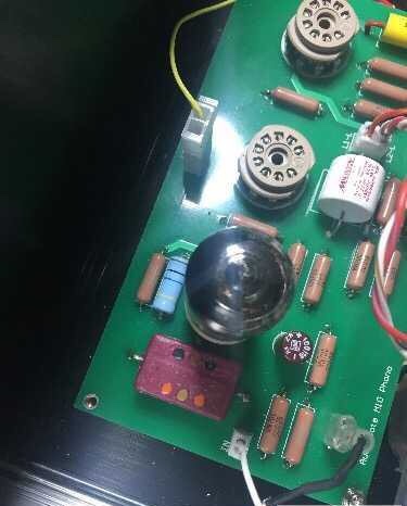

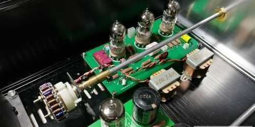

I have switched 6072 of left and right, the problem remains on left, so it is not tubes problem
I pull out the 6072 and test the res of each section
1,I have tested the res from B+ to 6072 socket #1 L and R is the same, about 120K
2,socket #3 to #6 L and R is the same,about 2K
3, socket #8 to GND L and R is the same,about 5K
what I missed to lead the problem of LEFT?
@Jerry: could you please show me the link of shop from China where I can buy that OPT (33:1 or 5:1)? I can purchase these from taobao
