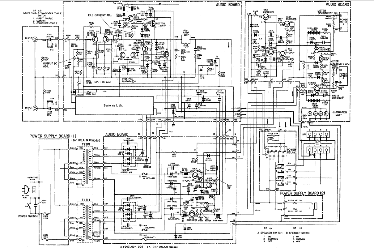

this is a small (very - sorry) schematic of the HMA-7500 mk1 from maybe 1980.
the bigger models add more embellishments, but this one uses almost the databook circuit with regulation of the front.
I'm probably showing my age when I say I saw this back in IEE Transactions In Consumer Electronics back in 1979 and contacted hitachi for some samples. I remember building the databook circuit back in 1979 or so; it was too temptingly simple. By the time I got something I was happy with, it was no longer simple.

Is the amplifier in the link the commercial one? If not, do you have a schematic of the commercial one?

... because by then I had seen the hafler DH-200 schematic and got that working better

Thanks for that schematic. Don't worry about your age - it is just a number!
I'm showing my age when I say I built a Citation 12 clone in 1971.
Bob
