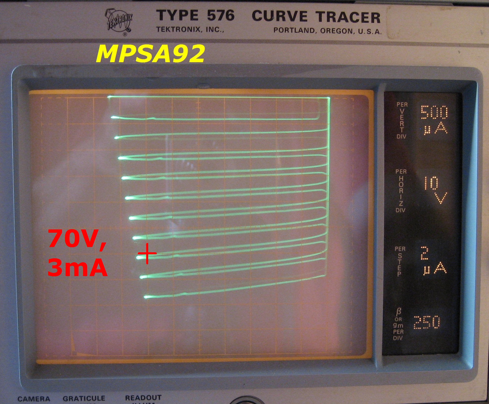

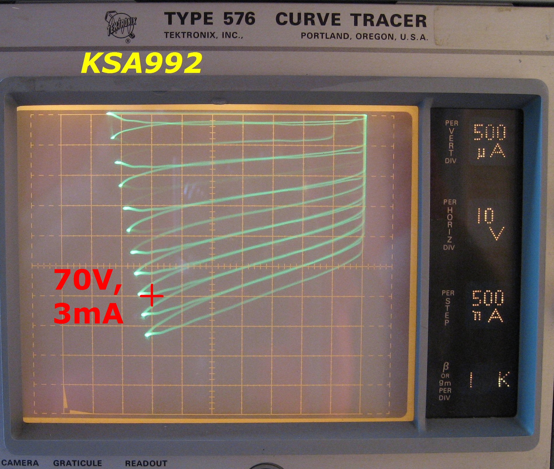

I popped an MPSA92 (rated 300V) and a KSA992 (rated 120V) into the curve tracer and took a look. Regrettably, self-heating caused quite a bit of trace looping: 70 volts x 3 mA = 210 milliwatts, in a plastic TO92. The usual fix (set Polaroid camera on infinite exposure, turn off graticule, and use "DC" sweeping) couldn't be applied since I don't own a Polaroid camera! I've got a cheap Canon digital, which I don't know how to set to infinite exposure. Sorry for the loops.
I marked the 3 mA point since that's where each of the IPS devices are biased when the tail current is 6 mA, per D. Self's recommendations (6th ed, p.135)
This KSA992 had a beta of about 700 (Ic=3mA / Ib=4.2uA) while the MPSA92 had a beta of about 200 (Ic=3mA / Ib=15uA).
More significantly, the MPSA92 had outstandingly high output impedance; a/k/a enormous Early voltage. The KSA992's output impedance was disappointingly low; extrapolating the curves suggests a VA of only ~ 100 volts or thereabouts. P. U. pew
Which may suggest using the MPSA92 as a cascode device, and a lower voltage, high beta transistor for the long tailed pair "within the protective envelope of the cascode". Perhaps the BC327, or the 2N4250A, or the 2SA970 would be good choices.

It is true that the input transistors are not at all critical. High beta is good as it reduces voltage offsets and input current distortion. (but you should always drive from a low impedance to prevent the latter being a problem anyway)
Noise is also not critical, in the sense that the amplifier with ordinary transistors (eg MPSA56) is quieter than almost any stage you can put in front of it.
