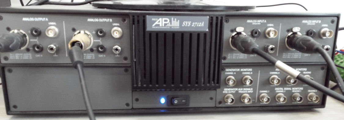

I've personally worked with a chinese SYS27xx copy, it actually took me a while to notice it was not an original:
https://www.audiosciencereview.com/...s-of-sabaj-d5-dac-amp.8337/page-6#post-211348
oh, I saw that old type of fake as well, made by the same company in Dongguan.I've personally worked with a chinese SYS27xx copy, it actually took me a while to notice it was not an original:
I visited them 4 years ago, they sold me some old original SYS2222 or similar, modified to be like SYS2702, $3000. They offered me fake APx525 but I had no interest.
As already noted, you usually see the 192K on the bezel of such equipped units. The other thing you will note is that the bezel is black on the 2700 series, not gray.Not sure what you mean by supported, but all these devices are discontinued https://www.ap.com/analyzers-accessories/discontinued/
Also, this page suggests that AP had two different devices with the same marking:
2722A - Cascade Plus and 2700 series, and they were discontinued at different times.
Does anyone knows how to distinguish one from the other?
