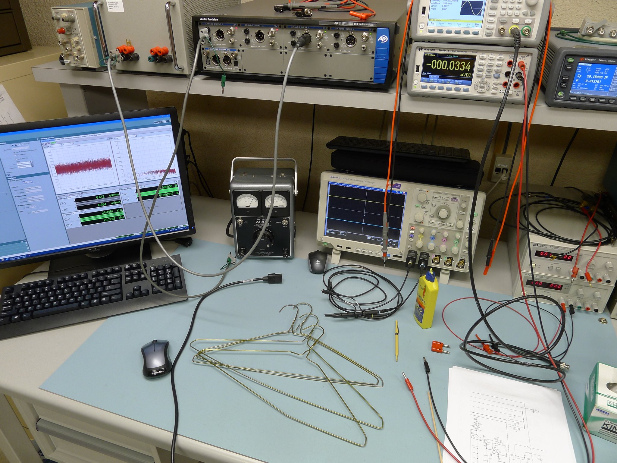

After years of messing around with most every audio measurement device imaginable, I purchased the apx555 as a retirement gift and haven't looked back!

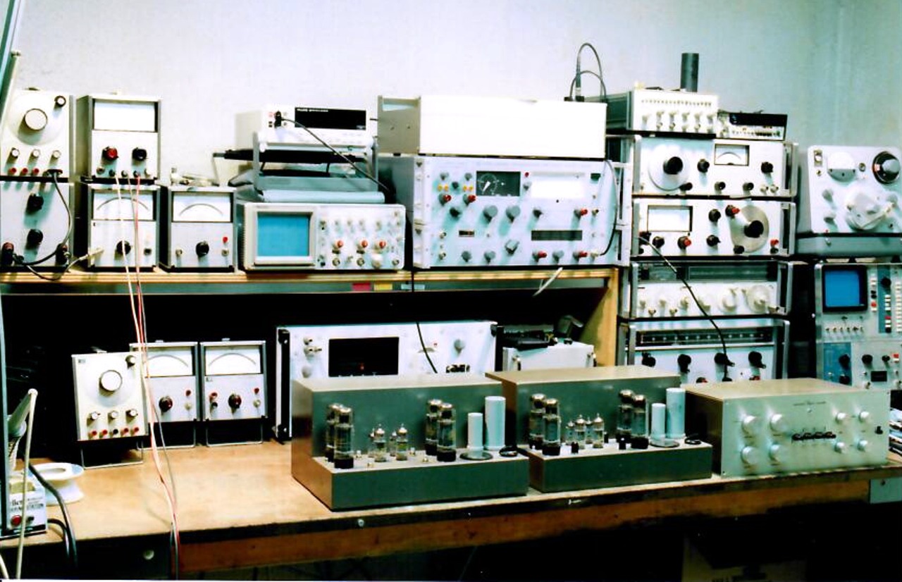

Did keep a loaded System 1, HP8903A, aa501A, and a couple of SG505s. Playing audio for 55+ years gives some perspective.
