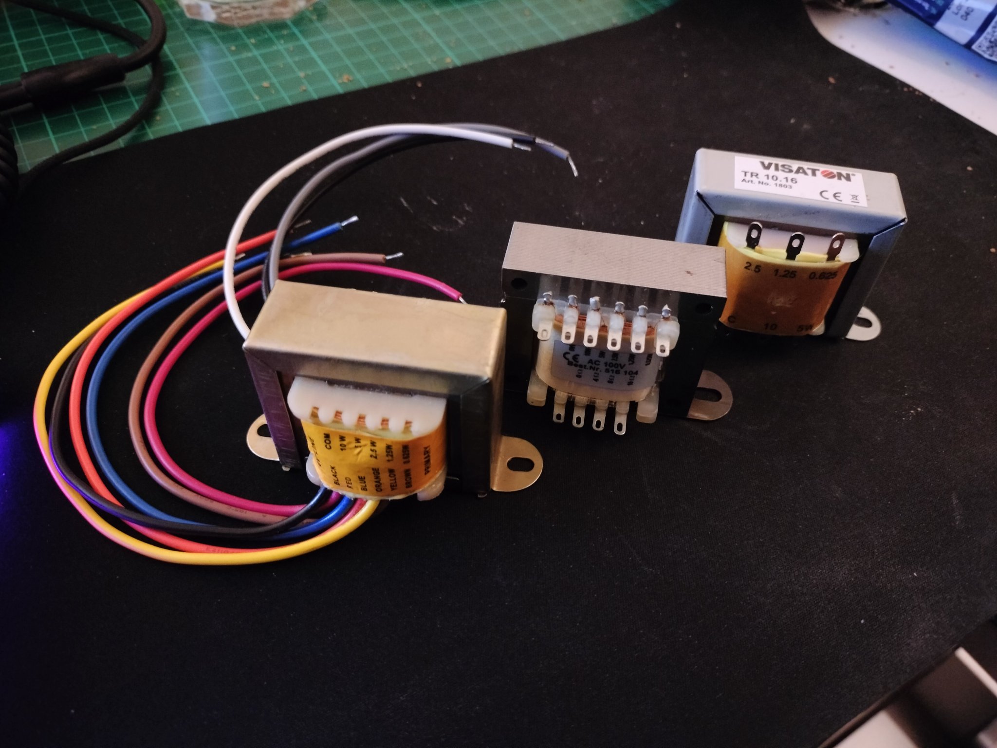

I actually have a couple of exactly those which were shown by the o.p.
And I took some measurements:
primary turns 725 + 300 + 400 + 600 + 900
secondary turns 48 + 18 + 30
when used as p-p the CT would be 75 turns off center, 1425 : 1500, which leaves some 2nd harmonics, amp*turns could be made equal by bias adjustment, if required, or adding 75 turns of additional wire;
reflected pri impedance would be 7.5 k with 8 ohm load on 16 ohm taps
and 15 k with 8 ohm on 8 ohm tap
primary wire is 0.112mm AWG 37, 470 ohm total
secondary wire is 0.4mm AWG 26, 0.9 ohm for the total 16 ohm
primary inductance at 50V / 50 Hz excitation was 56 Hy, not so bad,
66 Hy at 100V / 50 Hz;
at 500 Hz and low excitation around 8 Hy, while leakage inductance at 500 Hz came out rather high about 100mH.
The latter may be the reason why any attempt to use gnfb from the secondary turned into hf oscillation which had to be tamed with a zobel across the primary, limiting hf response significantly.
Interestingly that was not the case when I took the feedback from the primary.

I have actually a bunch of these Conrad Ela 100 transformers.
They perform actually pretty decent, obviously not like the best and lowest distortion etc
I have to check the inductances again, but even those aren't so bad.
I am planning to do a little line audio transformer competition.
But right off the bat these do better than like the Visaton TR10.16.
This has mostly to do with the symmetry of the primary windings.
If I have some time this weekend or so, I can share some more information (I think I already promised that 😄😄)
Although there is no air gap, in practice most transformers can handle a little bit of DC current.
Often with reduced performance.
In this case I wouldn't expect much, definitely not enough for an EL84.

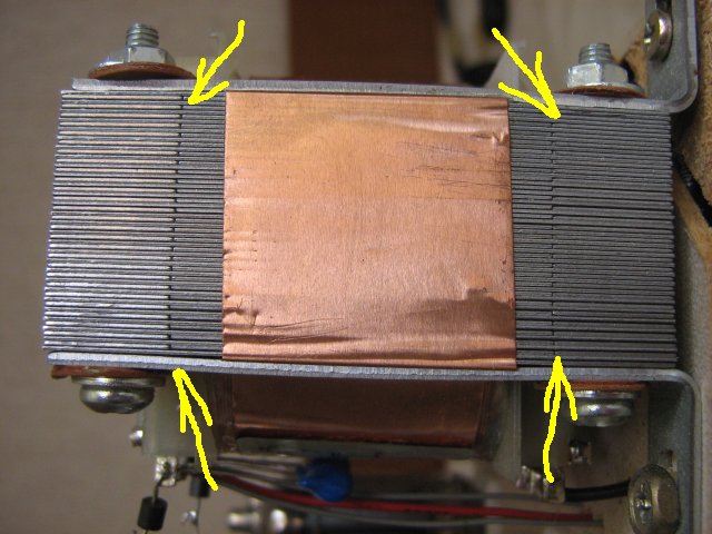

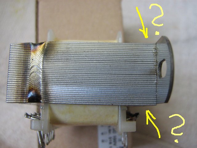

1. Post #1 transformer does not have any rating for DC current.
It appears that the E's and the I's are Interleaved.
If they were interleaved, I'd expect to see those tell-tale lines where E meets I every other time.
Like in the 2nd picture from a PP transformer.
But not so in the Conrad ... both sides the same, and both welds are on top ...

I am amazed at the Air gapped laminations.
Perhaps it was made for a solid state drive with DC current and with lower primary voltages;
versus higher plate voltages?
Occam's razor says "the simpler explanation is the proper one" 😄
I guess cost is the answer 😎
It is much faster (i.e. "cheaper") to grab a proper height stack (say 20-22 mm) of E lamination out of the box and insert them "all at once" in the already wound plastic bobbin, then grab same height of I lamination, put it in place to complete the magnetic path, press them momentarily with a quick clamp and run an electric welding bead across the joint on each side.
I estimate some 45 seconds per transformer.
While interleaving is slow, might take 2 or more minutes.
In this high volume cutthroat pricing market that is a huge difference.

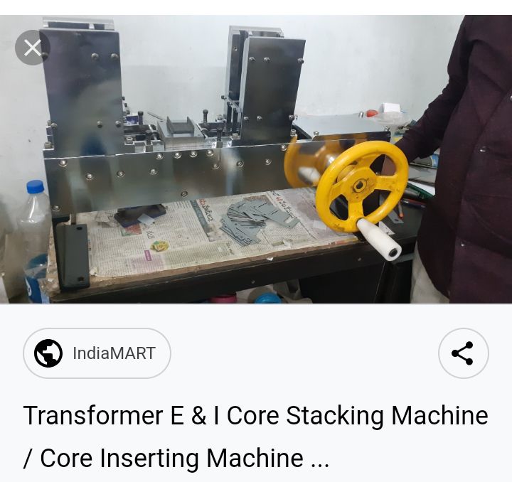

There is a lamination insertion machine, my supplier has one for his "small transformer" manufacturing, but:
* It costs some money and takes significant bench space.
" You must load stacks of E and I lamination in hoppers at both sides.
* It does not fill the bobbin; it inserts, say, 95% of bobbin capacity but then you must insert the last 4 or 5 Es by hand and using s small hammer and then add missing Is.
In practice you need one machine per core size 😱
You can set it up for a different EI size but it involves partial disassembly and reassembly with the new separation, also new hoppers, half a morning job.
You'd better have a 100+ transformer order to justify that.
