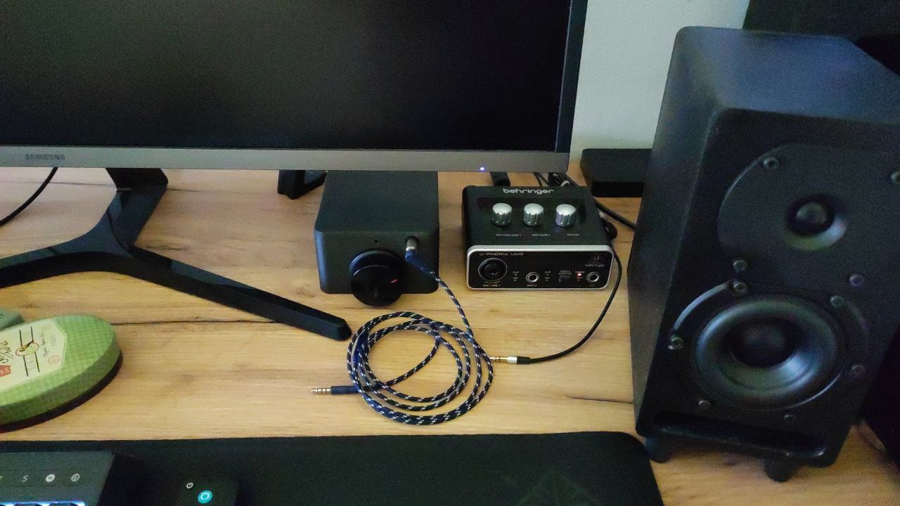

I'm proud to present you my headphones amplifiers family:
The 1st one is a Class AB push-pull driven by an OPA2604AP, with a Gain selector:
The 2nd one is a Class A MosFET:
Then i decided to make 2 expansion boards, a DAC one and a Delay (antipop) one:

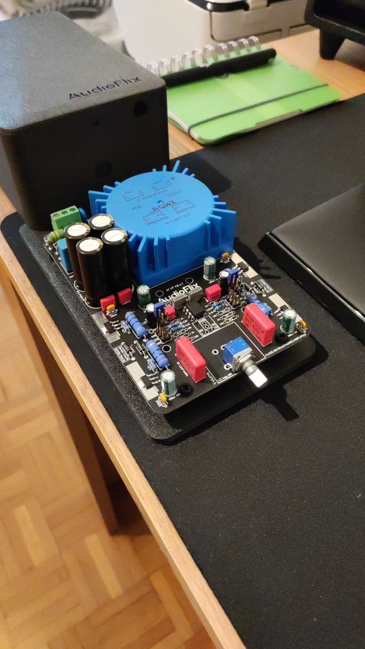

![XRcAdxk.jpg](https://i.imgur.com/XRcAdxk.jpg)
![OOCAw2M.png](https://i.imgur.com/OOCAw2M.png)

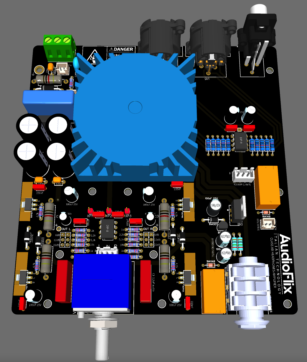

![5fqanek.png](https://i.imgur.com/5fqanek.png)
Have you tested the Class A MosFET variant?
Hi, I haven't tested the MosFET one yet.
The class AB one is tested and completed 😃
I'm assuming R14 in the first schematic should be 10 ohm?
Oh! Sorry, yes of course it's 10 ohm

I like that the class AB amp can take both through-hole and SMD transistors.
What device are you using for the DAC? PCM2704?

I went for a cheap and easy design using a PCM2902
I'm actually tinkering on a good design using I2S interface and a high quality DAC chip.
