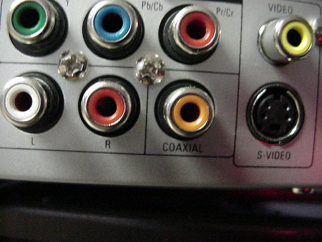

Tried two Emu 0404s and onboard SPDIF with the same effect.
It sounds like clipping, but it is not clipping according to Foobar (the player) or the soundcards control panel, levels stay well below 0db.
Running the volume -6db on the PC sorts it out though and it seems to sound ok.
I don't actually have anything standalone in the house with coax SPDIF. Tomorrow I will get a DVD player or something for testing.
I had a CS8412 + TDA1543 DAC here a few months back and that was fine with default configuration.
Bought a cheap DVD player today with coax out. Playing a CD from it results in the same thing, distortion sounding much like clipping.
I've removed the input driver and bridged 6+8 and 5+7 but the sound is still the same. I've checked and double checked, resoldered the whole board but it is still the same.
The whole thing was put together using a 15w iron and considerable care, this is my 10th or so project with SMD - I am amlost certain I haven't killed something through heat.
It does leave me wondering if one of the chips is faulty but so unlikley!
Any ideas Peter? Do you have any high res pictures of a completed green board? (top down/underneath?)
Thanks😀
nice call. i just wanted to see if you could find the problem i had the same thing with one of my cheap dvd player with the coax out
stay away from diamond visions dvd player from walmart😉
try digital out on a another player my dac works great just not on this dvd player i get the same result that your getting
does your dvd player have digital volume on the remote?
if so turn it all the way down the coax out works with the volume
its not fixed on mine
That ain't good....I'm all over this thing like mad, I can't leave it alone but it could possibly be 'normal'?
Specifically which of your players can run this DAC, with no distortion and no volume alterations?
The player I got is a supermarket own brand, but I have a pair of professional EMU 0404 soundcards, they should not be a problem.
Turning the volume down is not the answer, because you cannot attenuate a digital signal without losing bit depth...no?
