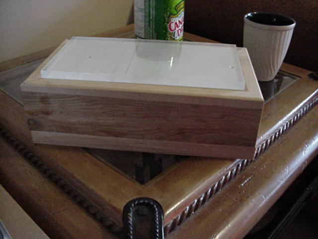

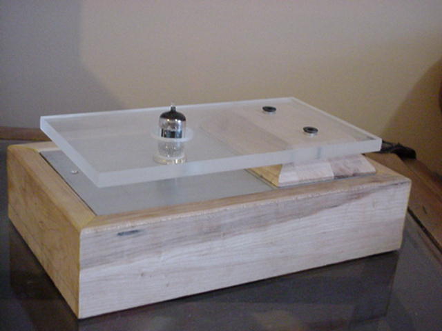

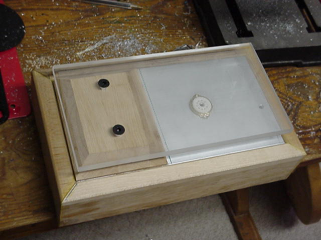

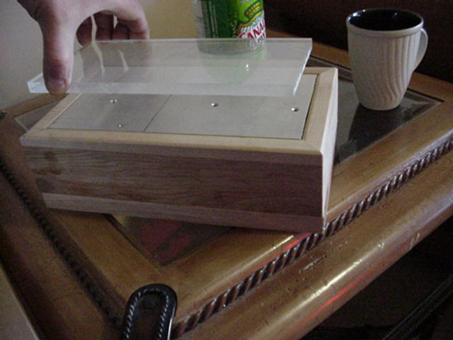

I got a premium kit awhile back and just completed an acrylic casing for it. I tried to hook up some smps units i bought for them. However, i am confused as to how to wire them properly. On the smps side, there is V+ and V-, and on the amp board side there is V-, V+ and PG's. I already blew up a chip so i want to try to be cautious. Any advice?

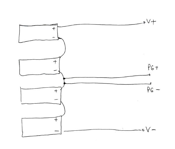

gaborbela said:Peter please let me know how you hock up the power supp before the diodas (bridge)
There is four connection marked AC1, AC1 - AC2 ,AC2. Now the both power is inside on the AC1-AC2 ,and much better than before .
-If I replace the panasonic capacitors to BC it will give audable impruvment or just waste of money???
As I see it, there is no difference between connection to point A1 or A2, we can equally well reverse the diode pairs and marked them opposite. The orientation of wires from transformer should not be critical here.
If you mean BG caps, there should be an improvement, I posted some observations here:
http://www.diyaudio.com/forums/showthread.php?postid=574431#post574431
http://www.diyaudio.com/forums/showthread.php?postid=581230#post581230
angchuck said:I got a premium kit awhile back and just completed an acrylic casing for it. I tried to hook up some smps units i bought for them. However, i am confused as to how to wire them properly. On the smps side, there is V+ and V-, and on the amp board side there is V-, V+ and PG's. I already blew up a chip so i want to try to be cautious. Any advice?
The PS connection diagram is here: http://www.audiosector.com/lm4780 psu.pdf connection to the amp is presented here: http://www.audiosector.com/lm4780 amp.pdf ( it is the same principle for LM3975 kit)
