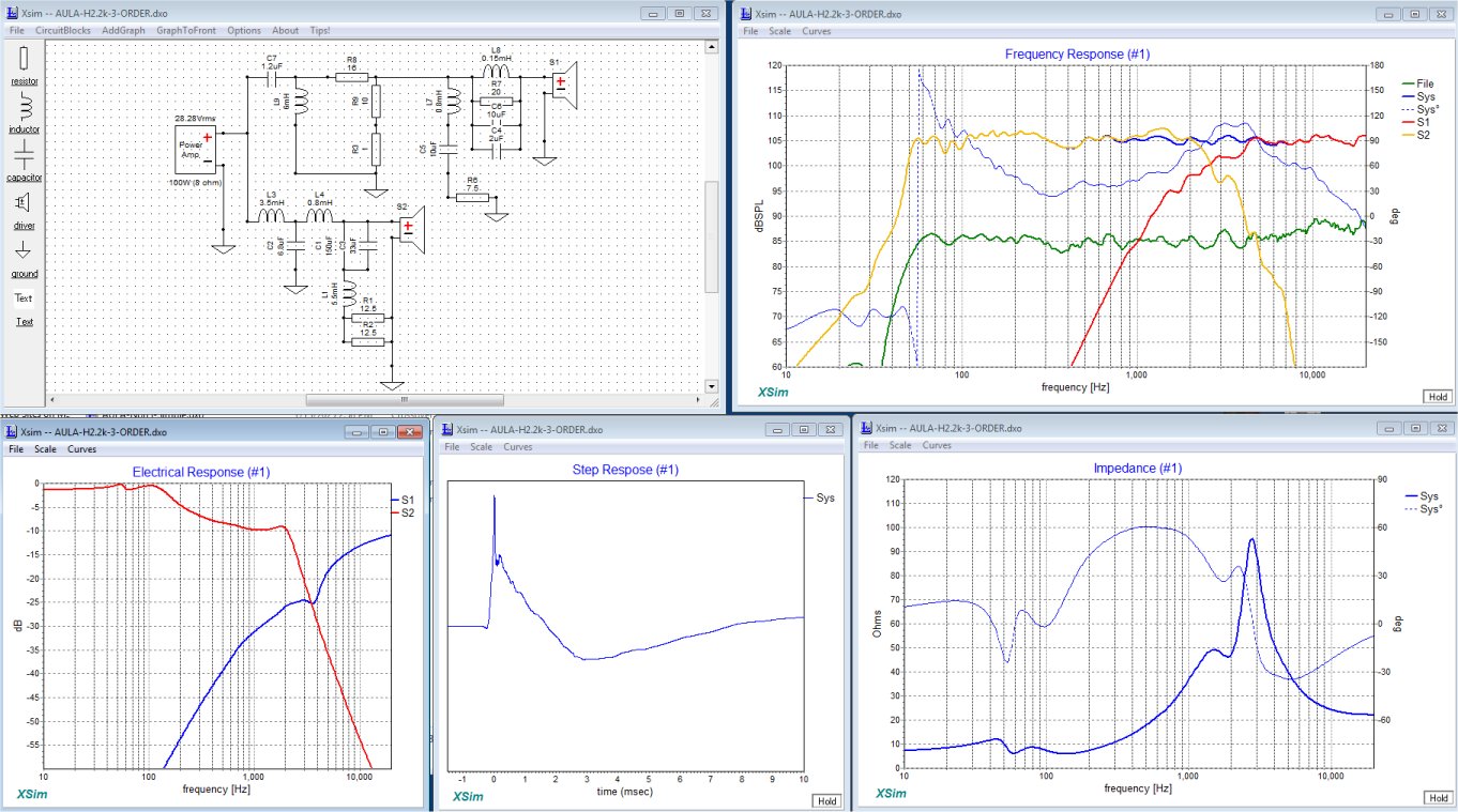

I've been fiddling with the XO sim to get something I like.... here's where I'm at.
Initial idea was to have the cross at 2k, but in the course if trying to make it work I have floated up from there. So I think my offset is actually a little too much, and my phase peak is a bit larger than it might have been.
If you go for this sort of XO, it is (quoted from XRK's thread)...
1. Set the low pass filter for the woofer as a 4th order Butterworth at central frequency, fc for the XO centerpoint.
2. Set the high pass filter for the tweeter as a 2nd order Bessel at fc.
3. Set the delay of the tweeter equal to 1/2 of the period of one cycle at fc.
4. Use all positive phase on woofer and tweeter.
Here's what I've learned: 2nd order -acoustic- roll off is pretty slow! 2nd order electrical is normally fine, but when you are looking at the acoustic rolloff that happens naturally that doesn't leave much space to put in electrical protection. So I ended up at higher F than I was initially targeting. It looks like 2nd order electrical on the CD but it's pretty low Q, that inductor is only helping out at lower frequencies. Impedance compensation on the CD can help you get the shape theory wants.
I think I've attached the XSIM file in case anyone wants to play along.

Here's the XO as ordered, with available part values.

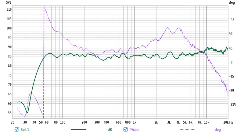

The green FR trace above is the validation measurement. Looks like I'm getting a little rise at 10k. Are my tweeter LPAD resistors a little out of spec? Or am I just poor at getting my tweeter axis pointed at my mic from 2m away? It was a bit windy as I was measuring, maybe just wind noise?
In REW with phase...

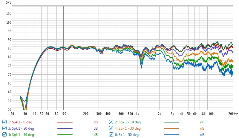

I did a horizontal off axis set of measurements. They came up a little odd...
These are done as ground planes, with the speaker tilted down to point at the mic. This makes it a little tricky to rotate them for off-axis measurements. The vertical axis of the speaker about which you'd need to rotate is no longer just vertical, it has the tilt to point the tweeter at the mic. So you can't just twist it on the ground. So I propped up a ramp to put the speaker on, so I could point it at the mic and then twist it on that axis. But you can't just have the speaker at the end of the ramp. When you twist it, one side moves back and the other side moves forward. So it has to be back from the end of the ramp so that you have some space for the corner to move forward into.
So these measurements have a little unusual shape around 1k Hz. I think this is due to the discontinuity in front of the speaker at the end of the ramp.
So I think that's not real. But you can see the drop as you move off axis, there doesn't seem to be anything crazy going on. (this one, not so much extra 10k)

I also think that it is a lot of components! The Harsch concept has target shapes I had to beat the response into. Conceptually it' not super crazy... woofer is 3rd order with a notch (baffle step functions are spread across the LP and the notch), tweeter is low Q 2nd order, with an L pad and a notch, and some impedance compensation to keep the HP shape matched to theory. A few components double up to get the values I wanted. Perhaps not the most simple / economical, but I wanted to try the Harsch thing out, it sounded like a cool idea.

I’d leave well enough alone as the response above 10k is fairly consistent
This is my thinking also, though I may do more measurements to try to get to the bottom of it.

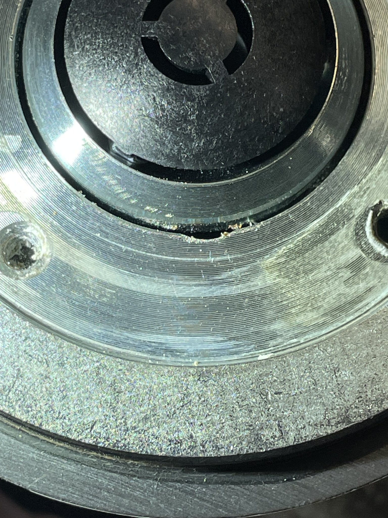

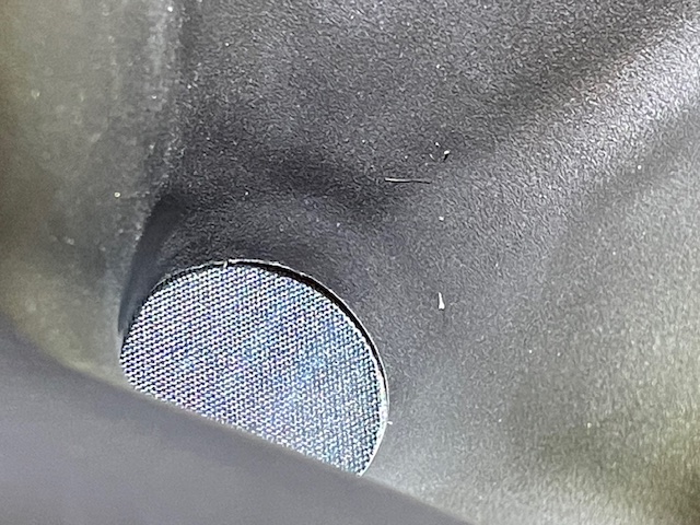

Well, I've been listening to this speaker on and off. And it's been giving me a hard time. It sounds fine, but I can't listen for long. After 10 or 15 min it makes my ears start to ring. I've hooked it up to eq to try to fix, I've pulled the XO and gone to active. But it doesn't really sound like a FR issue to me, that part seems fine-ish. It just hasn't wanted to stop assaulting my ears. I haven't seen a smoking gun in the measurements (tho I see 2nd harmonic THD higher than I'd like with these CDs).
But here's one thing that I've noted: the horn and the CD don't screw all the way together. Here's a pic..
This looks like between 1 and 2 mm of gap to me, the space is too narrow to get my ruler down into. L and R do the same thing, the horn screws on to the CD, and then starts getting tight and I can't get it to screw to a nice flush point. I've got a Dayton waveguide on a different CD (with a metal threaded insert, this horn is molded plastic all the way), and the two screw together reasonably loose until they come to a positive stop, but this combo gets progressively tighter and comes to a stop. I've swapped the parts around, the HM17-25 is the issue.
I understand the CD to horn transition to be pretty important in horn performance. Could this be causing the unpleasant effect I've noticed?
I saw this thread: https://www.diyaudio.com/community/threads/selenium-hm17-25.156439/
And it looks like @Pano maybe had the same issue screwing it down all the way, but folks in that thread seemed to think things were basically alright with the thing. Perhaps I'll have to think about filling the gap (how will I do that...) but I do sort of wonder if I'm even on the right track.
